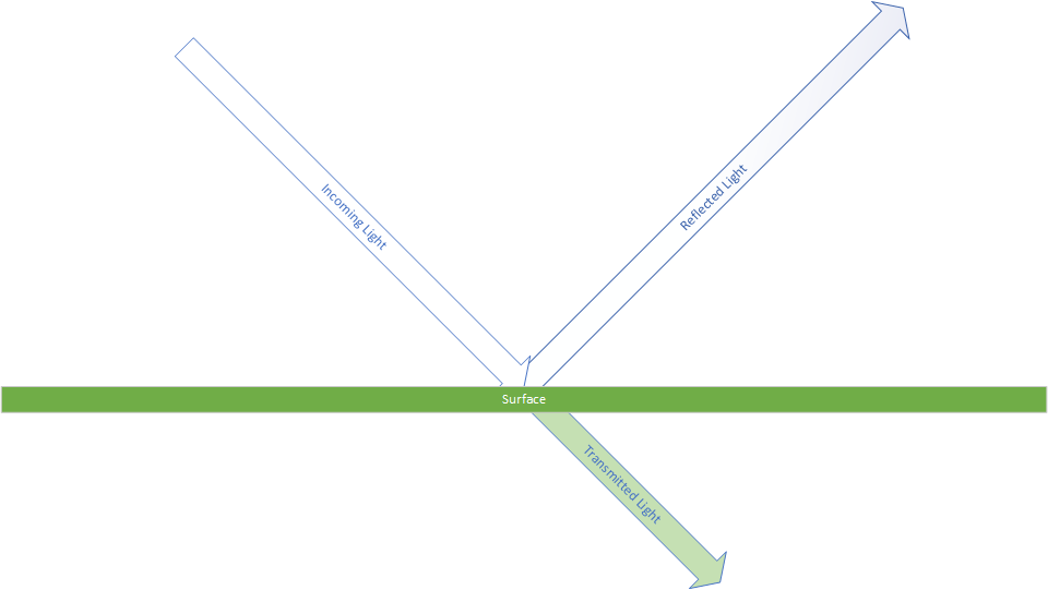

    I'll give it a shot. :)
    Transmission
    Let's start with Transmission because it's easier. Whenever light strikes an object, it can do one of three things. It can be absorbed, it can reflect, or it can be transmitted. Transmission color affects how the light passing through an object will be tinted as it goes through.
    You didn't ask, but transmission depth says how far the light has to go through an object before it changes color. So some materials may only tint the color of the light if the light hits at a low angle and passes through a lot of the material. If the light shines straight on, it might go through without any color change. Think of a piece of glass with only a slight tint to it. If the light goes straight through you may not notice, but tilt the glass at an angle, sending the light through more material, and now you see the color of the glass in the light.
