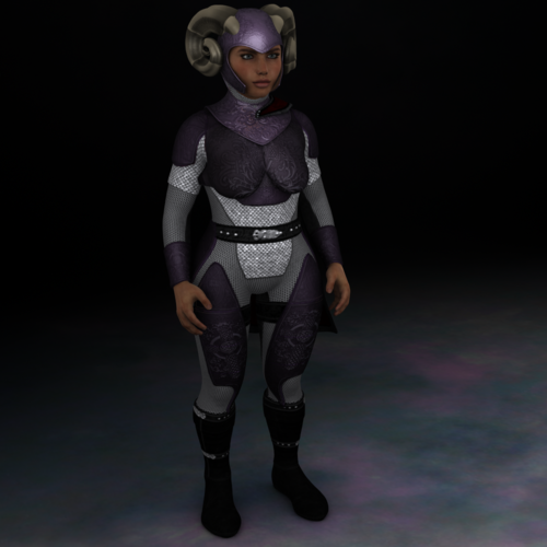

  • SiscaSisca Posts: 875
    I haven't had a ton of time to play with all of the features but I'm already finding this the first light I throw into a scene.
    I've been working on building several characters for a series of renders I need to do and for a quick proof render I've just been loading up the paper roll from PhotoStudio and tossing in one of these positioned above and about 45 deg off the front of the character. It's not great by any means but for something that takes 2 seconds to setup I'm very happy with the results. Especially when it renders in just a couple of minutes even with SSS shaders all over the place.

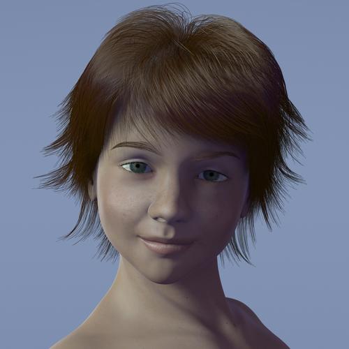

  • GoneGone Posts: 833
    Loving the light! The speed increase on Garibaldi hair is incredible.
    However, I have now hit a snag and don't know how to deal with it. :(
    I'm using Dimension Theory's EYEris shader and, when I use the Advanced Ambient Light, it triggers a specular flare from the render camera position. This is the only light that causes this to happen.
    I've tried filtering the eyes without any success. The only way I can stop the flare is to turn off specular in the EYEris shader. Of course, that means I get no specular from any source!
    Any thoughts on how to get these two to play together nicely would be much appreciated.

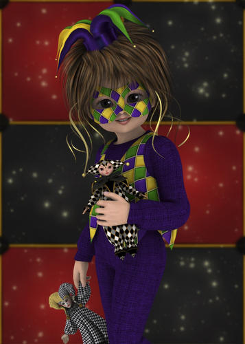

  • StorypilotStorypilot Posts: 1,683
    Here's one I just did, using 3 Ambient Lights and one distant light (as a rim light). I'm including both my final product after post and my raw render.

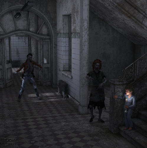

  • TJohnTJohn Posts: 11,352
    edited October 2013
    "Billy's Nightmare"
    A little touch of Halloween. :vampire:
    2 Advanced Ambient Lights (1 in the front room, and one behind the doors), 1 Distant light for moonlight through the windows, and one Point light for the candle. No postwork except for the sig. Quality settings cranked up way too high but I wanted to max out the test. Approximately 24 hour render.
    I recommend viewing at full size, there's a lot of detail. :)
    Creepy one tjohn!

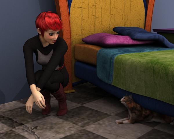

  • KharmaKharma Posts: 3,214
    So I made some changes, added a spotlight as Sickleyield recommended diffuse only at 14.5% and spread angle 102 coming across the bed toward the girl, then on the ambient light I upped the AO samples to 256 and AO shading rate to 5. I think her skin and the wall look smoother and I do have more shadows but they seen to come from the bed and not the girl against the wall.
    Any advice, tips etc anyone can add? these are my very first attempt at lights really and can use any and all advice
    Not much advice and tips on this image from me as I love it the way it is. :)
    edited October 2013
    Creepy one tjohn!
    Thank you! I really like the way this light can illuminate everything believably dark and give you such a contrast with brighter lights like moonlight and candlelight at a believable level.
    I was never happy with the lighting for indoor scenes and always had to rip the roof and unseen walls out of the scene to get them lit. But with Advanced Ambient, it's no longer a problem. Thanks, AoA!

    Hi Gone,
    The light casts a broad specular from the camera position. Though not really physically correct it generally looks pretty good and ads a little extra sense of shape to 3d models. You can disable it though by setting the light to diffuse only in the "Illumination" dropdown menu.

  • SpitSpit Posts: 2,342
    Lovin' it--such a sweet picture. It's definitely smoother (upping the samples and lowering the rate really helped) and I do see a cast shadow behind her towards the bottom. It's faint but shadows from a spot (and distant) get fainter as the strength of the light is reduced.
    Sisca said:
    tjohn said:
    Spyro said:
    I am finding Garibaldi to render somewhat longer then usual, It seems I haven't worked out the right settings in AAL to improve speed with the hair. But, I am finding the hair is rendering much more accurately to it's colour, particularly dark hair. Before advanced ambient light, Uber Environment or 6 point directional light set up would often make dark hair appear ridiculously lighter and less vibrant then it should be despite everything else in the scene looking exactly as it should.
    There's a flag under Lighting Control specific to Garibaldi hair, but I'm not sure what settings would speed things up.
    You can use the flags to control how the light interacts with specific parts of the scene.
    So if you set the Garibaldi Hair flag then set the "If Surface is Flagged" setting to say Primitive Hitmode with Alt Samples that should speed up the render time of the hair at a cost of some quality.
    I'm not sure how much of a quality hit it would be but it's quick enough to change those settings and experiment.
    I've been playing around with using the Diffuse Strength 99% flag to create a light that simulates the glow from a forge hitting the bricks around the forge and it's working pretty well.
    I do have a feature request for version 2 though - some sort of indicator of the area the light hits and the falloff area would be nice. Trying to get the light to only hit part of a large object is a lot of trial and error.
    Wow! Lots of conversation here.
    First, thanks AoA, that did the trick. I forgot these lights had the illumination drop down. Must be the big "C" - uberenvironment light doesn't do specular. :)
    Spyro, my light setup is basically as already described. One AAL light set with Garibaldi flag to not render. A second light set with Garibaldi flag and render only flagged. The Garibaldi light has 8 AO samples, 128 AO shading rate, and hitmode is "primitive". The hair renders on slightly slower than the skin.
    And now, if EYEris is being used, all AAL lights are set to diffuse and a distant light is used as spec only at around 30 - 50%. Interestingly, this does cause a small but noticeable colour shift.
