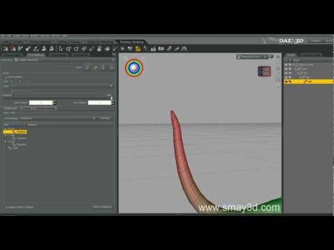

  • You can smooth weights using the Node Weight Map Brush tool.
    • Activate the tool and select the Geometry Selection mode
    • Select the geometry over which you want the weights smoothed.
    • Right  click in the viewport and select Weight Editing-> Smooth Selected.
    • Specify a smoothing factor and a number of iterations in the pop-up dialog and hit Accept.
    Repeat until you get what you want or as close as possible.
  • edited March 2019
    Hey Guys today is Saturday and I have time to try this options out. Hopefully, it works if not lol new helmet for my pilots.
    Post edited by eblgraphics_cbf6f2d73d on
  • Syrus_DanteSyrus_Dante Posts: 983
    Sorry to correct this otherwise good instruction but there is an important step missing about selecting all nodes/bones on that you want the maps to get smoothed.
    • use the Geometry Editor to make a selection of the geometry you want the weights to be smoothed
    • switch to the Node Weight Map Brush tool the geometry selection will still be active
    • go to the Scene pane and select all segments / nodes of the hose of your helmet figure
    Undo last step and repeat Smooth Selected until you get the right smoothing factor that you want or as close as possible.
    Some time ago I made some youtube videos about rigging and stuff that you may find useful
    Here I made a simple example rigging a primitive the video starts at the time I did the weight map smoothing with all segments selected.
    DazStudio Rigging a Cylinder at minute 8
    And there is the GeoGraft headpiece that shows more advanced rigging and using the Figure Setup pane.
