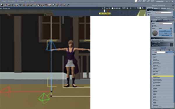

Hi All,
When I load Poser figures into Carrara, most of the time they stick and can't be moved. I'm guessing it's due to IK constraints and I don't know how to free them.

  • DaveYoungDaveYoung Posts: 20
    Nope, One of the figures is a Sydney G2 female. I've selected just the figure, disabled use constraints, use collision detection and lock child objects. I'm using the version 8.0 trial in 32 bit right now so I don't have the genesis available. Any other ideas? Thanks for you help.
    Here are some sections so you can see. I hope it's big enough. I've tried turning everything off and on and the still won't move from that spot. They do be and pose though
    ncamp said:
    Sometimes, figures will come in conformed to another object in the scene. Make sure that the object is not conformed.
    If this is genesis, try making sure actor is selected, not genesis.
    Yep. That was the problem but I didn't know where to look. I just accidentally found it. Thanks for your help.
