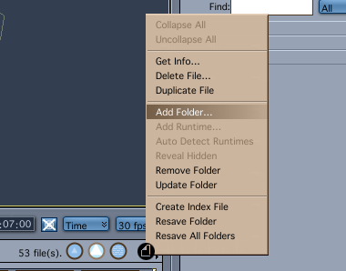

    You can save your Poser figures from Poser scenes you've opened in Carrara by dragging the top of the figure's hierarchy to the objects browser and dropping it onto a directory there.
    You can even create your own folder and add it to the Object Browser for your characters.

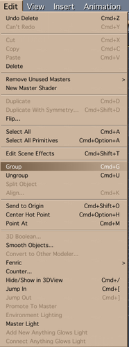

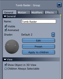

    To save a clothed figure, select the figure and the clothes and group them together by pressing Command D, or going to the Edit menu and selecting group. You can even name the group under the group's general tab. Then drag and drop the top level of the group into you Object browser.
