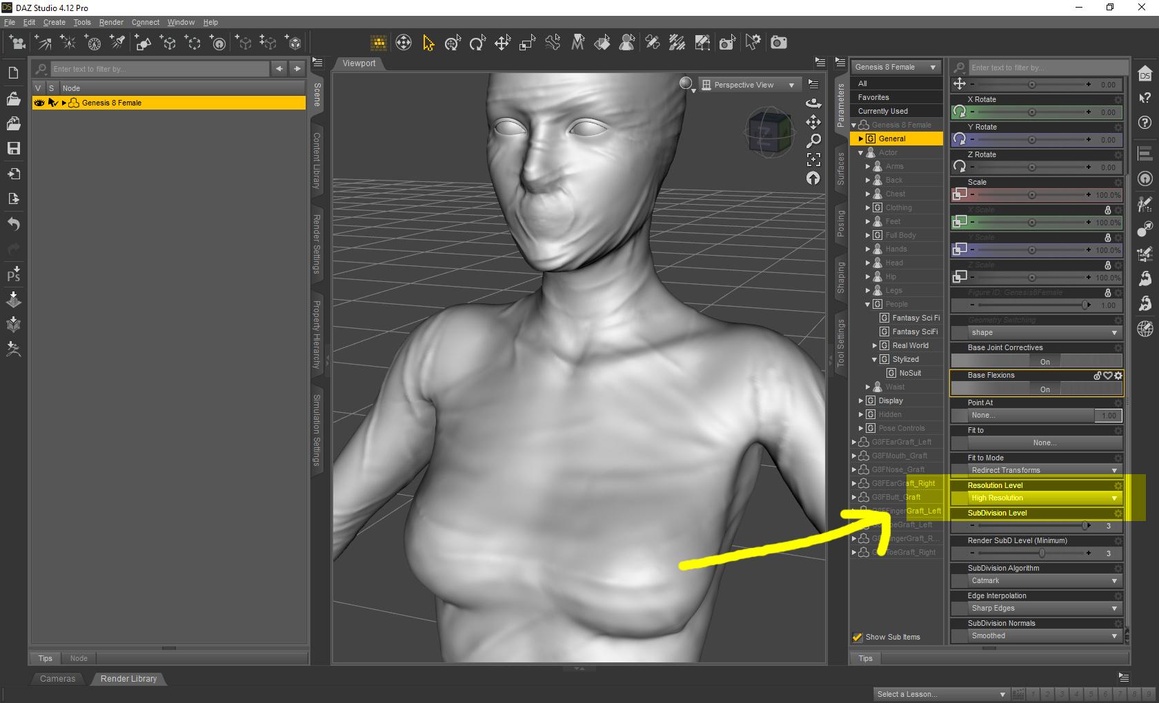

    I'm seeing an issue with the G8F No Suit product that doesn't seem to be a problem with the G8M version. I can add HD morphs to the G8M NoSuit character (such as Vascularity HD) and they're fine, but the same morphs don't show on the G8F NoSuit.
    Make sure the mesh resolution is set to High Resolution, not base

  • mikethe3dguymikethe3dguy Posts: 515
    Of course, Should have checked that, thanks! Odd that the male NoSuit is High Res by default but the female is base.
  • RawArtRawArt Posts: 6,082
    To be honest..I do not know why it loads that way, I know way back when I made it it loaded at High Res  *shrug*
