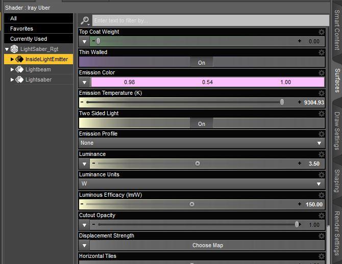

    Hmmm....is it the light saber from Aeon Soul on DA? If so, it does glow when rendered in Iray, see the attached image (I can't help with 3Delight).
    If it is the same light saber, I can get you the settings for Iray later (away from my computer right now). note that you also need to have the Bloom Filter enabled in Iray to get the glow effect around the light emitter (light part of the saber). IIRC there are two materials that you need to adjust, one near the handle, and another for the saber..

    Here they are, hope it helps!
    670 x 518 - 66K
    677 x 599 - 79K

  • Yeah its still not putting the light on the lightsaber itself. I have no idea how to fix this.
