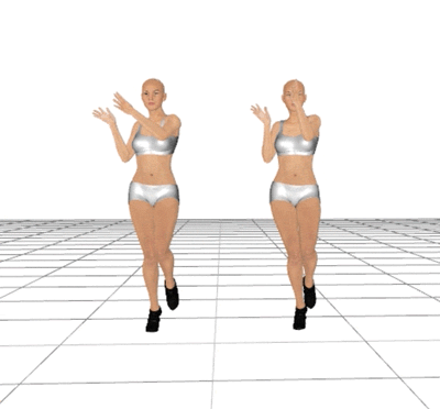

    Did you also make sure your bvh map is applied correctly? When you import a bvh, hit the show details button. Go through each category (e.g. hip matches with hip, etc..) You can uncheckmark things you don't need (eg. if you're not doing facial animation, there is no use applying the facial rig keys, they would just be empty keys and clutter, slowing down the system)
    Do you have "show hidden properties" enabled in the parameters menu ? By default, some channels are locked off. For example, x-rotate for should bend. If your bvh has channels labelled such as x,y,z rotation, the data won't get pasted properly into that node if it's locked. G3,G8 use the "twist" bones - but they don't actually do anything biomechanically, they are only there for weight map purposes. Twist is actually x-rotation of the bone above, but with a name change. If you alter the twist value in the bone above (shoulder bend), it will be copied to the "twist bone" and vice versa. If you unlock x-rotation and set it, say 30 degrees . Load another same model and use twist of 30 degrees. Exactly the same.  It's naming convention that causes the problems . Retargetting software, generic motions, generic BVH, generic FBX's will use a different name (x-rotation) for the channels and that won't get pasted properly unless it's unlocked. It's the same thing with the thigh twist. This is why you get the wobbly arm and leg motion, even though it looked ok in another program; x-rotation keys are missing
    eg. here is a mmd vmd => bvh example .  Left is unlocked + rotation limits off . Right is rotation limits off only
    Post edited by pdr0 on
  • kwanniekwannie Posts: 870
    pdr0,
    Thank You!
        Actully yes, your suggestion did the trick. I have always been in the practice of setting limits off but I never even knew about unlocking nodes. Honestly all that is over my head a bit, lol. So unlocking allows for rotation information to be passed from other software programs that might use different naming conventions for rotations? Since you have obviously worked with VMD conversion, I am also curious about the nessecity of placeing the MMD character FBX into the Tpose instead of keeping the A pose inside of Iclone when creating a non standard character that  the the imotion will be derived from.  I can't seem to retatin the alignment in the arms from the original VMD when I set the MMD character into the Tpose.  For example, in Happy Halloween when the character places hands in front of eyes like she is looking through binoculars, I can't ever get both the hands to like up in front of the eyes. I assume it has to do with changing to T pose.
