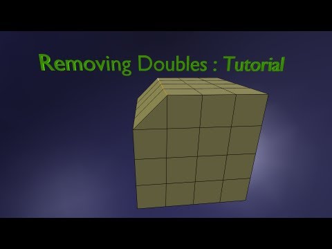

    The terminology in the 3D geometry can differ from real world we call it "welded" or "connected" - for real world clothing you would call it "sewed together".
    The patches that this clothing is made of seems to get ripped appart slightly at the seams if the Daz Studio SubD (subdivision of the geometry mesh) is applied.
    I have no idea if or how you could prevent that with marvelous designer. The clothing could look perfectly fine in the original shape but the geometry mesh seems to consist of various parts that are not connected.
    There are geometry editors like Blender or Hexagon where you can fix this making it a single connected mesh.
    In Hexagon the function is called "Average Weld" I guess and in Blender it is called "Remove Dublicates" in both programs you need to select the geometry first.
    Blender example

    Ok. I removed duplicates in blender (~2k removed) and imported again in DS.
    Used transfer utility with dress knee-length without smoothing modifier and used smoothed brush. There is no edges on map but there almost no changes in clothing.
