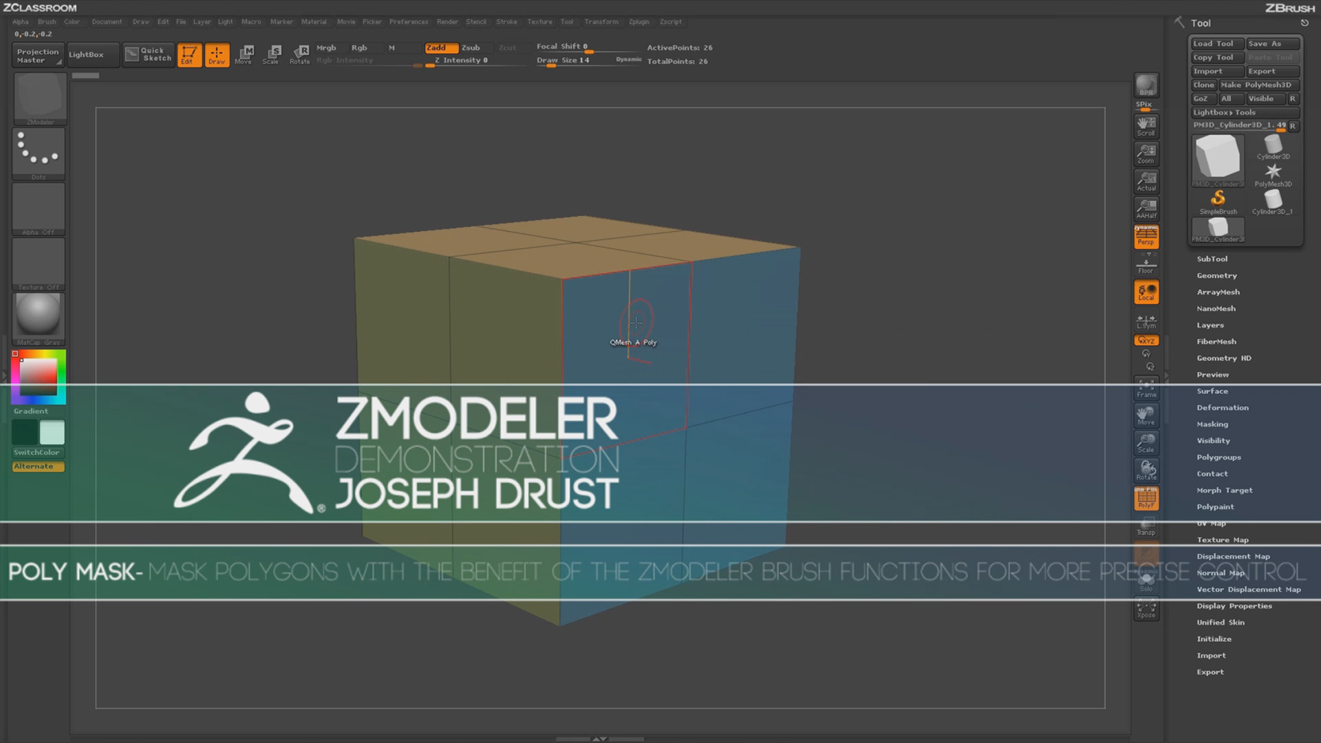

    Pixologic had added the ZModeler brush toolset in 2018 to add some classic mesh editing tools mabye those can help you with such masking tasks.
    http://pixologic.com/zclassroom/workshop/zmodeler-polygon-actions
    ZClassroom Lesson - Poly Mask
    To activate press B for the brush selection menu, then Z to select ZModeler Brush, hover the mouse cursor over a polygon and press the spacebar to get a menu. The menu is context senitive - clould be tricky to select the face instead of an edge or point on smale hair strands. Not shure about how how to mask with the ZModeler maybe there is an option to create a Polygroup from the connected mesh that you can use to mask later.
