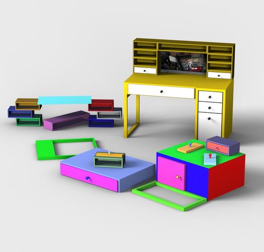

    Here's an image of what I've been working on. As you can see, there are a lot of different/separate parts. (Pic shows one "assembled" and one "separated. Think IKEA type of stuff"
    Is there no way to save all the objects together using the figure/prop asset? or do they all have to be saved individually?

  • TotteTotte Posts: 14,818
    Looks very IKEA to me, looking great!
    But does it come in one big pile of boxes and we have to attach all polygons ourselves ? ;-)
  • Hellish-AbaddonHellish-Abaddon Posts: 0
    No. It comes set up. The idea being (and I'm sure you can see by looking at it) that with just these pieces, you can create..pretty much anything lol A bookshelf, design a different desk, a tv stand etc
    Since they are just boxes, scaling shouldn't be a problem. Everything is also UV mapped if anyone wants to add a texture.
    Before releasing it, I do plan on having "presets" like the desk, a bookshelf and anything else I can come up with. Then, each object can be loaded by itself as a prop for MOAR building!!! ;)
    Pretty much a construction kit...a poor mans construction kit lol

    I agree that looks like a very nice set.
