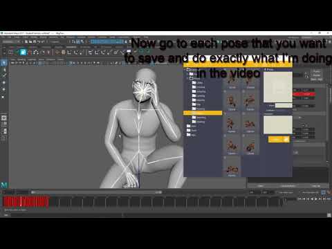

    I'm one of the people who "claim to have managed" to utilize HD characters in Maya, and hope I can clear up some misconceptions. I won't be providing a full step by step workflow in this comment but I can point you in the right direction.
    When it comes to plugins/scripts, in my opinion Genesis 8 for Maya (https://www.daz3d.com/genesis-8-for-maya) is more complete than Daz to Maya (https://www.daz3d.com/daz-to-maya). Daz to Maya does have an option to convert the shaders to other render engines, but considering all the textures aren't exported by Daz Studio as default I prefer to set them up from scratch anyway. You can always save it as a material in Maya to apply to any other import and simply swap the textures, or script it rather easily.
    The "all manner of scripted trickery and nerdy McNerd technobabble" the scripts perform IS using the native Maya tools to emulate the Daz Studio behaviour, but why is that a bad thing? It's simply setting up joints to control JCM's and facial morphs to work in tandem where needed, exactly what Daz Studio is doing internally. By the point that you're exporting a character to Maya for animation you are likely to have made final decisions on their appearance, so losing the ability to completely change the character isn't a big deal. That's not to say it isn't possible though, as the Dex (DSON Exchange) plugin for Maya shows (https://www.daz3d.com/forums/discussion/278111/dex-dson-exchange-plugin-for-maya/p1).
    Poses can be used in Maya
    Clothing and hair can also be used, with different options depending on your desired results:
    • Use the joints and weighting imported from the FBX
    • Set up clothing with a wrap deformer or cvwrap for extra speed (https://github.com/chadmv/cvwrap)
    • Use nCloth to add dynamics to clothing and transmapped hair with much more control and less issues than dForce
    • Convert hair planes to curves with GHM2 (https://thundercloud-studio.com/product/gmh2/) and simulate with nHair for added realisim.
    The issue then is HD morphs, and how to get those out of Daz Studio and into Maya.
    When exporting an FBX file from Daz Studio, you get everything you need including morphs. But Daz only exports at the base resolution mesh. You can override this behaviour by locking the SubDivision Level in the Parameters Pane to whatever resolution you’d like to have in Maya.
    Be careful though, as this can take some time and produce large files because Daz Studio is exporting a HD mesh for each morph target and JCM you select. The weight maps are also broken due to changes in vertex count, but that can be rectified.
    To match Daz SubD in Maya as close as I can I use the following settings:
    Set the Division Levels to be the same as whatever you exported your HD mesh from Daz Studio.
    There may still be very slight differences in vertex position in some areas after applying the smooth. The important thing here is that the UV’s should match the HD version now, which gives a lot of flexibly for transferring data between the meshes.
    A quick tip here is to use Transfer Attributes (Vertex Position: On, Sample Space: UV). This will make your smoothed base mesh match your HD mesh exactly.
    Then, you transfer the skin weights from the rigged base mesh to the HD base mesh and hook up your JCM’s and pJCM’s.
    So that’s the basics of it, although there are a lot of smaller things in between. But the end result is a rigged Daz model in Maya with HD morphs and JCMS, and the ability to use poses, hair, clothing and textures.
    If you don’t care as much about having exact matching HD morphs and JCM’s, you could go the simpler route of simply smoothing and matching the rigged base mesh to a HD export static obj from Daz Studio. Then use seUVBlendshape or similar tools to move the HD mesh based on the UV’s of the smoothed rigged base mesh.
    And finally, I wouldn’t say you need to go above matching the subd1 export from Daz Studio for animation use. It’s a good balance between having enough geometry to allow for smooth weightmaps and bending, but not so heavy that it will be a chore to try and animate.
    You can then bake displacement and normal maps for the rest of the fine detail if needed. This will give you significantly better results than using just a smoothed base mesh default FBX export, even with displacement and normal maps.
    The point is, all of this can be scripted and automated to make the process of going from Daz Studio to Maya pretty seamless. No one has released a complete product yet, but that doesn’t mean it isn’t possible.
    I suppose it’s all about the final result you want to obtain. The MDD or Alembic workflow is a perfectly valid one too, but personally I cannot go from the freedom of animating in Maya to the much more restricted method of animating in Daz Studio.

    Just because it's not a current feature, doesn't mean it isn't possible. Poses are simply preset tranforms of joints. There's no technical reason that can't be translated to HIK. Not that you need to use HIK in the first place; most professional rigs are created using standard joints just like the Daz Studio fbx export. Pose controls are instead implemented as control rigs and set driven keys in Maya. Again, all of that can be scripted to be one click, especially considering the rig and geometry topology is always the same on export.
