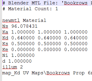

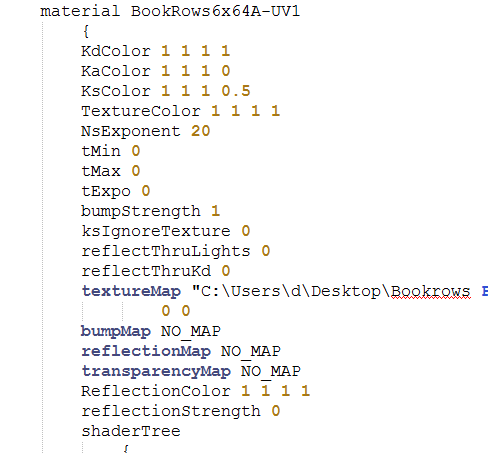

    Just checked - it's 'Ns' in the OBJ and 'NsExponent' in the PP2. My process The way I usually hack things is (1) create mesh in Blender not bothering about materials, (2) export as OBJ, (3) import OBJ into Poser, (4) set Poser materials, (5) save as PP2, (6) load PP2 in DAZ Studio.
    OBJ file - Ns is whatever default value Blender assigned:
    PP2 - NsExponent should be set in accordance with whichever PoserSurface parameter it's related to (Highlight_Size?), and I've set all those up to get 'something that sort-of looks right-ish' in Poser:
    Edit: by the way, Poser 'Highlight_Size' for this prop is 0.05

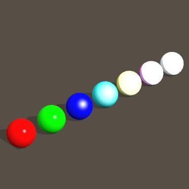

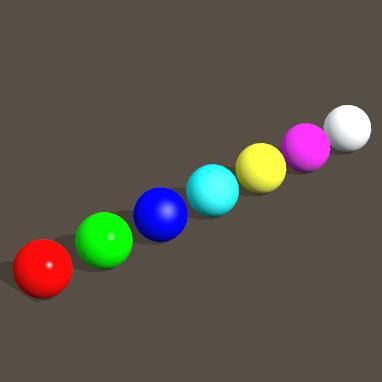

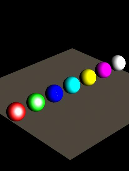

    Now I'm even more puzzled ! I created 7 different Balltest OBJ's (OBJ and MTL files in the attached ZIP, just in case anybody wants to double-check what I've done)  the only differences being the Ns and Kd values (the Kd purely as a visual cue to which Ns setting the OBJ has:
       Ns       Kd
       0.00   White
       0.01   Magenta
       0.1    Yellow
       1.00   Cyan
      10.00   Blue
     100.00   Green
    1000.00   Red
    I imported them all into back into Blender and rendered. This is my baseline. And it seems to match the spec (see earlier post), so it's a good indication of how the specular highlight should look.
    I then imported the seven OBJs into PP2014 and rendered. The red, green and blue ones seem more-or-less okay but the others are whiteouts. As Richard said, the Specular Strength should be decreasing as the specular becomes less focussed.
    Since DS seems to ignore Ns when importing an OBJ (see earlier post), and because the problem I'm really interested in is DS importing Poser files, I saved the Poser scene, imported that into DS4.9beta, and rendered.
    I think I need to go and double-check that the NsExponent and specular strength (the fourth value in the Kd # # # # statement in the PP2/PZ3, as in the earlier example) are as I expect. And also note the DS Glossiness and Specular strength values.

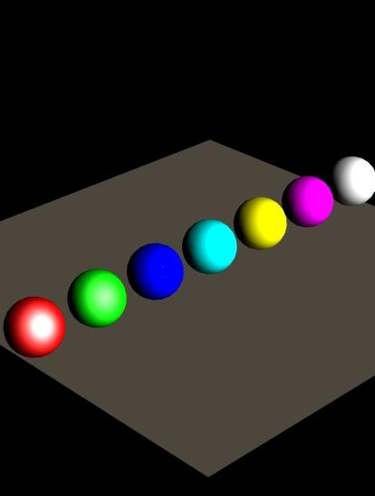

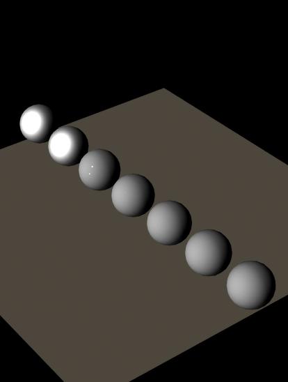

    Here are the actual values read from the files, or read from the Poser/DS UIs:
    Ns in OBJ Kd in OBJ  Poser Highlight_Size     NsExponent in PZ3     DS4.9 Glossiness
       0.00   White           100.0                   0.00                100.0
       0.01   Magenta         100.0                   0.01                100.0
       0.1    Yellow           10.0                   0.10                 99.95
       1.00   Cyan              1.0                   1.00                 99.5
      10.00   Blue              0.1                  10.00                 95.0
     100.00   Green             0.01                100.00                 50.0
    1000.00   Red               0.007813            128.00                 50.0
    (Note: the value highlighted in blue appears to be due to limiting in Poser)
    That bit from the spec regarding Ns again - "...A high exponent results in a tight, concentrated highlight..."
    So the red and green balls (NsExponent values of 128 and 100 respectively in the PZ3, DS 'Glossiness' of 50%) should have the tightest, most concentrated highlights, while the white and magenta balls (NsExponent of 0.00 and 0.01 0 respectively in the PZ3, DS 'Glossiness' of 100%) should have the least focussed highlights.
    To me the highlights on the red and green balls in the DS render do actually look more focussed than the other balls (although nowhere near as focussed as I'd expect from the Blender render). That's why I'm puzzled again.
    Post edited by 3dcheapskate on

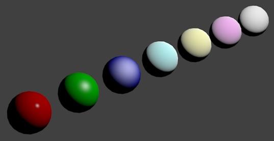

    For a laugh I tried halving the specular strength for each ball (red=1.0, green=0.5, blue=0.25, etc) in Poser and saving that to a new PZ3. Here's that one rendered in both PP2014 and DS4.9
    382 x 382 - 5K
    414 x 548 - 36K
  • 3dcheapskate3dcheapskate Posts: 2,728
    edited November 2018

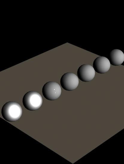

    ...and I also tried reversing the order of the balls in DS4.9:
    414 x 548 - 36K
    Simply importing the first PZ3 with the seven balls (ti.e. the one mentioned in this post) into DS4.9 and changing the Diffuse Colour to mid-grey. The two on the left look near enough identical (no surprise with NsExponents of 128 and 100), the next (NsExponent=10) seems to have a pinpoint highlight, and all the rest seem to be unfocussed in exactly the same way.
    ...and orbiting the camra about 90 degrees:
    414 x 548 - 33K
    414 x 548 - 33K

  • I always thought that DS 3Delight 'Glossiness' seemed to be the wrong way round.. I'd expect Glossiness=100% to be a shiny, polished type surface (which would correspond to a high NsExponent value, and give a tight,concentrated highlight). And I'd expect Glossiness=0% to be a dull, matte type surface (which would correspond to a low NsExponent value, and give a wide, unfocussed highlight - probably no highlight at all).
    But looking at the 5x5 grey balls tests in the previous posts it appears that the tightest,most concentrated highlight occurs around Glossiness=50
    I really can't make head or tail of this...
    Just keep in mind that you are talking about one shader (DS default), which is far from physically accurate or even plausible;) Use your eyes, not math, that's my 2cents. But as I mentioned and you know, glossiness of 100 means an infinite small, therefore almost invisible highlight. One shouldn't really separate specular highlights from raytraced reflections, right?
    Post edited by Sven Dullah on
  • Just keep in mind that you are talking about one shader (DS default), which is far from physically accurate or even plausible;) Use your eyes, not math, that's my 2cents. But as I mentioned and you know, glossiness of 100 means an infinite small, therefore almost invisible highlight. One shouldn't really separate specular highlights from raytraced reflections, right?
    The DS Default shader is the only one I ever really used, and it always seemed 'plausible' enough for me back in those days. But I guess that in these PBR days 'plausible' ain't what it used to be ! laugh
    Lol I've noticed that also;) DS default is pretty robust, you know what you get.
