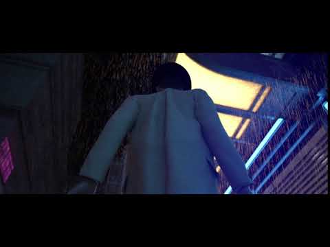

  • Alright, so it looks awesome! I rendered out a lower res version at 486 instead of the 1920x1080 I need for my film, the lower res took about 5 hours to render all 133 frames whereas it took an entire day to render out about 33 frames, so just for our purposes here to show everyone that it can work, I stopped the render and did it lower. So if you're on a 5K monitor, leave the video size small or else it's going to look super pixelated.
    But this was super easy, I was thinking originally of making it way more complicated than I needed to with layers and all. Got to remember KISS lol. The only thing I need to change is the start and end of the rain within my shot. As you'll see, it looks like it's rev'ing up and slowing down at the beginning and end, that can be fixed easily by changing the start and end to about 10 frames before and after the shot. All I did was loaded the rain into the scene, marked that keyframe and then moved to the end of the shot and moved the rain's Y axis down until it was almost at the edge of the rain itself. You'll see if you go too far, that you can see the top and bottom because it's more thicker, so just don't go all the way and you're good! This was 133 frames and it fit the whole animation, but I could have started the Y axis higher in the beginning if I needed more time in the shot.
    If I didn't explain this properly and anyone needs a better explaination, please let me know! I could probably do a tutorial if need be. Thanks for checking it out and thank you, KindredArts for making this awesome item! Maybe snow in the future? :)

  • If you want to animate you should probably consider KeyMate and GraphMate, with which you can set the interpolation type to linear and avoid the revving up and down entirely. I think Casual has a free script to do that too.

    This came out great! I'm glad you figured it out, i probably would never have seen it in motion otherwise. smiley I hope to see more animations in the future.
