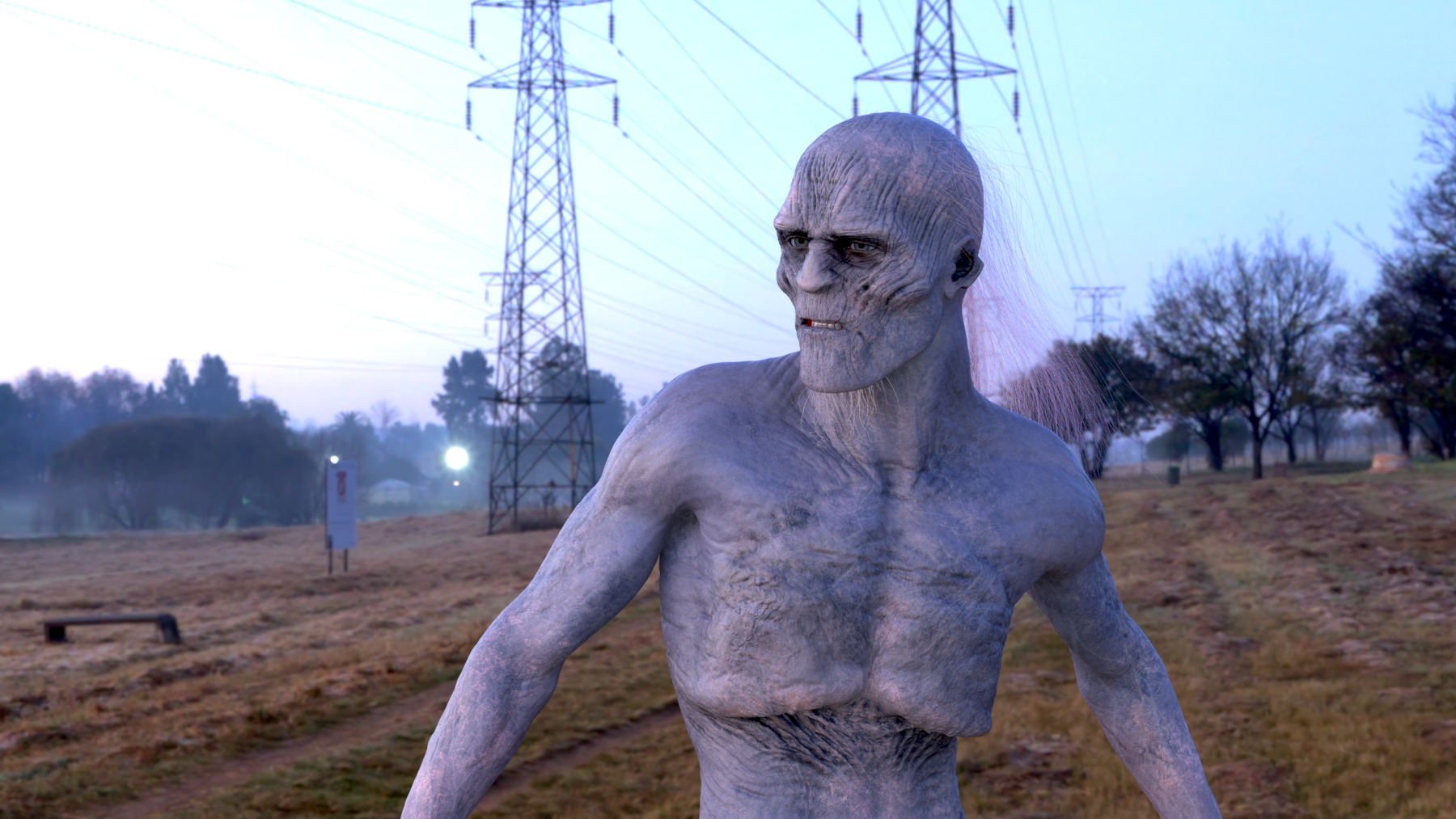

This ugly guy is Walker HD for Genesis1, IIRC this was at subD level 2, I'll do a test render;)

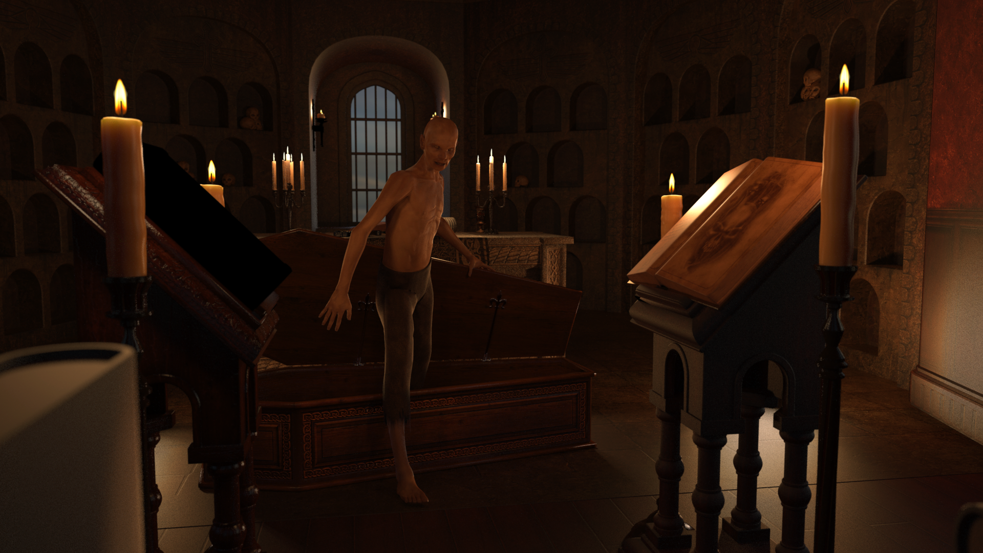

Someone somewhere asked some questions about Grim, you remember him? Nice fella=) Had to (literally) dig him up:)
