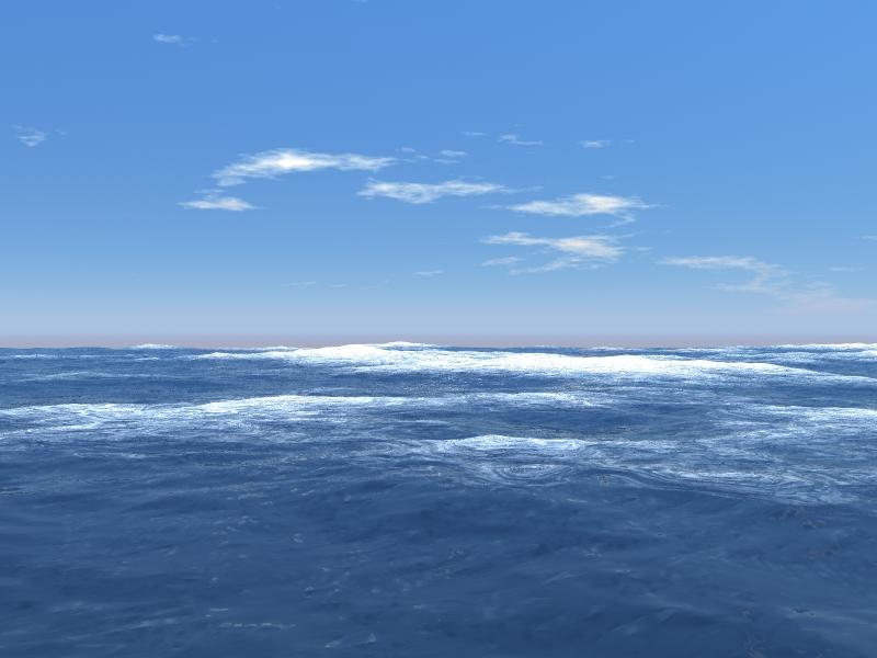

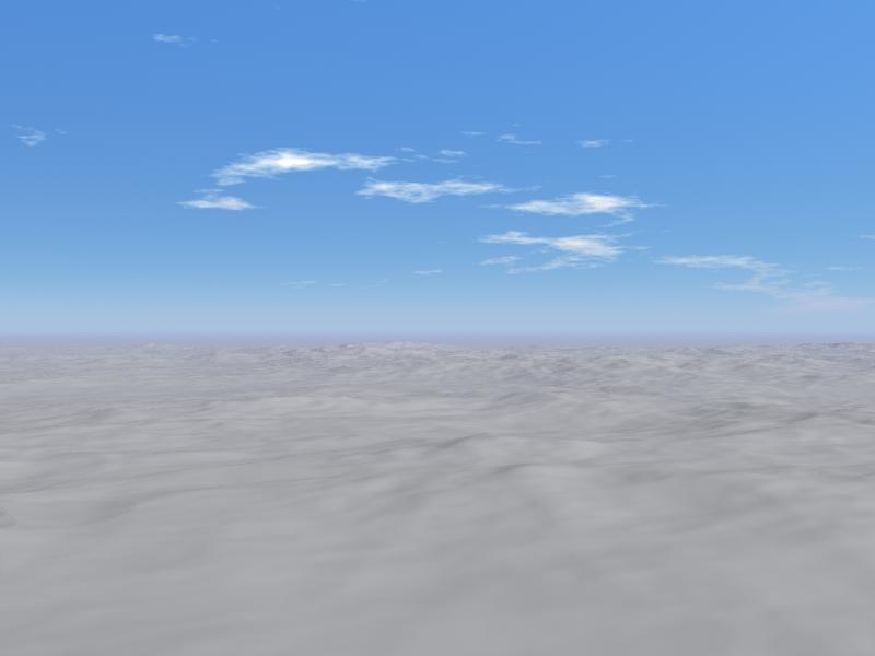

    2. Even better than using the Slab, is to use an actual Terrain. To do this you want to create a large map 4096x4096 using the Round Hills procedural function and then using the Invert option. You should play around with the procedural until you get one with a good amount of bumps on it that when inverted, the depressed edges of the bumps now become the crests of the waves. There is an option to make the Terrain a Solid object, and in this way behaves similarly to a slab. but now you have the added benefit of both the real geometric surface variations as well as whatever bump mapping you apply. The fully 3d surface variations will look really good if you place an object like a boat into the water.
    Excellent results for Terrain gives "Shattered Hills". Here the resolution is 1024.
    Here are two examples of using this technology:
    https://www.daz3d.com/gallery/images/283481
    https://www.daz3d.com/gallery/images/282436
