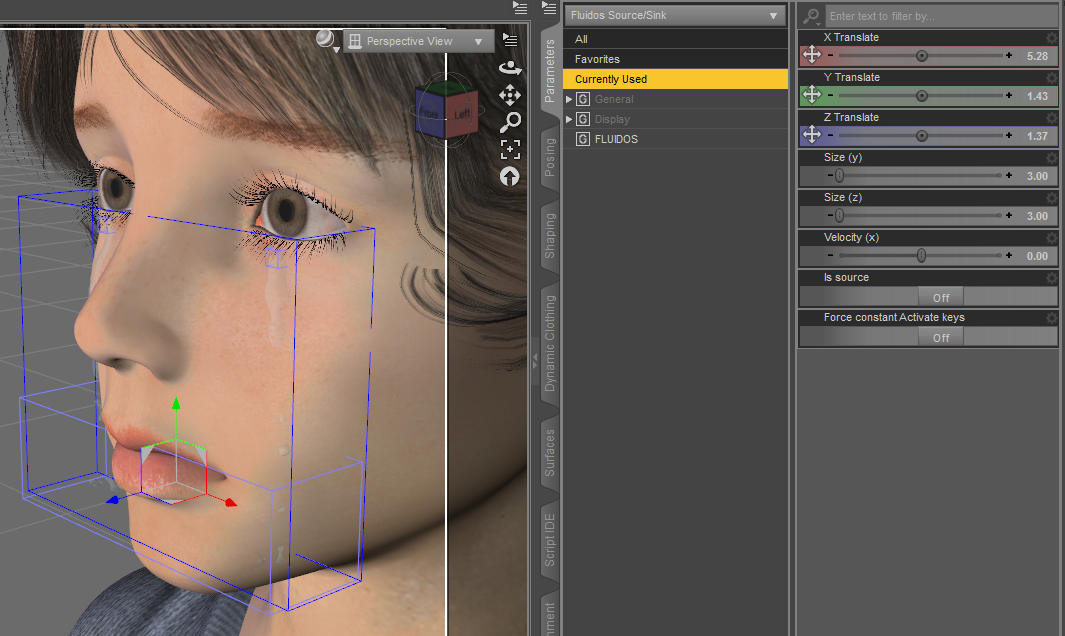

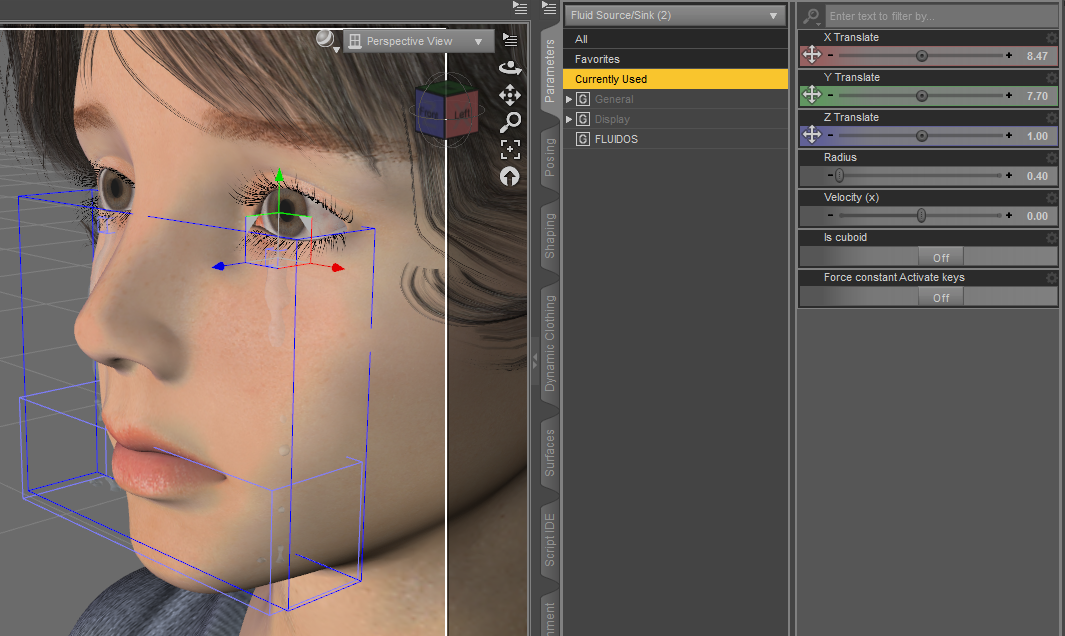

    v1si0n4ry said:

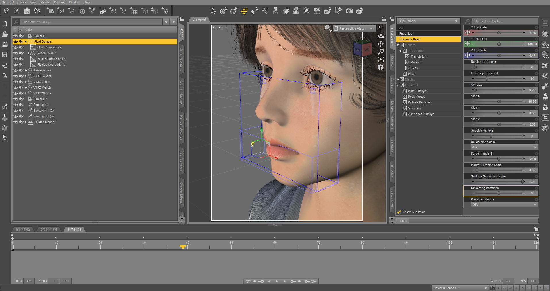

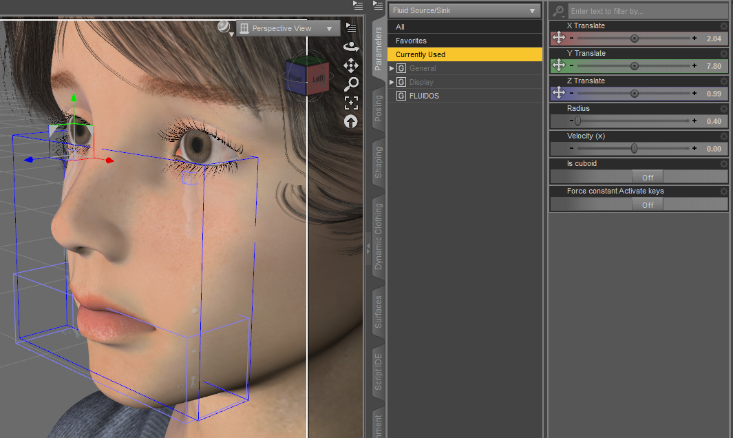

    I just can't make it work with human figures, like tears or water splashing on face.... Shame, I feel like I wasted money
    This is the setup of the tears image:
    There are a FLUIDOS Domain, two Sources and one Sink (to remove water out of the bottom). The Domain is small to get better resolution whitout large simulation times.
    The tears come from spherical sources. No velocity is applied to them, the liquid flows by gravity (a small one). The figure only has to be parented to domain; by default, is managed as obstacle.
    Right tear
    Left tear
    The sink:
    1914 x 1015 - 635K
    1065 x 636 - 498K
    1065 x 636 - 498K
    1065 x 636 - 502K

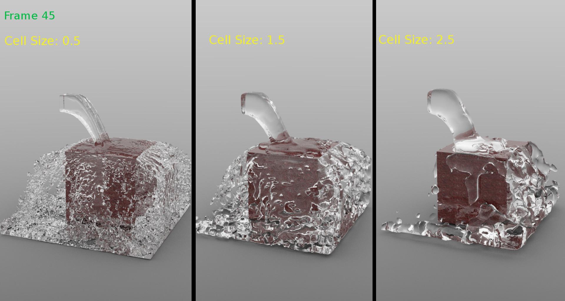

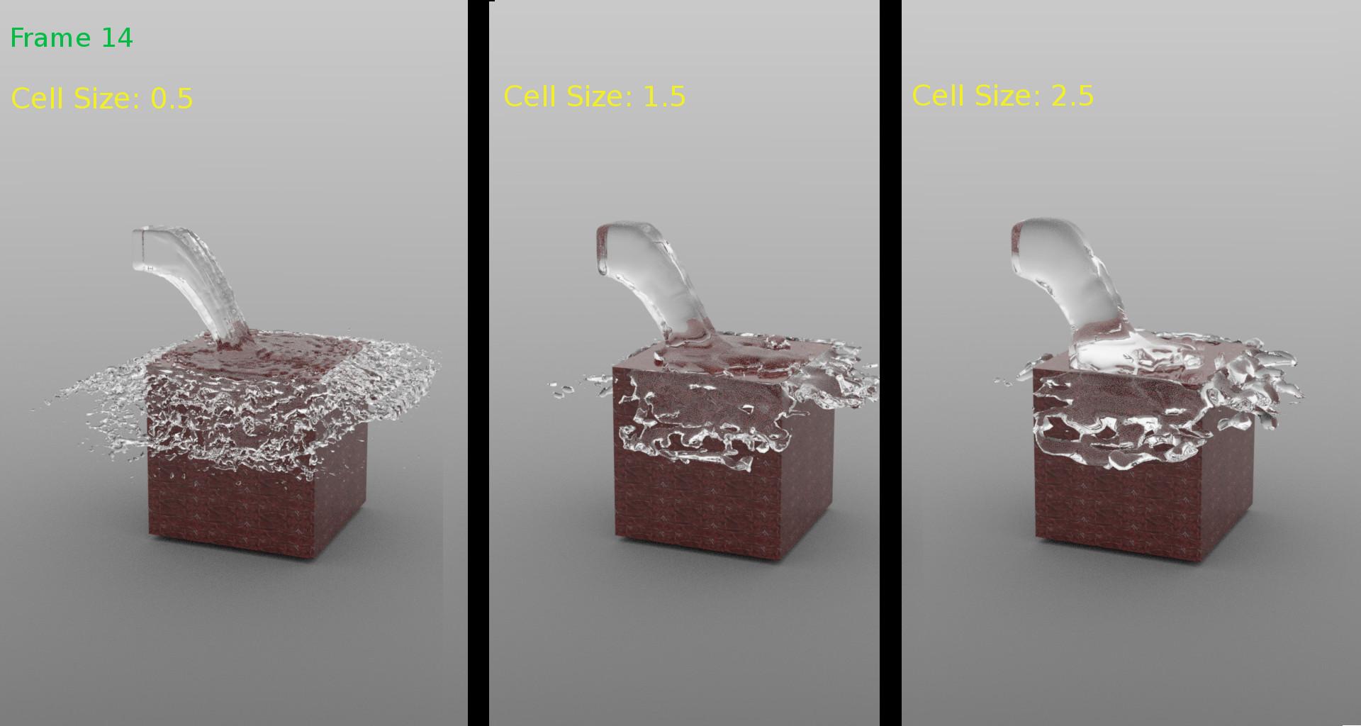

    I have done some testing using different cell sizes, to see how much it varies the look and simulation time.
    As a test I simulated a simple scene with a source of water pouring onto a cube and cascading off the edge. No sink is included, so the water accumulates inside the Fluidos domain.
    I tested 3 sizes. 2.5 (the default Fluidos loads with), 1.5 and 0.5. The simulation times for a 120 frame video were:
    Cell Size 2.5:  43 seconds
    Cell Size 1.5: 4 minutes 26 seconds
    Cell Size: 0.5 5 hours 26 minutes!
    As you can see the time needed for the best quality simulation was pretty heavy. However in my opinion it looks far better, and the only sim where the water looks like water, rather than frozen ice. This was run using GPU mode, but the reality is Fluidos only uses the GPU for a part of the work, and it also only uses 1 thread for the CPU work, so likely as not most people's PC's would get a similar time as me for the same work. The three full videos are attached if anyone wants to watch them. Only 4 seconds, but enough to appreciate how the water flows for each cell size.
    Here are the links to download the videos
    https://www.dropbox.com/s/a8jnrl8rygld1wa/Pour-CellSize0.5.mp4?dl=0
    https://www.dropbox.com/s/va57a7eohhbg3og/Pour-CellSize1.5.mp4?dl=0
    https://www.dropbox.com/s/ak9e0uz2lc1mljb/Pour-CellSize2.5.mp4?dl=0
    It could be beneficial to enable Diffuse particles in Domain Properties (and to add another Mesher with diffuse particles enabled).

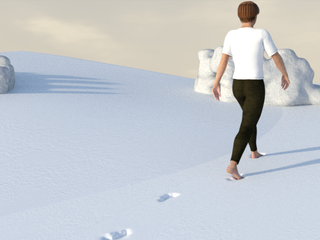

    Paradigm said:
    1. Is the intent that the Velocity is an initial speed coming from the source and the domain forces are gravity and the like? I'm trying to figure out how to create a fountain stream and I think that's how it would work.
    Yes,  but you can change the velocities and the forces values. The values could be zero or negative either. For a fountain you need to set the source Velocity (y) to a positive value, maybe 300 or more. In fact, there is a Fountain recipe in Fluidos documentation (it's in ReadMe's folder, "54155_fluidos-recipes-guide.pdf") or here: http://docs.daz3d.com/doku.php/public/read_me/index/54155/start
    Paradigm said:
    • Is there a way to get the fluid cells to cling together a little more? I tried briefly to make a really viscous liquid and ended up kind of getting something like a machine gun of melty tapioca balls lol
    Increase more the viscosity. The scene of the figure walking on snow uses 500,000 as viscosity value for simulation.
    See here the video:
    In next image you see the snow after the figure walked.
    In the same documentation above there is an example of honey too.
