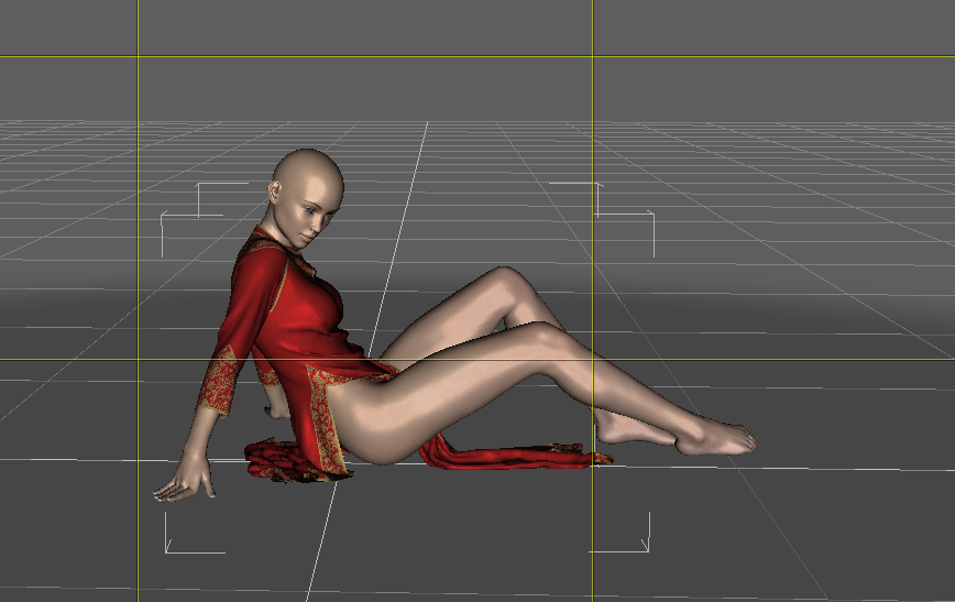

  • Which pose was it it?
  • fastbike1fastbike1 Posts: 4,081
    edited August 2018
    It seems to be working for me, once I looked carefully at some "blown up" poses.
    My 2 observations: 1) The outfit seems to be very particular about intersecting body parts. I know this is a general dForce issue, but seemed to be more significant w/ Eastern Elegance. I have include two examples that blew up until I was careful to examine the pose from all angles and make edits to separate body parts by a fair bit. Now that I have working simulations, I'll try to narrow the gaps to find a minimum separation.
    2) I feel (not enough data for firm conclusion) that the outfit works best simulating from current frame rather than the timeline.
    868 x 547 - 179K
    603 x 745 - 198K
