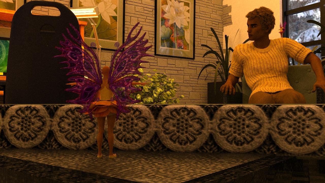

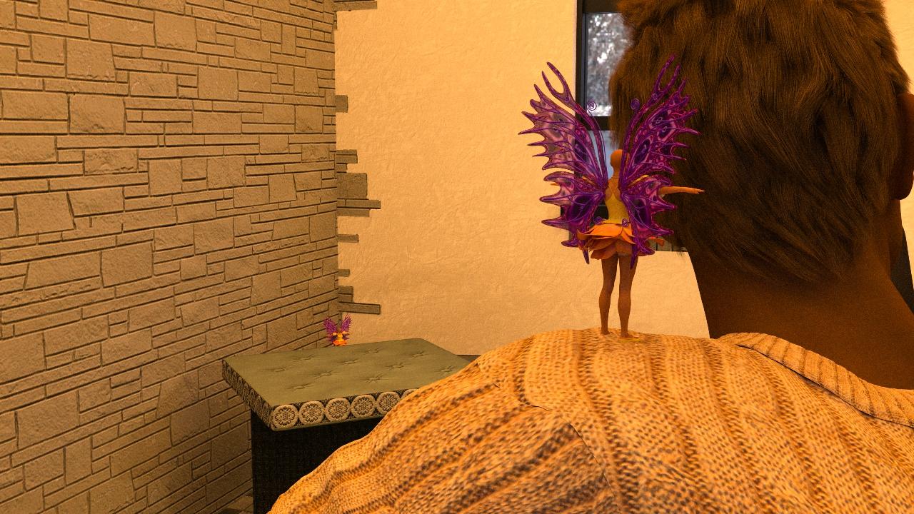

  • FishtalesFishtales Posts: 6,218
    edited October 2017
    Late with these I know, had Studio problems. Running the Beta in the background with a render, while doing this on the full version, and it crashed, after four hours rendering :)
    Anyway, I loaded up an old scene and added some faeries.
    Lighting is a Plane for the ceiling, The original set only had two walls so I had duplicated them and swung them around to form a box and added a plane for the ceiling. I made it Emissive at temperature 2750; Luminance 1.50 cd/cm^2. The reading lamp is also an Emissive set at Colour 1.00:047:0.12; Temperature at 10000; Luminance at 1000.00 cd/cm^2. There is a snow scene HDRI in the Dome set at 0.5 and Tone Mapping is Shutter Speed 60; F/stop 8; Film ISO 300.
    The Faeries is a Genesis 3 Female and one instance scaled to 5.5%. Going by her height on his shoulder that looks around 3 to 4 inches :)
    2017-10-15 19:53:02.507 Total Rendering Time: 2 hours 42 minutes 41.85 seconds
    Stopped.
    Click on image for full size.
    2017-10-15 22:07:35.990 Total Rendering Time: 1 hours 55 minutes 41.95 seconds
    Stopped
    1280 x 720 - 969K
    1280 x 720 - 963K
    Post edited by Fishtales on
