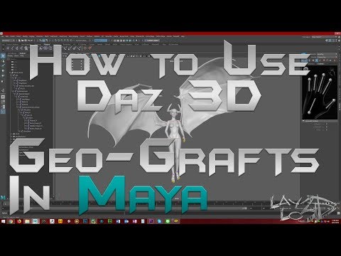

    Yes, you just select the geneitalia and hit CTRL+H to hide it and you'll see that there's another one welded to the figure underneath.
    tiamat said:
    In fact, after testing it seems the original genitals is properly connect to genesis 8. But there're no morph exported for it in the shape editor for maya. why ? moreover, some génitals add-on like the diktator find in renderotica' store is not well rigged even if it's a geo-grafted props.
    Does you're plug-in is able to export the genital's morph ? and what's about the renderotica's add-on such as dikatator and so on for genesis 8 female .
    Thanks in advance
    The reason there are no JCMs or morphs for it is because you can't export them out the same way they can be exported out with figures. You would have to export them out each one at a time and create blendshapes for them inside Maya manually. I spoke with Daz and confirmed this.
    The male genitalia works the same way, just hide the extra separate mesh for it and it will reveal the one that's welded to the figure. From what I can tell, all the bones for it still function properly, you just have to find them under the "pevlis" bone. This leads me to believe that genitalia from other sites, with or without bones, should also work the same way and function properly, minus the morphs. Which, like I said, the morphs could be brought into the Maya scene and added manually if you desie, but unfortunately there's not a straight forward way for me to automate this process via scripting.
    I hope that answers your question. I also added a pic that shows the separate female genitalia mesh hidden in the outliner to illustrate what I was talking about. I don't think I can show the actually genitalia and how it's welded to the thighs without violating the TOS of this forumn.
    Also, here's a video I created talking more about using geo-grafts inside Maya. You may find it helpful.
    Again, I hope this helps, best regards!
