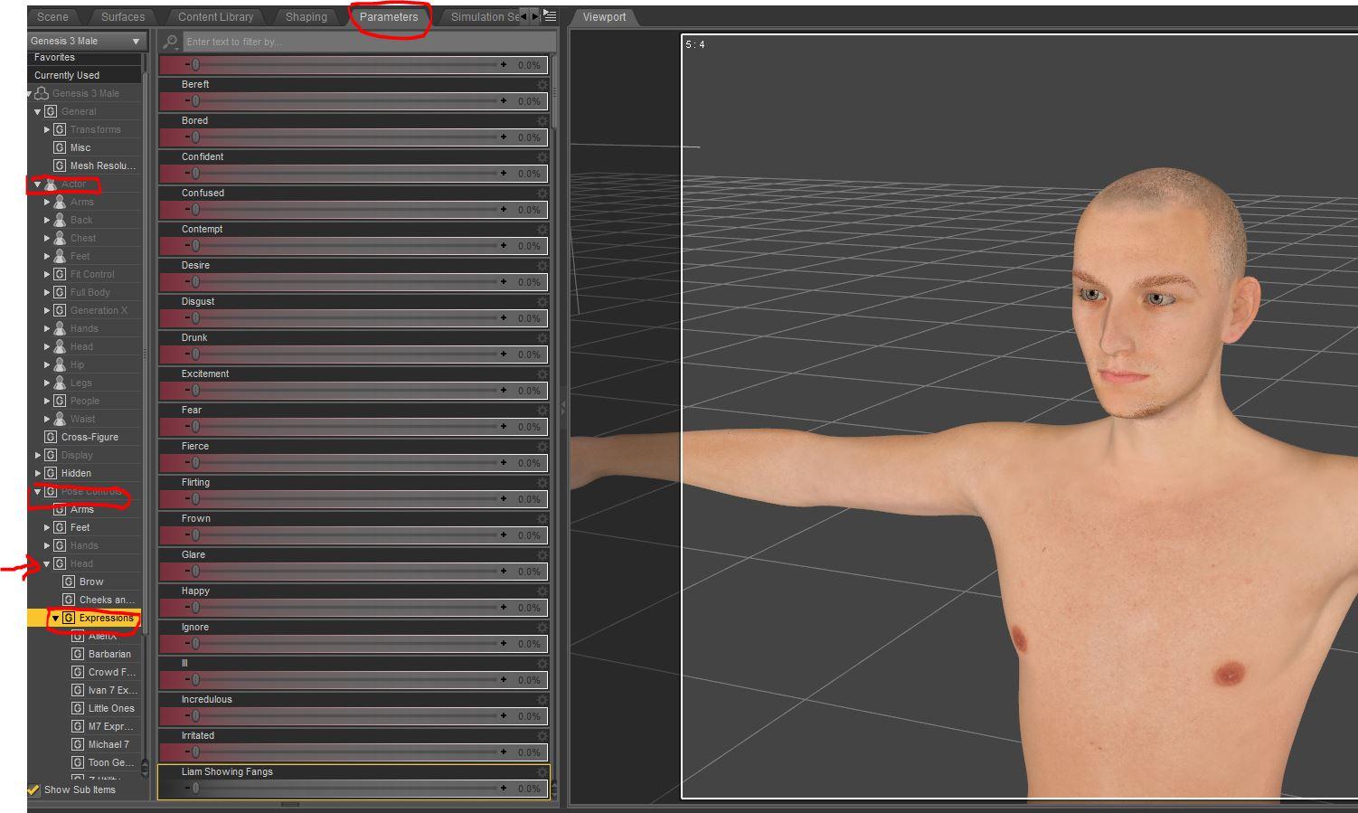

    You're looking in the wrong sections of the tab. I don't have the female version of the 200, but the male, and it's in the Parameter Tab under "Actor".
    equally, you will find the pose controls for facial expressions under Parameter Tab-->Actor-->Head-->Expressions. Some expression sliders only show up if you select the head in the scene, for whatever reasons.

    Those will not add new properties, they just set the values for existing proeprties (which should be there, it looks as if you have the product installed correctly). Try Looking at the Currently Used group in the Parameters pane before and after applying a preset.
    Please remember that we do not allow images of nude, textured ffigures - if you click the sphere icon to the left of the Perspective View button at top-right of the Viewport in your screenshot you can set the drawstyle to Smooth shaded, which is OK to show.

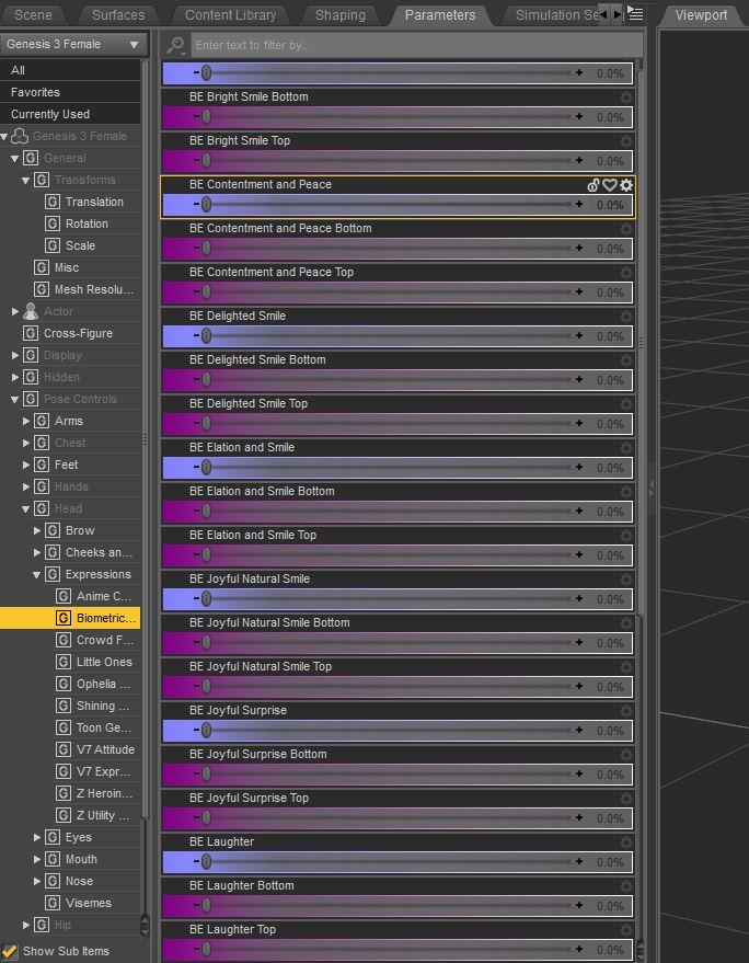

    For whatever reason the Biometric Expressions:Happiness and Joy! for Genesis 3 Female is not showing up in my Parameters pane.
    I have Genesis 3 female selected, I have applied one of the Expressions (BE Bright Smile), When I go into the Parameters pane,  , >Pose Control, > Head, >Expressions I can only find the expressions for Toon Generations, and none of the others.

    Okay... I just bought this and installed it through DIM, and it shows up where it should.
    That means that something seems to have gone wrong with the installation.
    Have you tried uninstalling the morph set, deleting it from DIM, and redownloading it and then install it new? Also, keep DAZ Studio closed while you are doing this, just to be on the safe side.
    Also, have you changed your installation location?

    I finally have it working. Deleting and reinstalling didn't seem to help. Redownloading and running the script that shows Daz where to put things made the difference.
    Everything seems to be working now!
