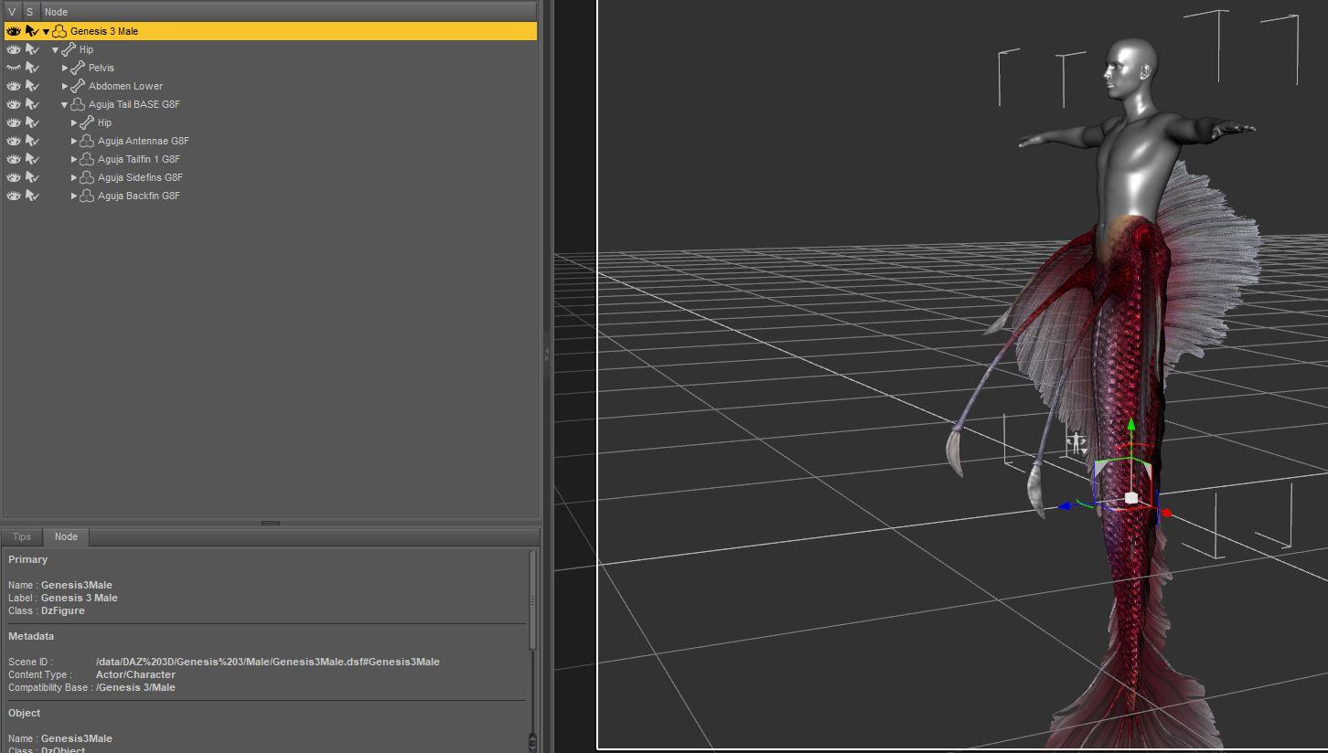

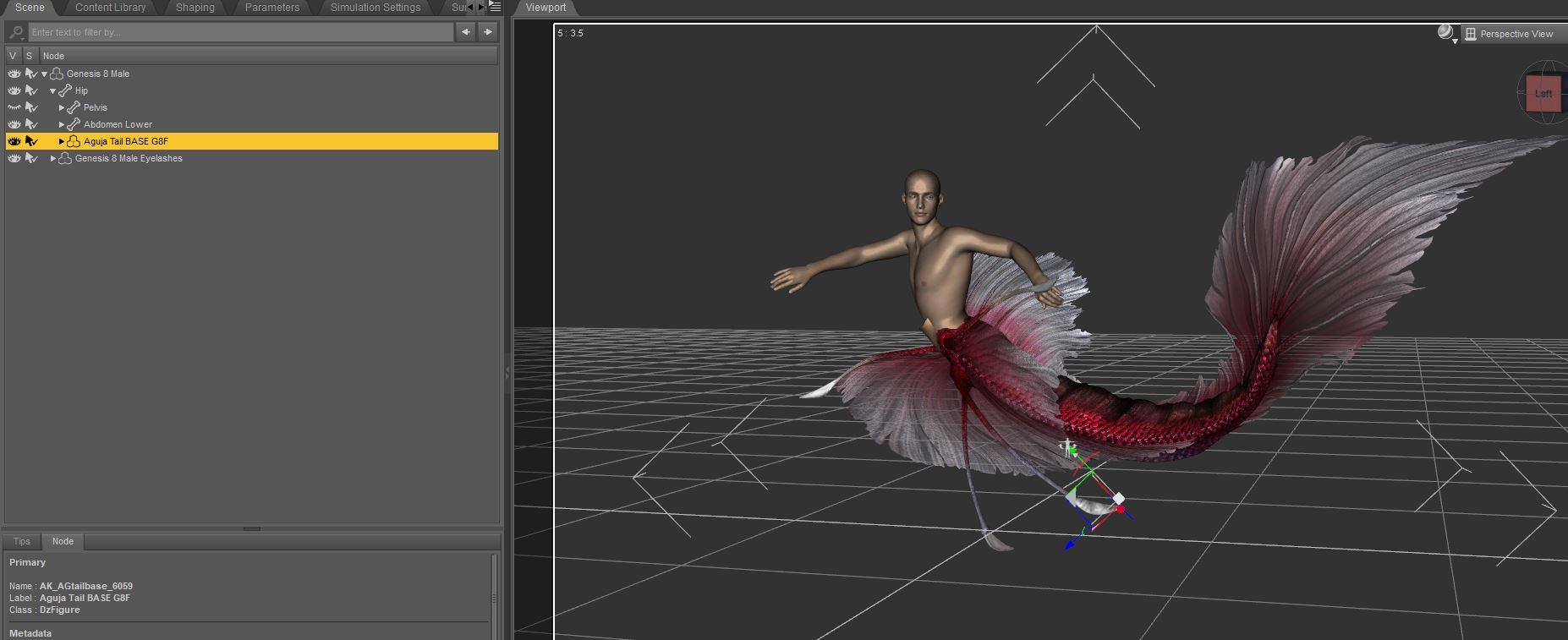

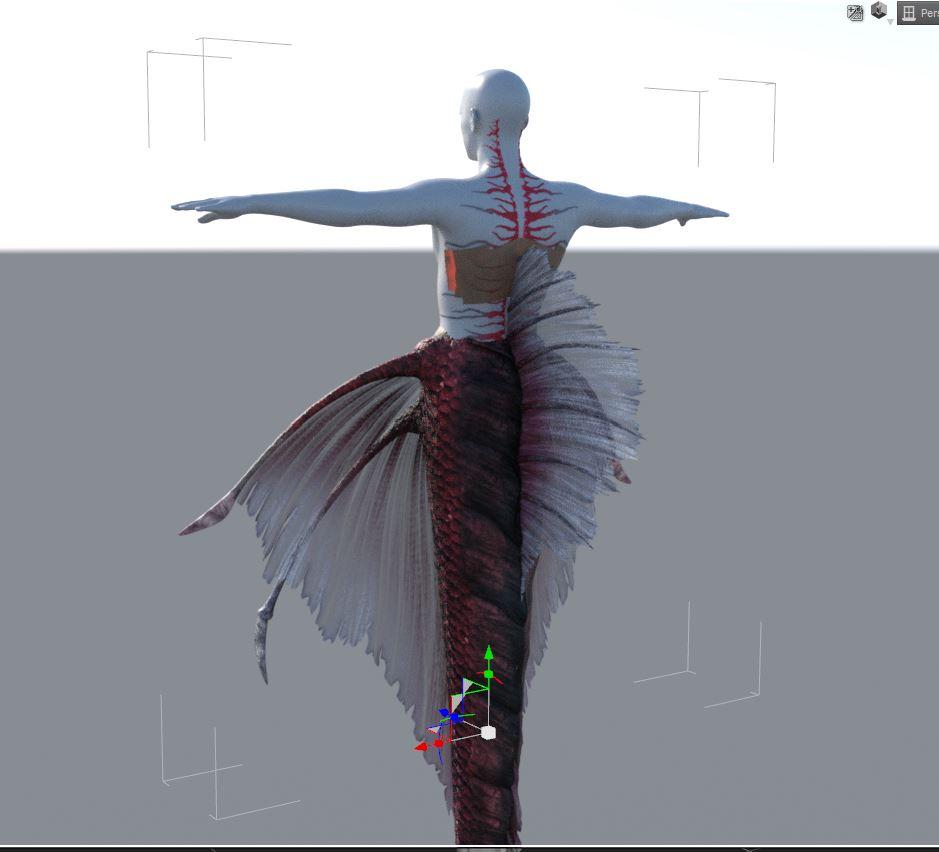

    Just tested this... It does mostly work on G8M, however, you need to load it without G8M selected, and then "parent it in place" (do not autofit!), and the Bodywebbing is rather uncooperative... I don't know what it needs parenting to - in the female version it's parented to the top level. Ah well.
    The gills can be applied with "fit to" without loss of functionality.
    In addition, the stomach area needs a bit of shaping tab love on the G8M side of things.
    In any case, once you parented everything in place, the G8M Mermaid also takes the pose set.

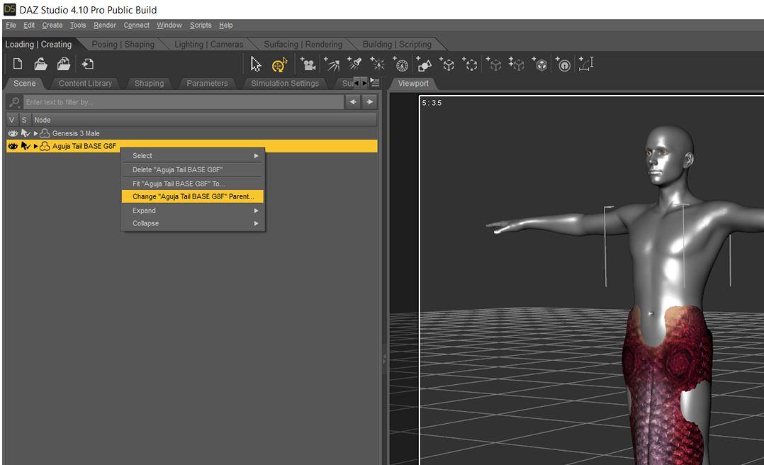

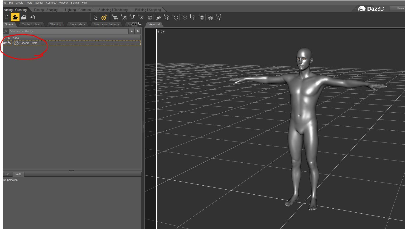

    Okay... here we go (and I accidently used G3M for this... except for the last couple of images where i switched over everything to G8M).
    Step 1: Load your G8M (or G3M) into the scene. Go to the scene tab and unselect the character (click somewher else in the scentab so that it looks like in the image).

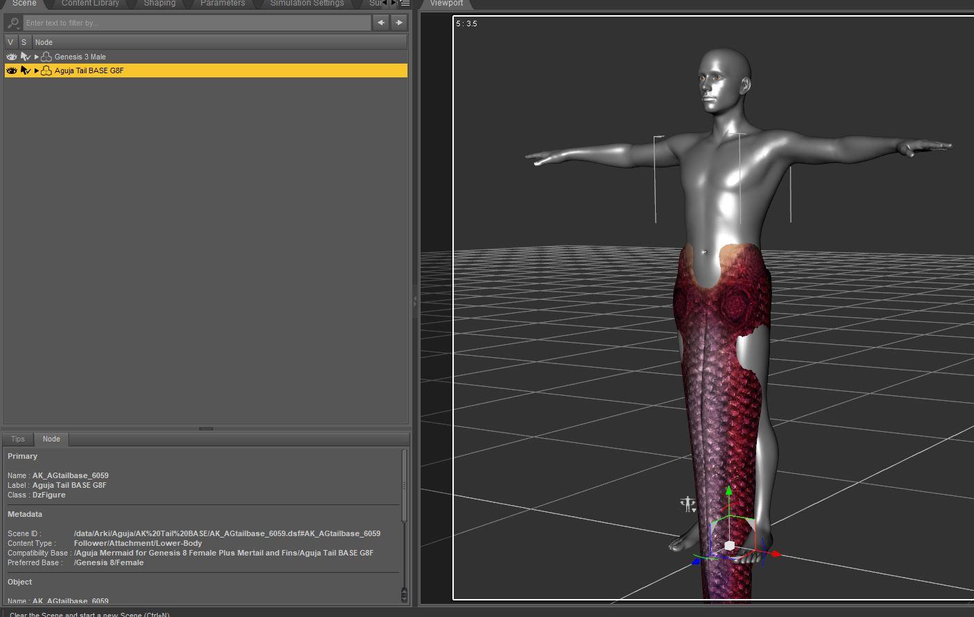

    Step 2: Load the tail into the scene. It is important that you use this way, because when using Autofit, all the bones in the tail will be lost (no more movement).
    Step 3: Select the tail in the scene tab.

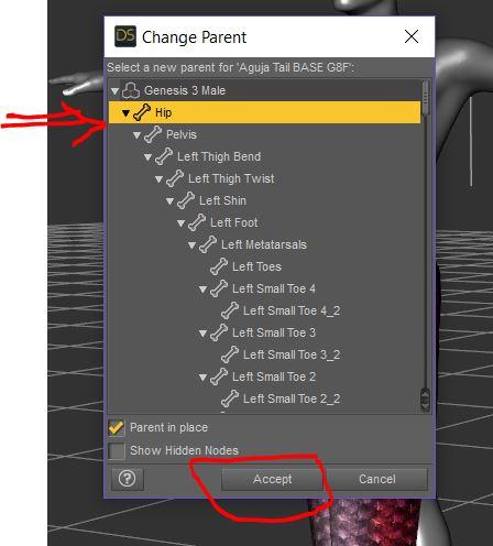

    Step 4: Right Click. From the menu, selct "Change Parent"

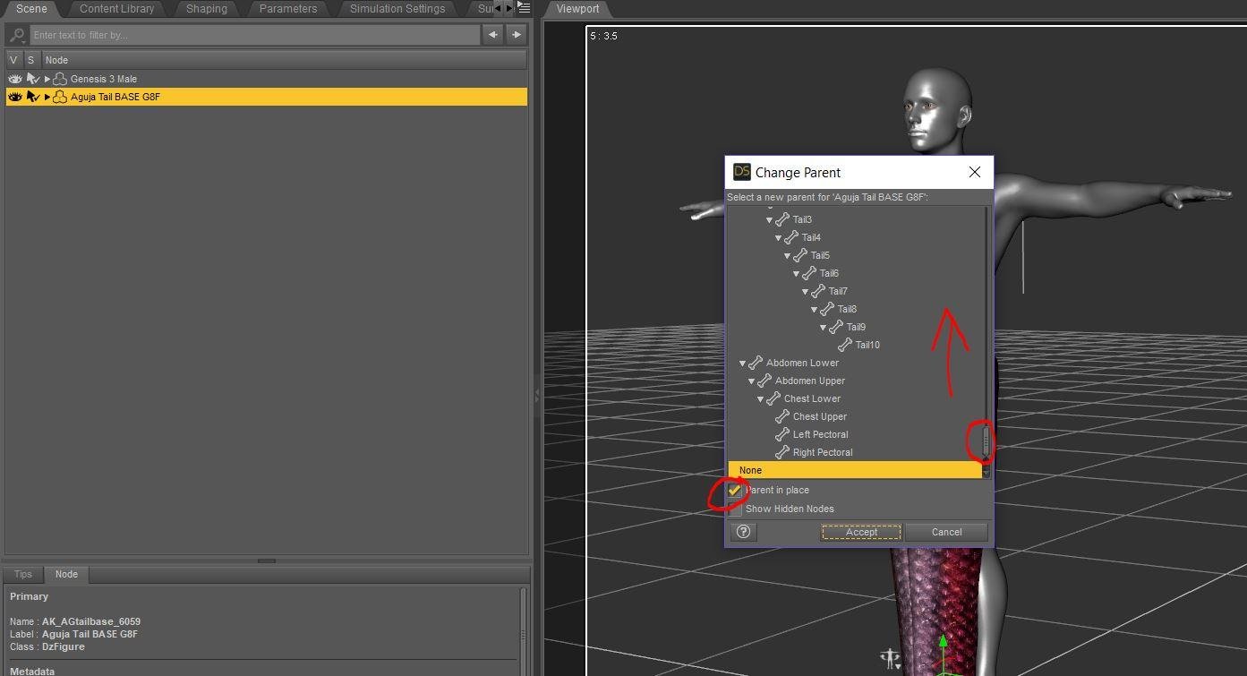

    Step 5: In the Menu that pups up, make sure that "Parent in place" is selected, then use the scrollbar to scroll up until you fine Genesis 8 Male (or in this case, Genesis 3 Male).
    Step 6: Select the hip bone. Then click "Accept".

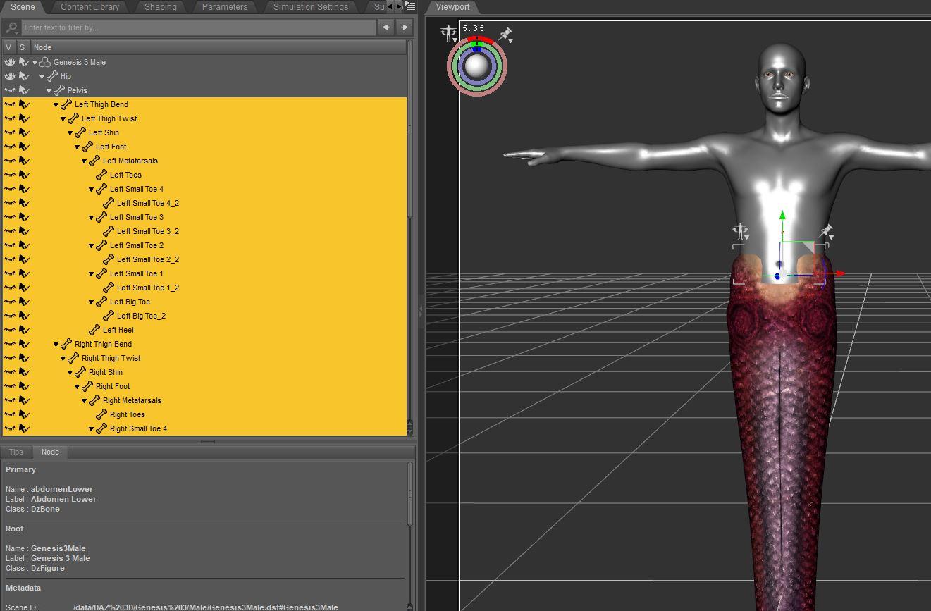

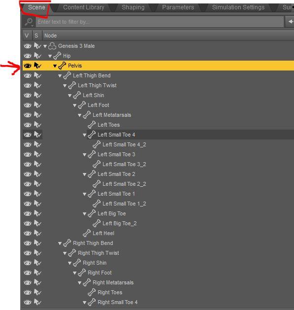

    Step 7: Go back to the Scene tab and open the bone structure of Genesis 8 Male (or G3M)
    Step 8: Click on the small eye symbol in front of every bone that needs hiding (not all bones shown here).

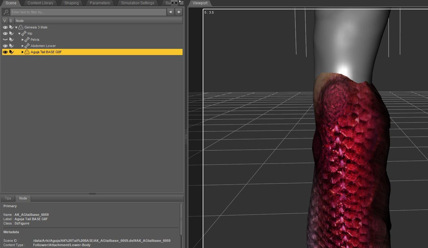

    Step 9: this hides the legs. For the next step, select the Mertail in the scene tab.

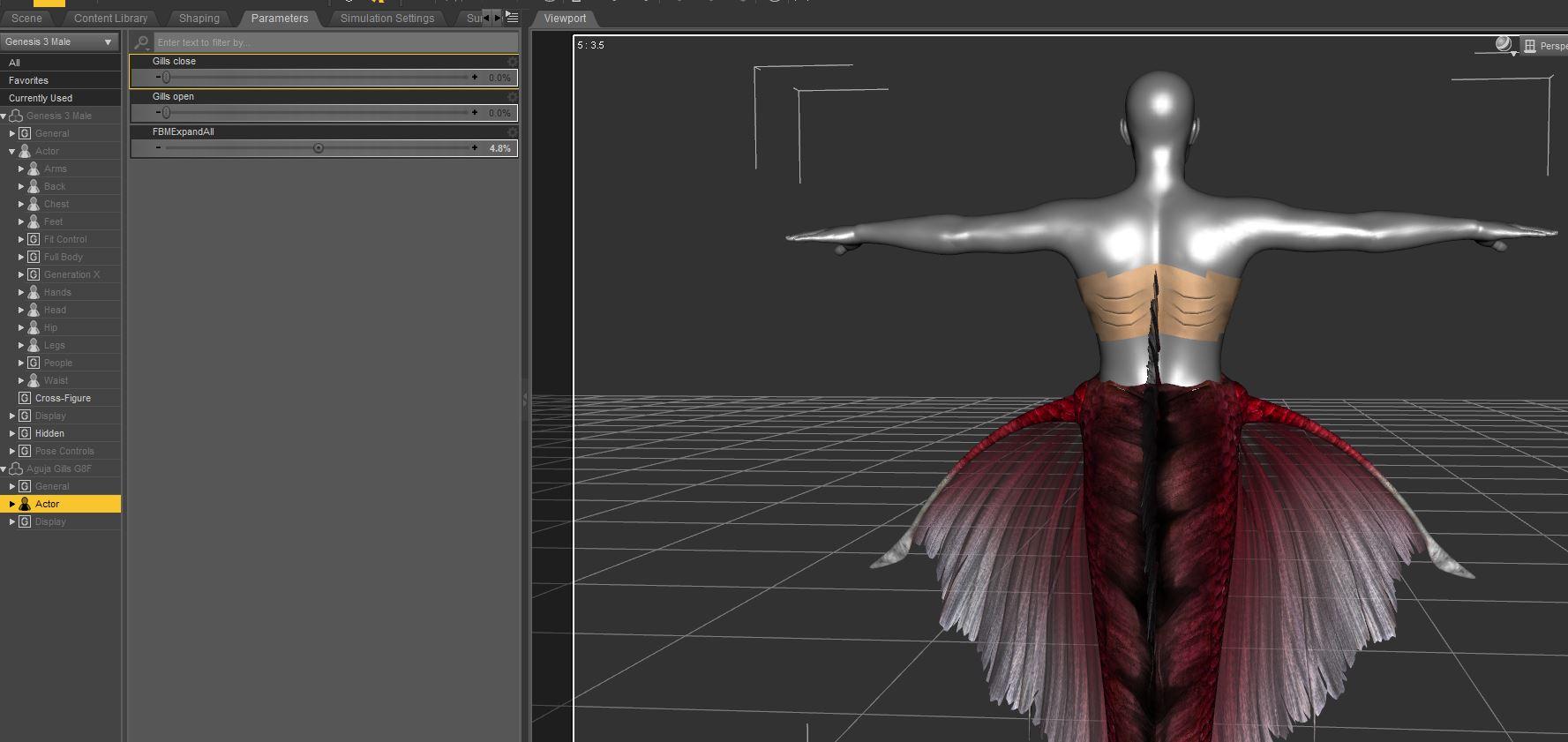

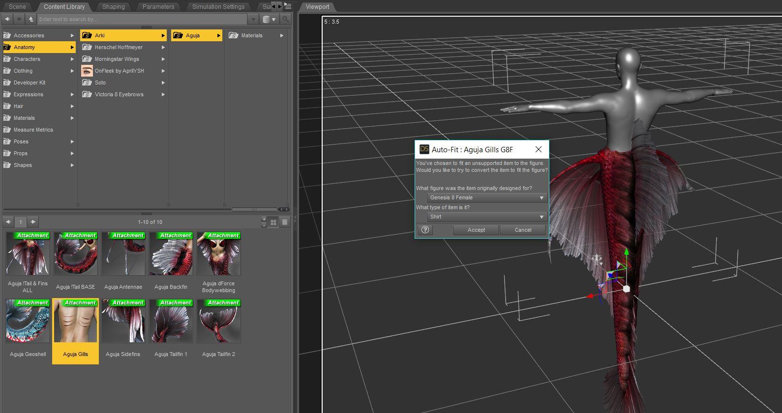

    Step 10: With the mertail selected, load the fins and antenna. They will automatically parent correctly to the tail.
    Then, select Genesis 8 male to load the gills.
    Step 11: With G8M selected, load the gills. You can go through the autofit here, as the gills have no bones. The morphs will work fine.
    EDIT: The same goes for the bodywebbing (thank you to @Arki for the hint), they can simply be autofitted the same way as the gills.
    Step 12: If the gills descened too far into the body, you can use the "expand all" option for fitting.

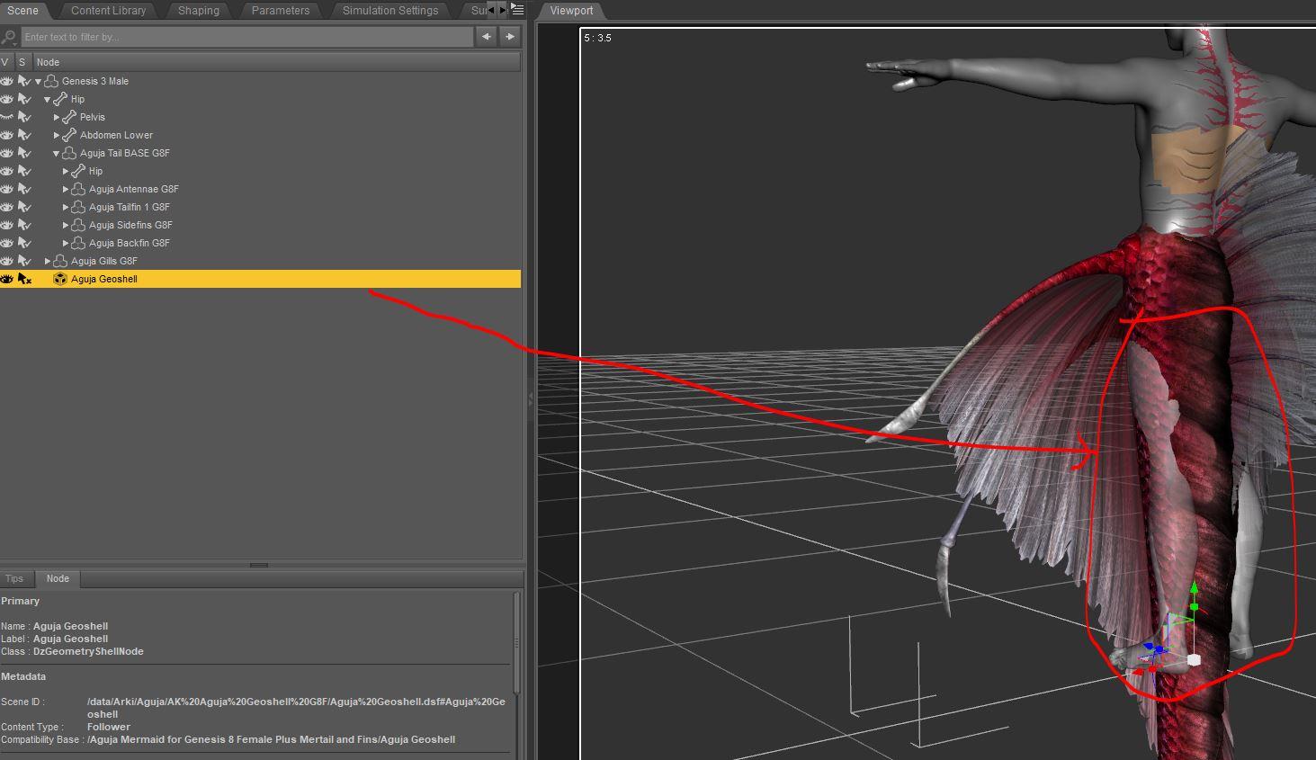

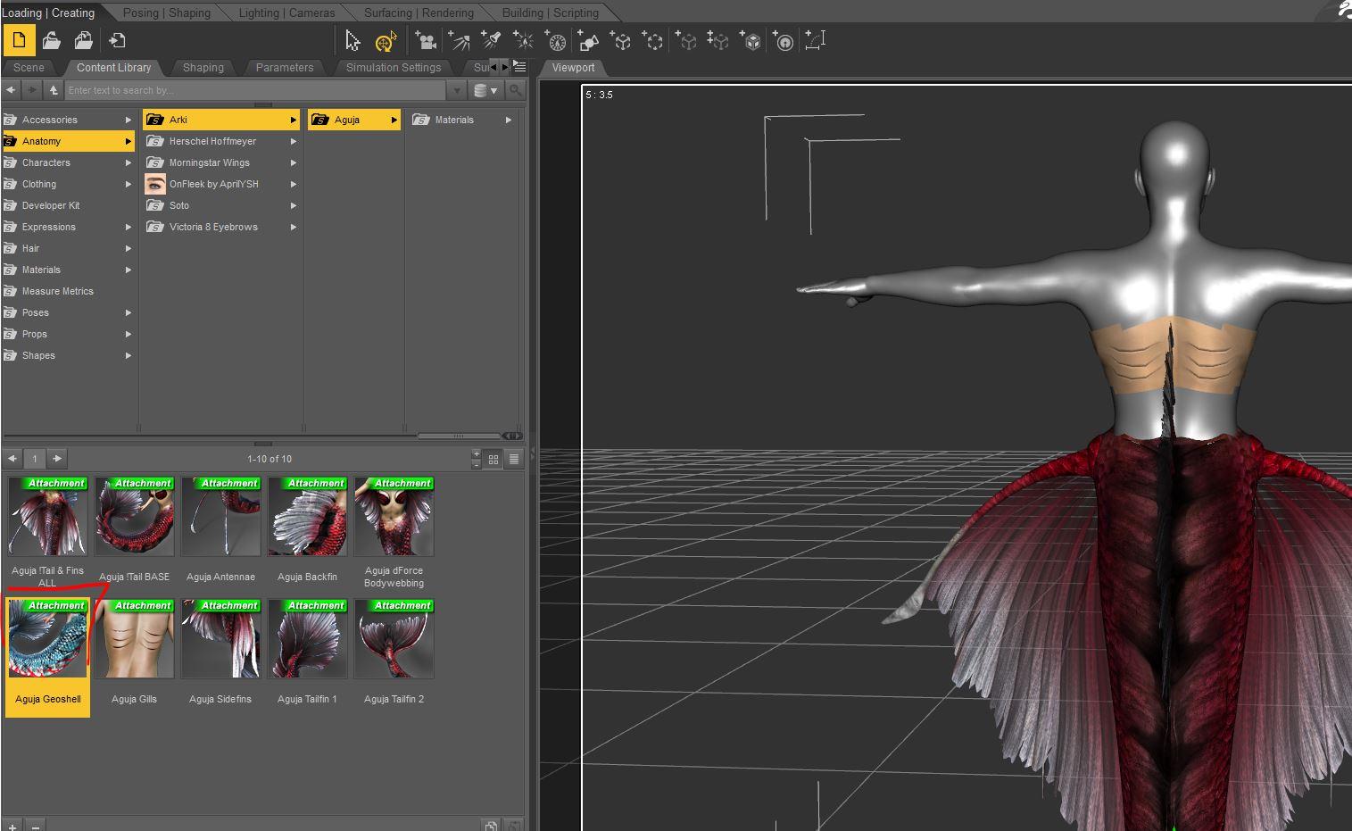

    Step 13: With Genesis 8 Male selected in the scene tab, apply the Geoshell.

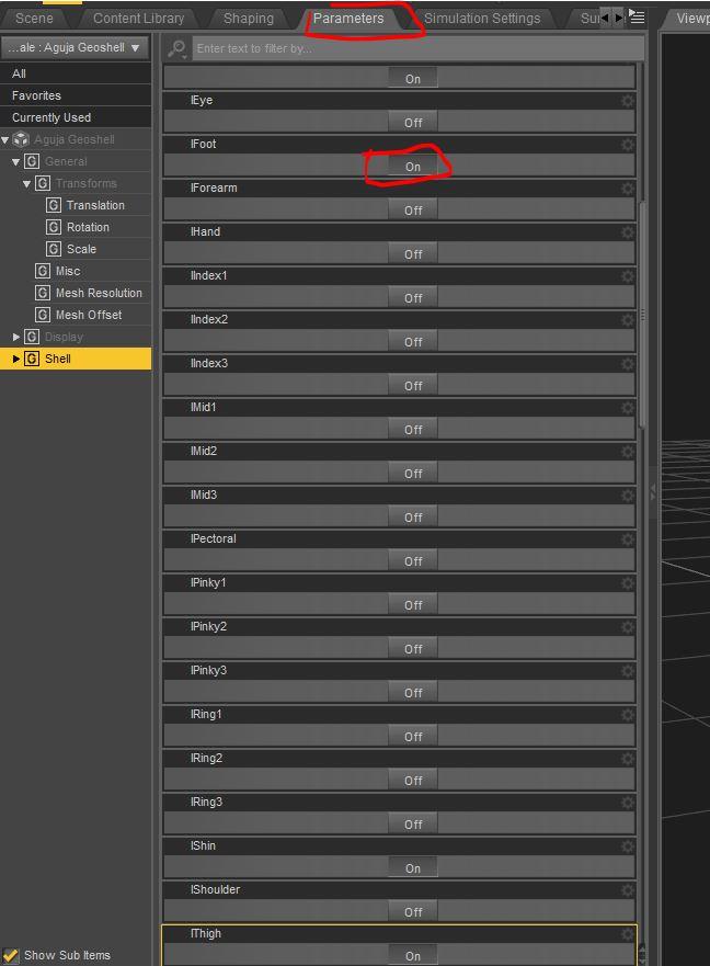

    Step 14: When the geoshell loads, it will show transparent legs. These need to be switched off. In the scene tab, select the Geoshell.
    Step 14: Go to the parameter tab. Go to the "shell" section of the tab. From the list, turn everything "off" that belongs to the legs. Scrolöl down to the bottom of the list, as everythings ordered alphabethically.

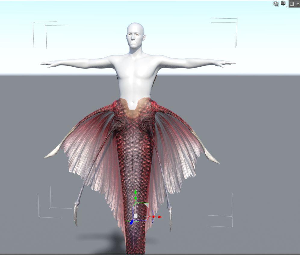

    The result:

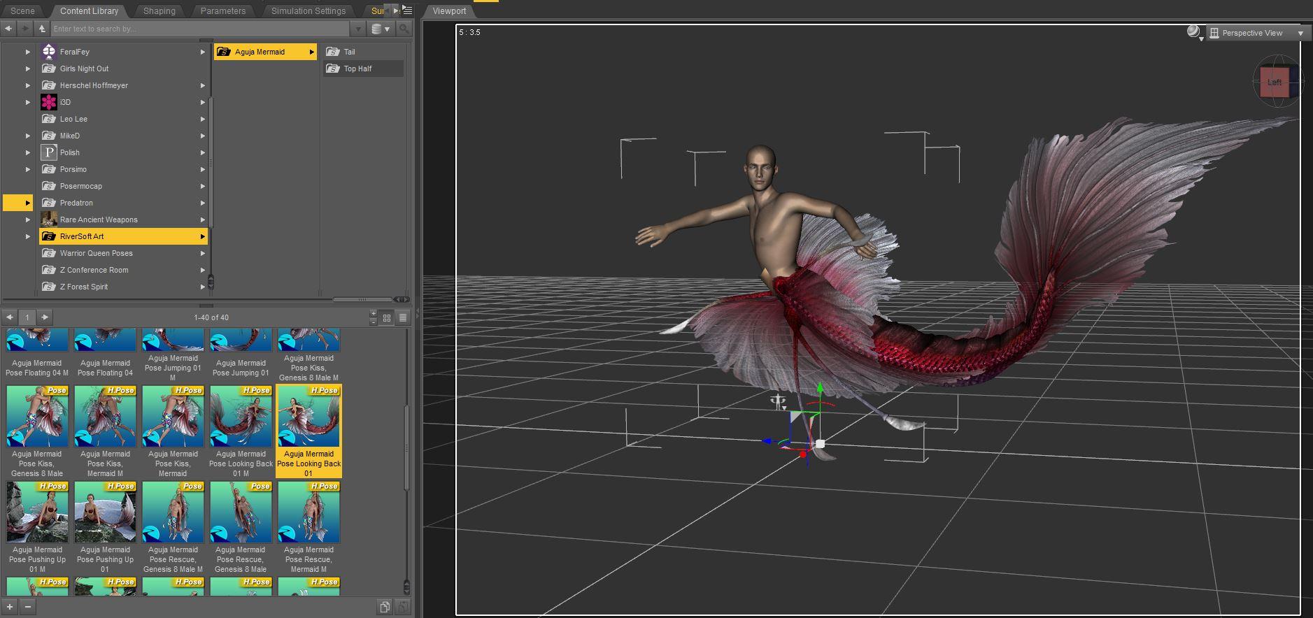

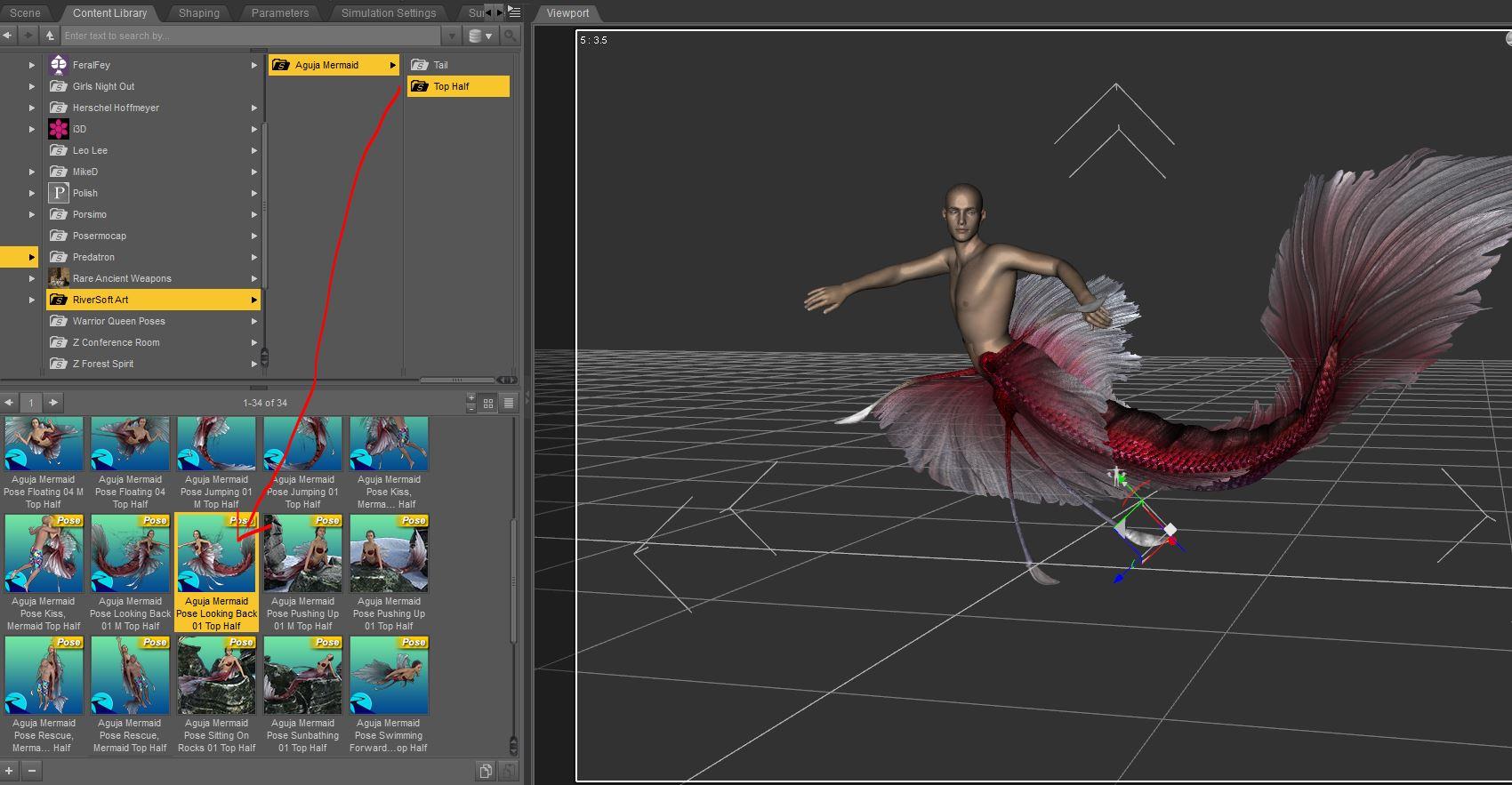

    Step 15: Applying the mermaid poses (this is done on G8M)
    First, apply the "overall" pose. This will mostly work, except for the stomach area.
    Go to the scene tab and select the mertail.
    From the poses, go to the "Top Half" poses. Select the matching pose for your pose set and apply it. This will correct the stomach position.
    Enjoy. :-)
