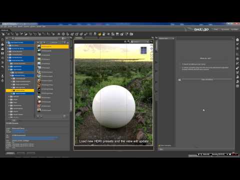

    This will help... make sure Draw Dome is enabled...

    Rain City Chicago is generally like every other HDRI when used with Iray. Double click the view and resolution you want. Make sure Draw Dome is ON in Render Settings>Environment. Unlike most other HDRIs, However, having Draw Dome off will give a black background instead of the transparent background that is usually the case with Draw Dome Off. Any objects in the sceme will still be illuminated.
