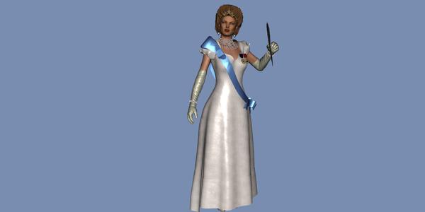

    So I was not able to get the sash just perfect as you can see in the picture so with d-forms I can push and pull the sash to fine tune the sash. If you want directions on how to use d-formers then we can talk about that after you have tried the conversion.
    Hope this helps you with your dilemma! Oh and I have other ideas if you can't get this one to work out for you.

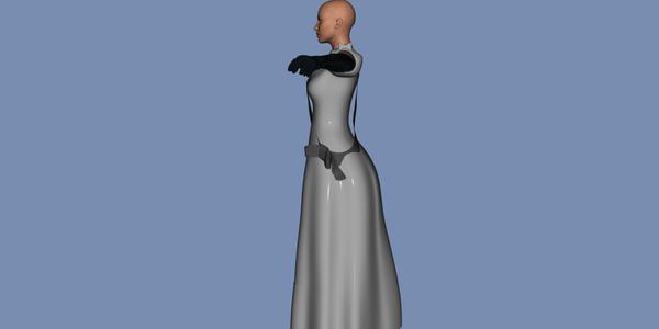

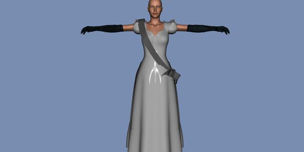

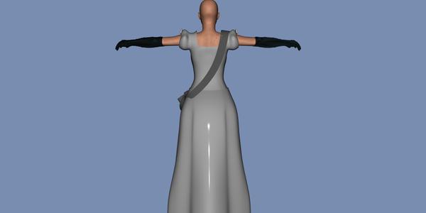

    I'm going to go ahead and show you some renders of the testbed figure with the sash (properly fitted to V4 this time!) before I do any tweaking so that you can show me where to go from here. Front, rear and left/right side views. As you can see the main areas needing adjustment are at the right shoulder/collar and down on the left hip/lower left abdomen. The gown used for the test figure is the free Belle Epoch gown; I intend to eventually use the sash with many other formal modern and historical gowns, but Belle Epoch will do very well for a test bed since you can get it quickly from ShareCG if needed to run your own tests.
    P.S. I have to run out quickly to do an errand but I'll be back within half an hour so I'll pick up from whatever you show me.

    Back. I've tried fiddling around with the sash to see what adjustments I can make before you show me your own way to do it, but I've noticed something odd; when I fit the sash to V4, the "scale" morph seems to disappear from the Parameters menu. Maybe I ought to do the adjustments before I fit the sash to Victoria?
    EDIT: I've tried unfitting the sash, but the "scale" morphs won't come back. I'm afraid I might have made some kind of mistake somewherei in either the Hexagon process or the DS sequence. Should I start over? I'm sure I followed all the directions the first time but I wonder if I missed something somewhere, because I really don't think the scale morphs are supposed to vanish once you fit the sash to V4.
    Post edited by joea64_bdfaa5ca94 on
  • DollyGirlDollyGirl Posts: 2,717
    That is normal because scale is now driven by V4 instead of the sash. When you say fit what you are telling DAZ is that all of the translation options of the sash are to be relative to V4. Since DAZ knows this it does not allow you to use the translation tools to reposition the sash. That is why I had you do your tweeking in Hex to get the sash as close as possible to the correct position.

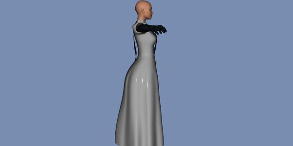

    I've gone back into Hexagon and made another sash .obj, making it a bit larger this time so that it should fit gowns easier (I boosted the size to 0.200 and tweaked the positions a bit so that they shouldn't collide so much with a gown when loaded). Going to set it up in Daz now.
    EDIT: I did the right thing by re-doing the sash to make it larger. It looks MUCH better now, though it still needs tweaking at the collar and hip areas to make it come out just right and fit it more snugly to the figure's/gown's contours. This is how the new version looks (NOT fitted to Victoria yet):

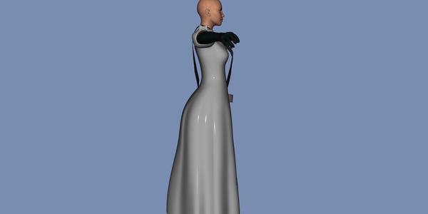

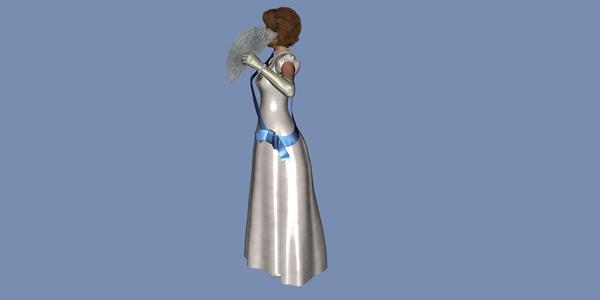

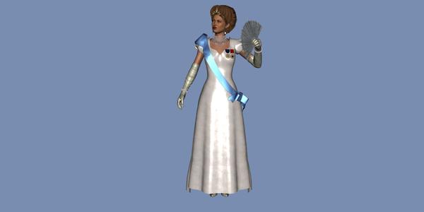

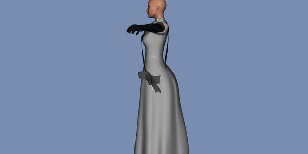

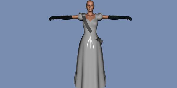

    I worked up the sash this morning following your directions for making it smoothing-capable. This is the result, after I put together a demonstration figure. As you can see, applying the smoothing modifier worked quite well, and there's no significant pokethrough or hidden parts. I think the main thing I still need to do here is to get the sash to fit more closely to Lady Victoria's curves. I didn't see any D-form morphs in Parameters, but maybe I need to turn them on or something?
    I have a number of "base" figures that I created with various gowns (to make it easier to get started for future projects), so I think what I should do is apply the new sash to some of these different gowns as I'm going to need to fit them to each gown in turn and it'll be easier to do that for a template figure than have to re-do it every time I create such a figure.
    Before I forget, thanks for handholding me through this process! :D

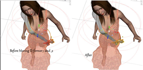

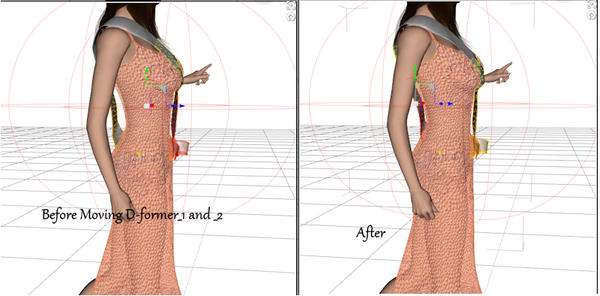

    joe,
    Looks good. I have setup this entry up so that the actions are bolded and my lecturing is not.
    D-former is a tool that DAZ Studio provides to allow the artist to do small position changes to a set of polygons in the mesh. So I am going to walk you through the use of the deformer tool but this will not make the sash look the way you want. You will probably end up with multiple d-formers because of the size of the area and the fact that you want to push the mesh in from more than one direction.
    Under Window -> Panes (Tabs) you will find Dform. You want to click on this.
    This form gives you access to create and manipulate the d-formers you want to work with. Manipulation includes changing the distribution of intensity of the d-former, removing points of influence and spawning the morph from the set of d-formers. The second way to access a d-former is from Create -> New D-Former.
    Select the object in the scene tab and add a d-former
    It is just not anywhere on the list of the object but where the geometry has been assigned to it. Usually this is the top of the tree but there can be other nodes that have geometry. I am sure there are ways to know exactly where the geometry assignments have been made but I just click on what I think would be the most likely and if I am wrong I try another node. So if I wanted to make changes to the hip area then I would select the hip and see if I can create a d-former there. DAZ will tell me if I guessed wrong. If I did then I would move up the tree to the next node and try again.
    Click on the Create New... button in the form or go to Create -> New D-Former. Name it anything you want. I just use the default name DAZ provides.
    This adds the d-former. It is a set of elements in your scene that has Parameters associated with them. The d-former comes in three parts, the field, the base and the d-former. Named with your selected name and field and base added to the field and base elements.

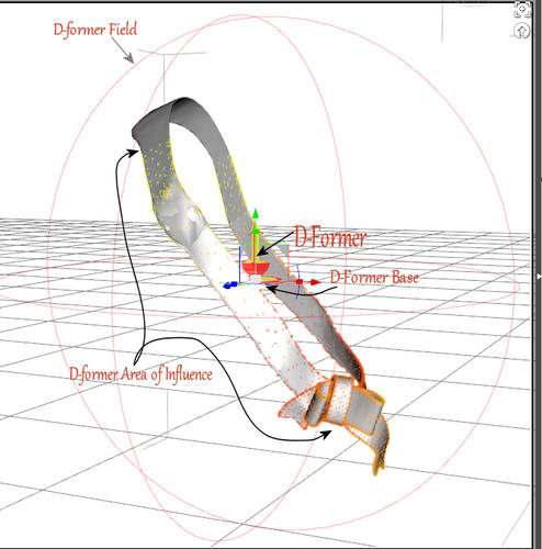

    To see your d-former you need to highlight the d-former field element.

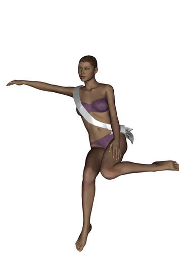

    I have attached a view of the sash with one d-former created and the field element highlighted. Each element of the d-former can be scaled, positioned and rotated using the Parameters tab. What you see in the picture is the scale of the d-former, that is the set of red line circles. The area of influence, that are the red, orange and yellow dots. The base, which looks like a bulls eye. The d-former which looks like half a sphere with a cylinder running through the middle of it.
    As you can see from the picture that my area of influence is both the front and back of the sash. If I moved the d-former in the positive z translation the front of the sash would move away from V4's body and the back would move into V4's body. I know this because of the dots. All dots move the same relative distance. I also know that my z translation is stronger around the bow where the red and orange dots are located and that at the shoulder of the sash there would be no movement because there are no dots there.
    Select D-Former_1 from Scene, go to Parameters tab and change z translate to 23.
    You can d-form the mesh quite a bit. You can change what and how the mesh changes by moving in all three directions and scaling the Field. You can make little bitty changes or you can make large changes.
    Create another d-former. Using the translation tools on the Parameters tab for the second d-former field move the field a little more to the left and front of the first d-former.
    By adding the second deformer we can play off on the d-formers by keeping the influence similar but just a little bit different. I told you to put the second deformer a little in front and to the left. I did that because if you look at my before and after pictures you can see that my sash is further away from V4 body in the back and right side. So I want my d-formers to help me pull more away from the original position and get closer to the body. You may find on your sash/dress that the second d-former should be positioned slightly differently to get the affect you want.
    Selecting one, D-Former_1 or D-Former_2, make small changes. For my example I moved the d-former in the x and z translations only. Below is listed my final positions.
    Select the other D-Former and adjust. You will end up going back and forth until you get what you want.
    D-former_1
    x -0.92
    y o
    z 3.99
    Field
    x 1.32
    y 103.92
    z -11.80
    D-former_2
    x -5.00
    y 0.00
    z -1.51
    Field
    x 1.40
    y 104.0
    z 13.64
    From this point you now have the object pushed and prodded into what you want it to look like. You can save the scene and DAZ will faithfully keep your work all in place. But the DForm form gives you the option to create a Morph from all of the d-forms you have created. That is the bad part you don't get to pick which d-forms go into the morph it is all of them associated with the geometry that you have been working on. So if you created 14 d-forms then all 14 will be in the morph and DAZ will create one morph that calculates the results of changing the d-formers by the percentage you choose on the morph slide bar and makes the changes. Your morph is on the element, in our case sash, that the assigned geometry is. You will see a new subheading called Morphs. DAZ creates the morph using the current settings of your d-former as the 100% mark. There are things that you can do to control how much changing you will allow when the morph is applied. I am not going to go into setting the limits and such.
    Select the object.
    on the Dform form check all three boxes, Create Root Control Parameter, Delete Applied D-Formers(s) and Apply Spawned Morph
    Click on Spawn Morph....
    Give your Morph a name and click on Accept
    You now have a morph. If you want the morph to be with the sash then you will have to
    remove everything but the sash from your scene and then
    Go to File -> Save As -> SupportAsset -> Figure/Prop Assets...
    Save the sash file
    There you go joe. You have now completed your first conforming clothing article, with rigging and morphs. This method is just one of many ways to do this stuff and there are just a bunch more actions you can do to the object like uv mapping, creating material zones and such that we have not discussed but hopefully your project will not be road blocked by that. I hope I have helped and welcome to the wonderful world of 3D.
