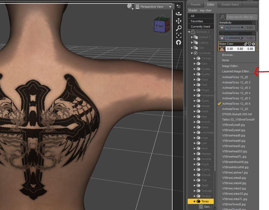

    Step 1: In the surface tab, select the surface you want to edit. In this case, it is the torso surface of G2F, converted from 3Deligh to Iray. I also applied the tattoos (from a set that predates XXQuatro'sXX set by two generations but works the same). Then, click on the small triangle in front of "Base Color", and in the dropdown menu that opens, select "Layered Image Editor".

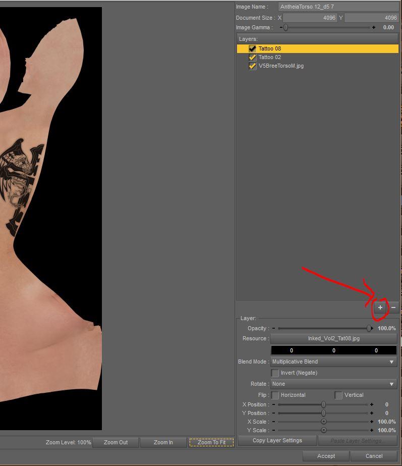

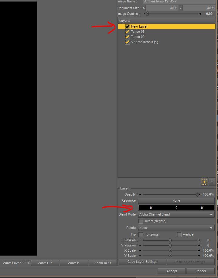

    On the right side, you see the list of all layers - if you have worked with Photoshop, or Gimp, this should look familiar. We now need a new layer, and for that, you click on the little plus symbol at the bottom left of the layer listing.
    A little menu opens that has the options of "New Layer" or "New Mask". We want a new layer for the first step, so select that.
    Step 3: The new layer opens and is shown in the listing as the top layer. Your image to the right goes completely black, but that is okay.

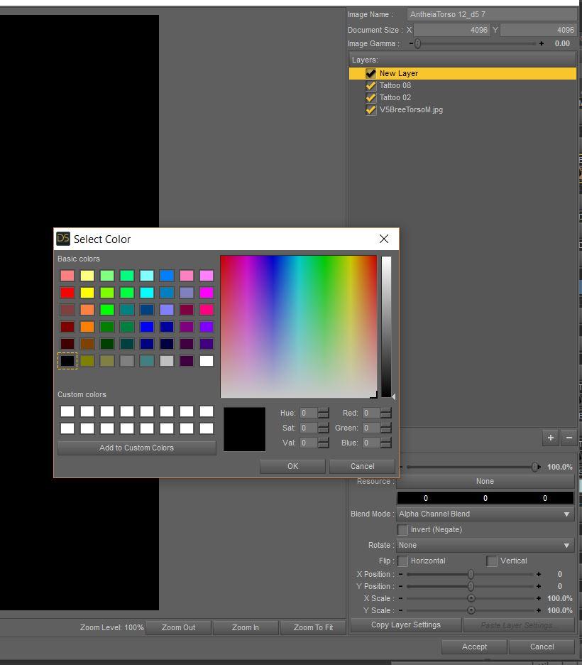

    Below the layers listing, you'll find various settings. Opacity (controls the opacity of that particular layer), Resource (you can add a map/image there) and a black bar with Zeros in it(Layer colour). Click on the black bar.
    Step 4: the colour selection opens. Select the colour of your choice and click "OK".
    Your map on the right side will turn into the colour of your choice now. That is okay.

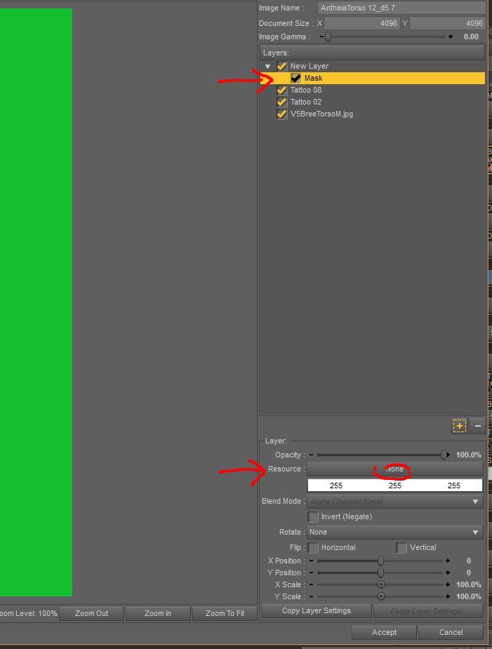

    Step 5: Adding the layer mask. Select the "New Layer" and again, click on the plus button that you used to create the new layer. Just this time, select "New Mask".

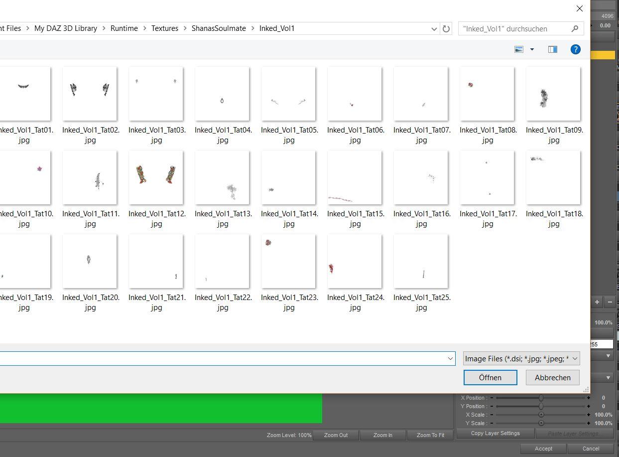

    Step 6: With the New Mask layer selected, go to the Resource slot and click on "None" to select the tattoo image. You might have to track down the location of that first, as the LIE editor can be a bit kinky at times in regards to the initial opening folder..
    Step 7: Select the proper tattoo file and click "Open" (or whatever your system language tells you ;-))

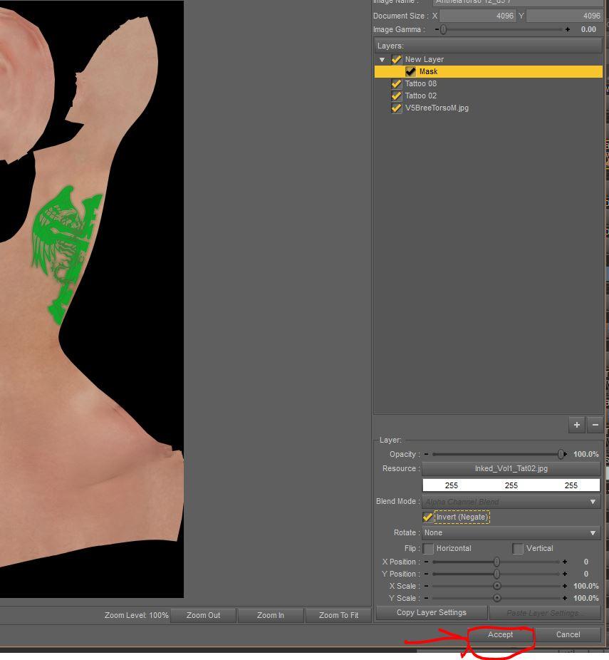

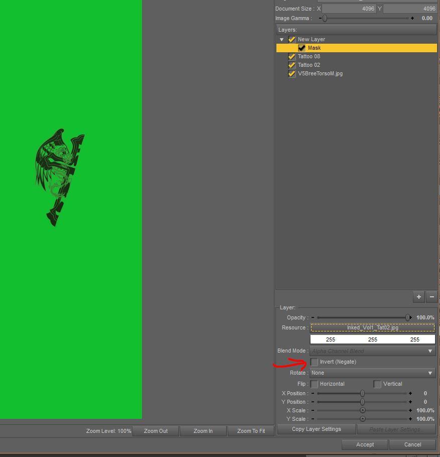

    Step 8: In your right hand image, you now see the tattoo on top of the colour layer. That is okay. Make sure that the New Mask Layer is selected for this step. In the options below the layer listing, look for "Blend Mode" and below that is "Invert (Negate)". Check the check box in front of it.
    Step 9: It might take a few moments for the inversion to complete. The map now has returned to show the skin map, and the tattoo is in the colour of your choice. Click "Accept" to confirm the changes. The LIE window will close and you will see the changes on the surface of your figure.

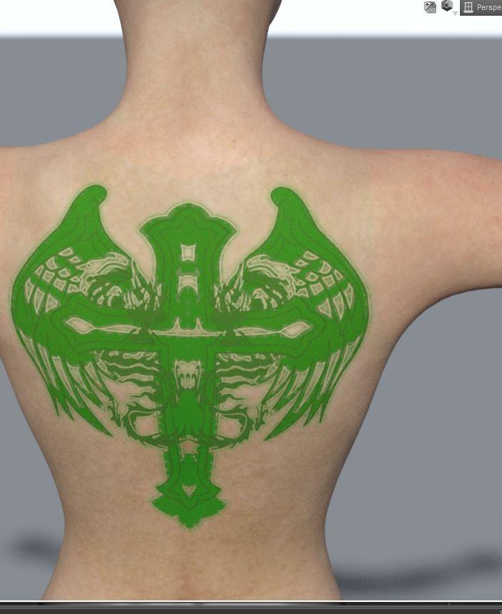

      Step 10: This is how the rendered result looks:

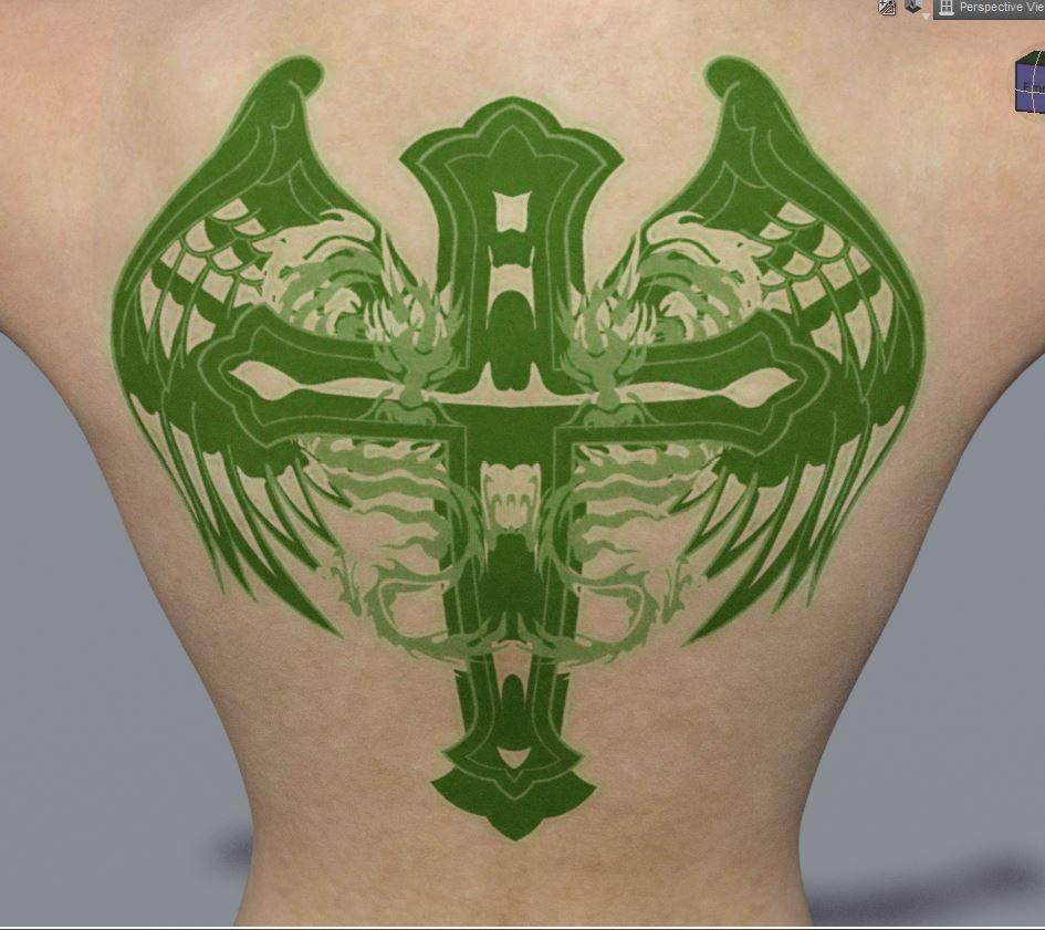

    Here's the result if you simply create a new layer, put the colour of your choice to it, change the Blend Mode to "Multiply" (IMPORTANT!!!!), and then add the mask layer as described above. It has a slighty different colouring, as it doesn't have the dark coloured tattoo below it and directly merges with the skin, but I think that the look is pretty good.
    Thank you again @jestmart - you'rea  genius! smileyheart
