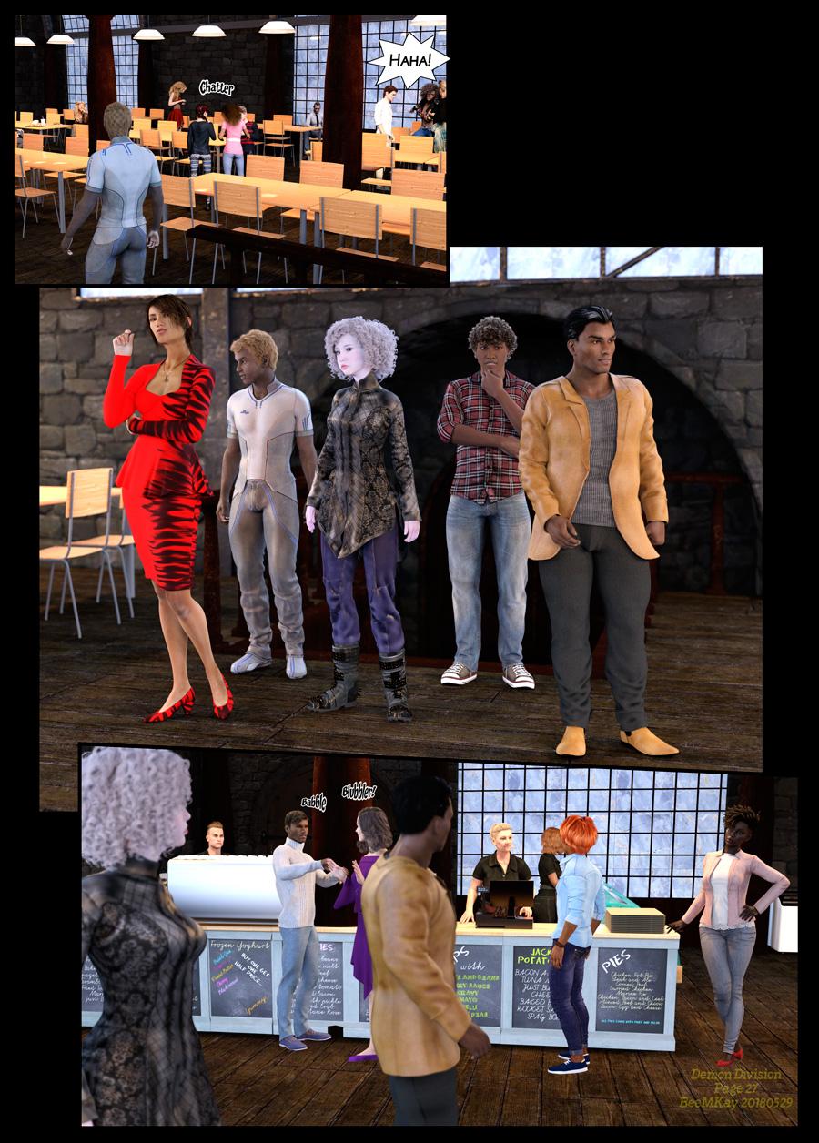

    Below, you can see the example of different lights used.
    This first image group is set in a corridor that has direct light. I used the Ghostlight Kit with Sunglight settings to add more light to the corridor. The outside light is one of the Skies of Iradiance Daylights.
    The second set is indoor, in a closed emergency treatment room. The light is very bright. I used several Ghostlights from the top to simulate strong lamps. The setting was for artifical light. Because I have quite a few light sources in the room, everything is evenly light and kind of bright. Also, there is a surface light above the hospital bed that has a slightly more yellowish light. Finally, if neccessary, I also placed a ghostlight closer to a character with a side angle, like in the bottom image that is slightly lightened from below.
    This here has quite a few light sources with different settings. There's a lot of lamps that have emissive surfaces. In addition, to the left and the right are stained glass windows that you see in the background. I made them emissive; there is no sunlight coming in. Unfortunately, while those windows are huge and emmit a beautiful bluish light, they weren't rally helpful in giving light to the scene, because you could only crank them up so much before you had gleaming bright walls. So, I took the surface material and used it as emissive map on with a ghost light.
    All three sets try to be realistic...

  • OminousAutumnOminousAutumn Posts: 401
    Ok thanks! 2 questions.
    1: what are the exact settings to make an object emissive?
    2. How in the H, do I get candles and practical lights to show up/look normal? I have never been able to manipulate practical lights (the ones that have the parameters to do so) beyond their defaults.

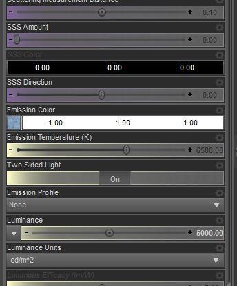

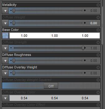

    When you want to make a surface emissive, you have to do two things - first is to plug the base color map also into the emissive slot, then set the emissive colour to white. That will make it emit light. The stronger you crank up the lumiance, the brighter the surface will become, just like in real life. So, if you still want to "see" the patterns of the surface, you can't make the light too bright.
    Here's the setting for the stained glass wall:

  • I will try this but when you say "the" base color map...are you referring to the base color map of the object itself that is trying to have light emissed from it?

    Yes, the base map is the one of the object that is casting light. For example, in a candle, you might have a "flame" material. Use that base material map in emissive.
    Practical lights... Ah... well, they can be a bit tricky. Most of the time, you can't contril them, because they aren't Iray emissives (3Delight materials, for example). So you'd first check out if you are dealing with Iray materials or Iray materials. If you have 3Delight materials, you have to convert them to Iray.
    It's also important that your object has a separat material zone for the light itself. Otherwise, the method described could lead to unwanted results. Is there a particular set that troubles you?
