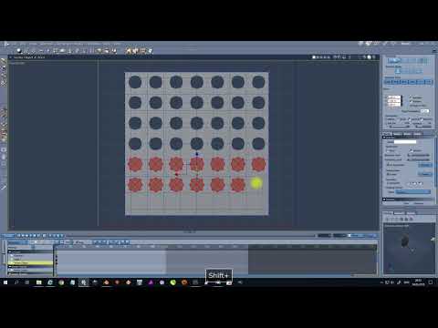

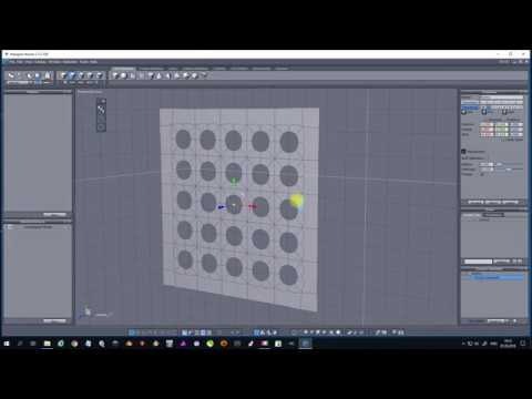

    Here is my method of cutting holes in Carrara
    Another video with the same method:
    why do they put round pizza in a square box? laugh

    Veronika, that is brilliant.
    must remember, (a) vertex to center, (b) mid edge to center
  • VyusurVyusur Posts: 2,235
    Thank you Ted! Glad you like it.smiley
