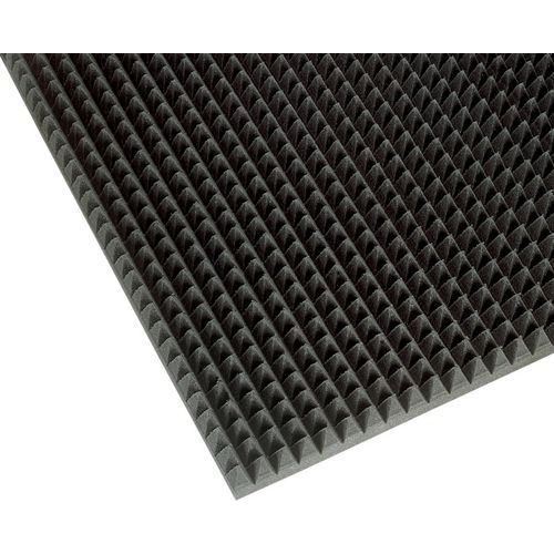

i'se trying to make a home made vocal booth, to record dialog for my Aiko 3.
saw these studio foams.  comes in 12 packs,
thinkin of gluing these to one of those room divider folding thingees to make an isolation shield.
could it possibly make a difference to block outside ambient sounds?
any advice would be appreciated!
thankssmiley

    They look very much like the linings on the anechojc chambers I have seen, so they would dampen sound in one way or another.

    Sorry i read wrong.
    These panels are for acoustics and not for sound isolation (though im sure the isolate some sound) The isolation works both way.
    PS it might be cheaper to just get one large foam cheet and cut it to size.

    That foam will work to cut down sound reflections in your room. To block outside sounds, you'll need something more substantial/thick. The regular options are expensive but you can try layers of cardboard strapped together, and it can work if you're in a fairly quiet area. They also sell mic balls for a couple hundred that will cut down noise. But if it's loud outside it will still come through. You may have to use a combination of things, including noise reduction in your audio recording software.
