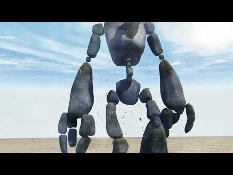

I was able to get the golem walking, if you like you can see the result here:
