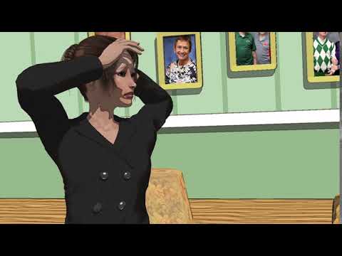

    Here I used a discreet tweener to stop unwanted side to side eyemovement. I wanted A3 to look in one direction for an extended period of time, and then look off to the side in just a few frames, beginning just before she begins turning her head.

    Here is an example of what the animation I referenced in my last post looked like.
