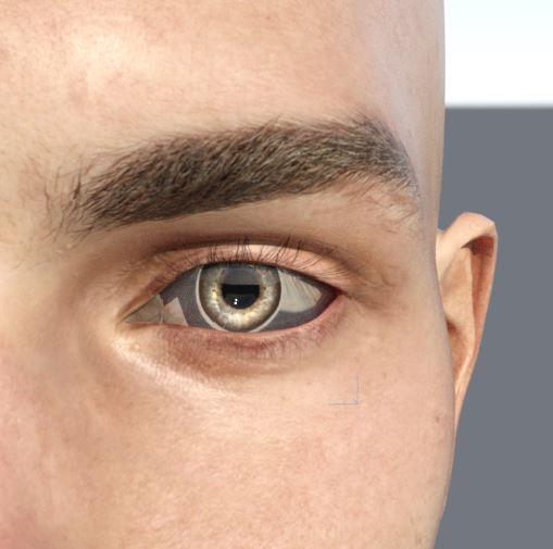

Is anyone els having this issue? I submiitted a ticket already but was wondering if anyone noticed this. (hard not to notice tho)

    This is M7forM8 with the M8 eye surfaces, except that I restored the blue M7 iris colour map. I did make some changes to the glossy roughness, TC roughness and TC reflectivity on the cornea, though.

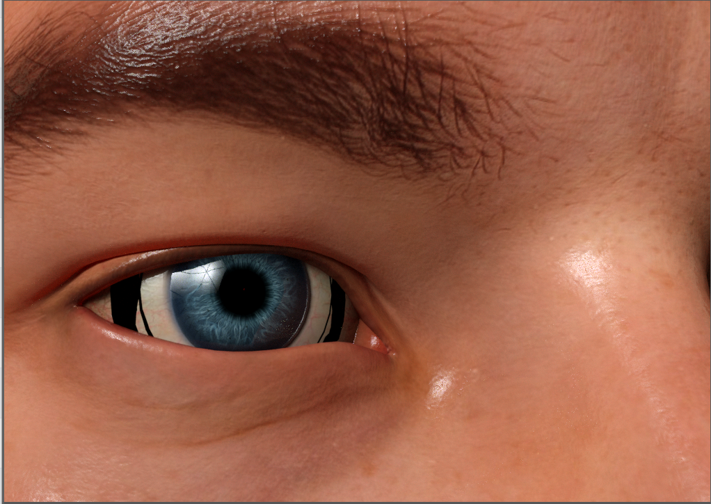

  • Thin walled is on by default, and of course you wouldn't want that off for the cornea. I'm attaching a render of the M7M8 eye at its default.
    561 x 876 - 294K

    The EyeMoisture is a surface over the Sclera when Thin Walled is OFF, you can get this result.
    You can use Colored surfaces in order to see what is happening in your case.

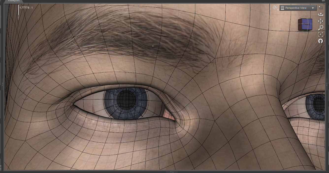

    For example, this Michael 6 morph for Genesis 8 moved a part of the Sclera (Red corner) over the EyeMoisture (Blue).
    (morph created thanks to [Tutorial] Transferring Character Morphs G1G2G3G8 )
    509 x 505 - 35K
    404 x 421 - 30K
    Post edited by Noah LGP on

    yeah I confirmed the sclera is overlapping when I took it into zbrush. I applied a tiny bit of smothing to the sclera and the problem went away.
