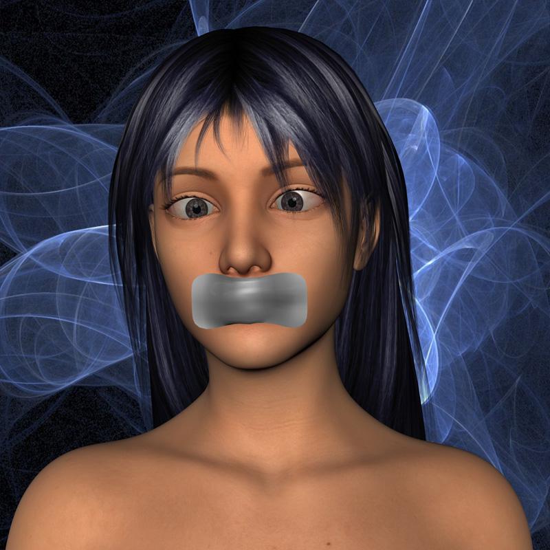

  • SixDsSixDs Posts: 2,384
    edited March 2018
    Or ... create a small primitive plane with appropriate divisions and set to collide with the figure, then move it into position on the face adjusting the collision iterations as you go. Okay, needs some bump, etc., but ...
    800 x 800 - 223K
    Post edited by SixDs on
    Many thanks for the help folks.
    im looking for something realistic looking, although I appreciate the attached pic it looks like she has a band aid over her mouth.
