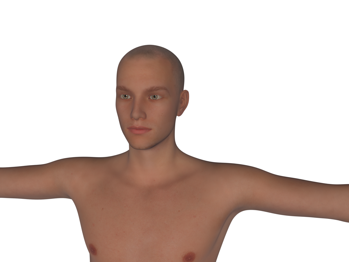

    Ok, had a look at G3M, the base figure. Sorry it seems to be eye moisture and not cornea, I don't use the G3 figures so forgive me. Anyway I converted eye moisture to dz default and applied the settings I suggested for the cornea:
    1200 x 900 - 436K

  • ChoppskiChoppski Posts: 627
    THanks. I did get it to work. I also created a materials preset so I can add it any m7 or m8 eyes.
    yes
