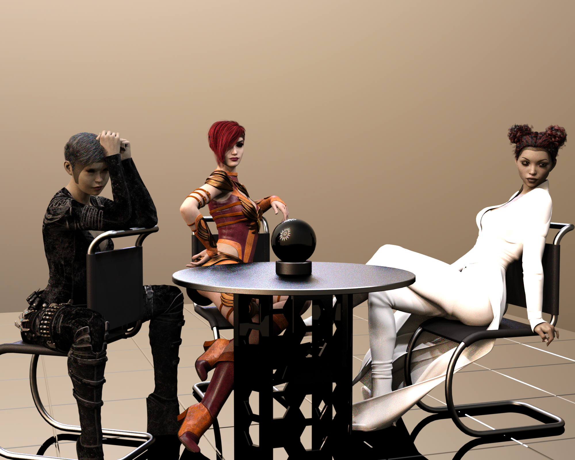

Does anybody else ever encounter a thing where in an Iray scene a hair cap is sharply visible, and (less often) the eyes are black and the skin textures are a bit off? I've had it happen occasionally and sort of fumbled my way through fixing it and always assumed it was the prop. Today I'm doing something with three characters in a scene and three different hairs I've used fine before, three different skins, three different eyes, all screwed up. And before I start trying to dig into _why_, I want to know if other people sometimes encounter this.

    Yeah. These aren't OOT hairs. I've tried scene-only and dome-only lighting and completely changed the HDRI a few times. At this point I'm wondering if my scene file is buggy.
    In case you were curious:
    As I said, I've normally worked around it, but having it show up on multiple characters at once, using props and characters I've previously used successfully has caused me to question my whole understanding of the problem.

  • exstarsisexstarsis Posts: 2,128
    As a comparison, I used Aisling and Danny Hair here without issues. Well.. you can't see her eyes very well, but the hairline is clean and as expected.

    Similar issue when character was too far from world center. https://www.daz3d.com/forums/discussion/68043/problem-with-hair#latest
    Oh my god, a very belated thank you SO MUCH. I was on the verge of tears of despair and now I'm tearing up through gratitude, having dug this thread up for a whole new different scene. Moving everything to 0,0 fixed it!
