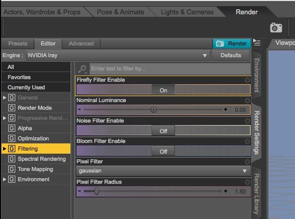

    First, Go to the Render Tab > Editor > and click on Default
    578 x 429 - 76K

  • L'AdairL'Adair Posts: 9,479
    heisdave said:
    hi,
    When i first started using Daz, when I rendered my characters it would take several minutes, and the rendered images were of great qulity.
    I  think a configuration or parameter got messed up somewhere along the way , now when I render characters, it seems to finish in a matter of seconds and the character's skin appear pixelated.
    Coule anyone venture a guess as to what's going wrong. Thanks
    It sound like you have somehow made changes to your Render Settings. As nemesis10 suggested, you can easily reset the defaults.
    However, you changed the settings in the first place, so it may be useful for you to know how you did that. For example, did you install the Render Throttle product? If so, it would be best if you went through the documentation and made sure you understand how it works. (I do not have it, so I can't be specific.) I understand there are presets for rendering low quality and high quality, to help with one's workflow.
    There are any number of products that change Render Settings. If you have an HDRI lighting product, double-clicking on a preset might change Progressing Rendering settings, too. (A personal pet peeve of mine!)  And if you're trying to use a specific HDRI for the scene, resetting to the defaults will remove that HDRI.
    The settings that are most likely to affect the length of time your scene renders are under the Progressive Rendering settings. The attached image is a screenshot I did for something else, but shows the parameters. The three which are most likely to stop a render short are Max Samples, default of 5000; and Max Time (secs), default of 7200; and Rendering Converged Ratio, default of 95%.
    If you set Rendering Quality Enable to Off, the Rendering Converged Ratio is no longer in play. You can then control the length of the render by either Max Time, or Max Samples, whichever is reached soonest. I personally set Max Time to 0 and effectively turn off the setting. (Doesn't work for other settings, though.) Then I control the render length by Max Samples alone.
    Anyway, good luck. I hope you find what made the changes, so you'll know when you have to check/redo the render settings in the future.
