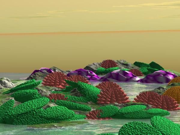

    Some extraterrestrial vegetation. :)
    Flowering Sea Plain
    Mars - 8000 years ago
    Modeler and terrain
    800 x 600 - 66K
    Post edited by Design Acrobat on

  • HeadwaxHeadwax Posts: 10,437
    Flowering Sea Plain
    Modeler and terrain
    heh, out of left field comes a Martian landscape :) love the colours.

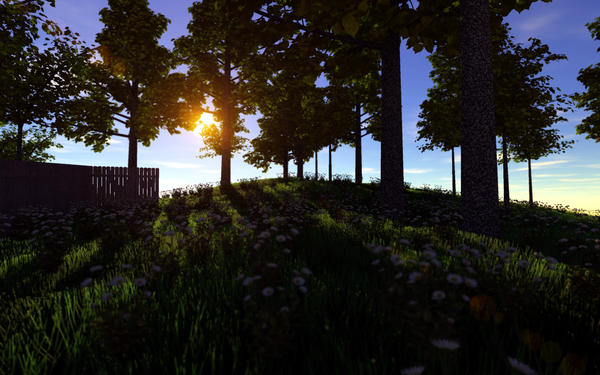

    Inspired by the challenge I decided to try and make passable grass using hair and this happened. An early WIP, everything except the grasshair not made by me. (tree presets and fence from DAZ, flower from RDNA)
    1440 x 900 - 563K
    Post edited by araneldon on
    wonderful render araneldon. Inspired me to try grass hair :)

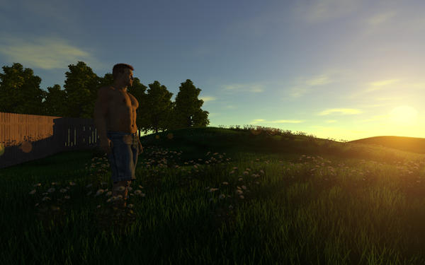

    Another WIP, still unhappy with grass and pointlessness. On the other hand, moobs.
    1200 x 750 - 241K

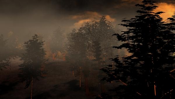

  • 0oseven0oseven Posts: 626
    Dont know if we are allowed more than one "entry" to the challenge but here is soemthing I came up with that was inspired by Carrara's unpredictable behaviour !
    I was making a tree and applied a spot to it for illumination - I happened to apply orange/ red which when rendered created a large "flare' about the tree with the appearance of fire - quite impressive actually. I then proceeded to try to turn it into a scene of sorts by adding terraine, more plants etc but experienced several weird things like the the open pane flipping vertically when I clicked on it ,rediculous render times and some other things that made me close the scene and start from scratch.
    Here is the result of my attempt at a Forest Fire. I couldn't recreate the flare I had before. Most of the effect is background photo (sunset from my back garden) volumetric cloud for smoke, and several distance lights for illumination on trees made in Carrara 8.5 latest. No post work.
    800 x 450 - 202K

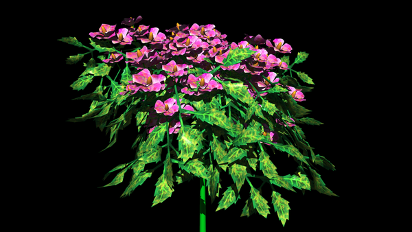

    the distribution of leaves in the plant room continues to puzzle me,
    video http://youtu.be/4oKDkqfNT5s
    my file https://www.box.com/s/5tdfx210fqm81snq92xo not that anyone looks at them!
    1920 x 1080 - 1M
    Great mood in this one, and there's a wonderful Maxfield Parrish feeling about the trees.
    So can I ask how are you getting the sunlight flare effect?
    (thanks for the hair offer - I think I should really grow my own :) )

    wow it's very impressive for no post work.
    if you get that flare effect to work again be sure to share the secret !!!!
    As far as how many entries, well to perfectly honest the quality of the work so far is amazing. I think there's no need to decide on what your entry will be until the final days - in other words just keep posting.
    I think it's probably a great idea to allow people two entries at the end.
    You can ask me anything :D It's simply the lens flare effect on the sun, sunlight preset IIRC, I just tweaked the settings a little bit.
    I figured you would want to roll your own, it's just easier to show than explain really :)
    - starting with the shape, make it very large, tweak scale to taste, and set tip width down to minimum in the shader
    - grassy colors obviously, and highlight dialed down (possibly shininess up, I didn't spend much time with this)
    - work out density (500k hairs per terrain in my images if memory serves)
    - use the hair shader to introduce variation in orientation and length (frizz, etc) using noise or maps to drive some parameters (eg big blotches of light and dark plugged to hair length to create patches of grass in different lengths)
    I'm still not quite happy with the way it looks but it's getting there. Also I plan to add plant meshes to the mix, the hair alone isn't sufficient.

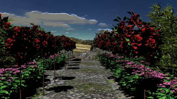

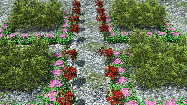

  • WendyLuvsCatzWendyLuvsCatz Posts: 40,315
    edited May 2013
    my garden so far
    Seriously do I HAVE to model ALL my plants!!!
    so many nice Lisa botanical s I COULD use as "leaves" too
    (my textures on ground too)
    1920 x 1080 - 3M
    1920 x 1080 - 5M

    my garden so far
    Wendy, take it from me, you have some seriously good looking bushes there. :) It's worth all the blood and sweat getting those!

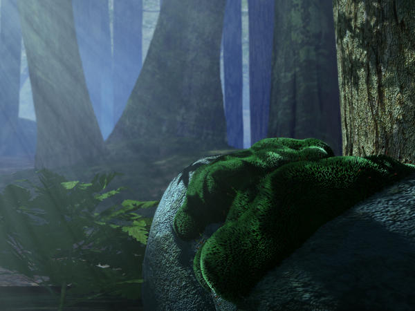

    head wax said:
    How about something from the meta ball room? Just bang a few balls together.
    I'm sure they would do some great cacti with a hair primitive attached :) Or there's the famous Flat Topped Victorian Ball Tree , especially bred to grow under power lines and not need trimming...
    It's no tree and this is something I've posted before. It's a meta-ball blob with hair. It's supposed to be something akin to carpet moss. I made the meta-ball object, added a procedural shader for color on the ball object and copied that to the hair's color shader. I also added a spline model to a replicator to simulate the reproductive bits of the moss and used a shader with a mixer, with the sources being a green color and a red color and an elevation function driving the mixer.
    The light beams are a spotlight with a gel and a light cone which were composited in Photoshop.
    2000 x 1500 - 985K
