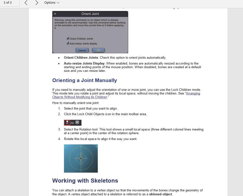

    Solved
    OK, fell victim to RTFM.  blush
    Don't use the CAPSLOCK such as changing hot points.
    Instead, turn on the Lock Child tool in the top menu in the Assemble room.  This will fix the parent and children bones/joints in place.  Then, select the joint of the bone that you want to align.  Select the rotation tool.  Rotate the joint as desired.  Unclick the Lock Child icon.
