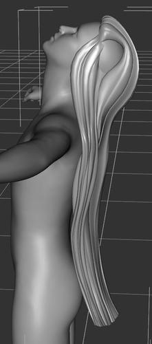

    It depends on how the hair is set up - some hair is a single item and uses morphs to shape it, some hair is a conforming figure which will follow the pose of the wearer the way clothing does (even if you don't want it to) and some is a figure with its own special bones for posing. The Catgirl hair is of the latter type - it has a Hair neck bone attached to the head and then a Hair Length bone attached to that, you should use those to adjust the way the hair hangs. In the image I bent both bones back, and used the LeftSideback morph to pull the hair out of the shoulder.
    410 x 928 - 44K
