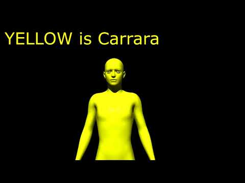

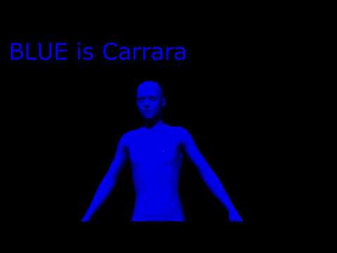

    The problem isn't the frame rate or anything else... Everything is perfect: Position, timing, orientation, keyframes... The only issue is the interpolation between the keys (my timeline look crowded, it is a perfect copy of the original from DAZ).
    Here's a video with what I mean:
    As you can see, the Bezier is the nearest to the TBC but it doesn't behave like it, the difference is too big...
    I need a more precise tweener, and since I can't add Bezier to DAZ but I can add TBC to Carrara, I'm looking for the right formula to insert!

    When I look at your video, personally, I think that the tweeners of Carrara are more natural than those of DS.
    If you want to find exactly the same thing in Carrara, you could try to place your video of DS animation in the background of the scene and tweek the tweener off your character in Carrara to match the background.
    If Bezier is too difficult, you can use the Linear one and modify the in and the out.
