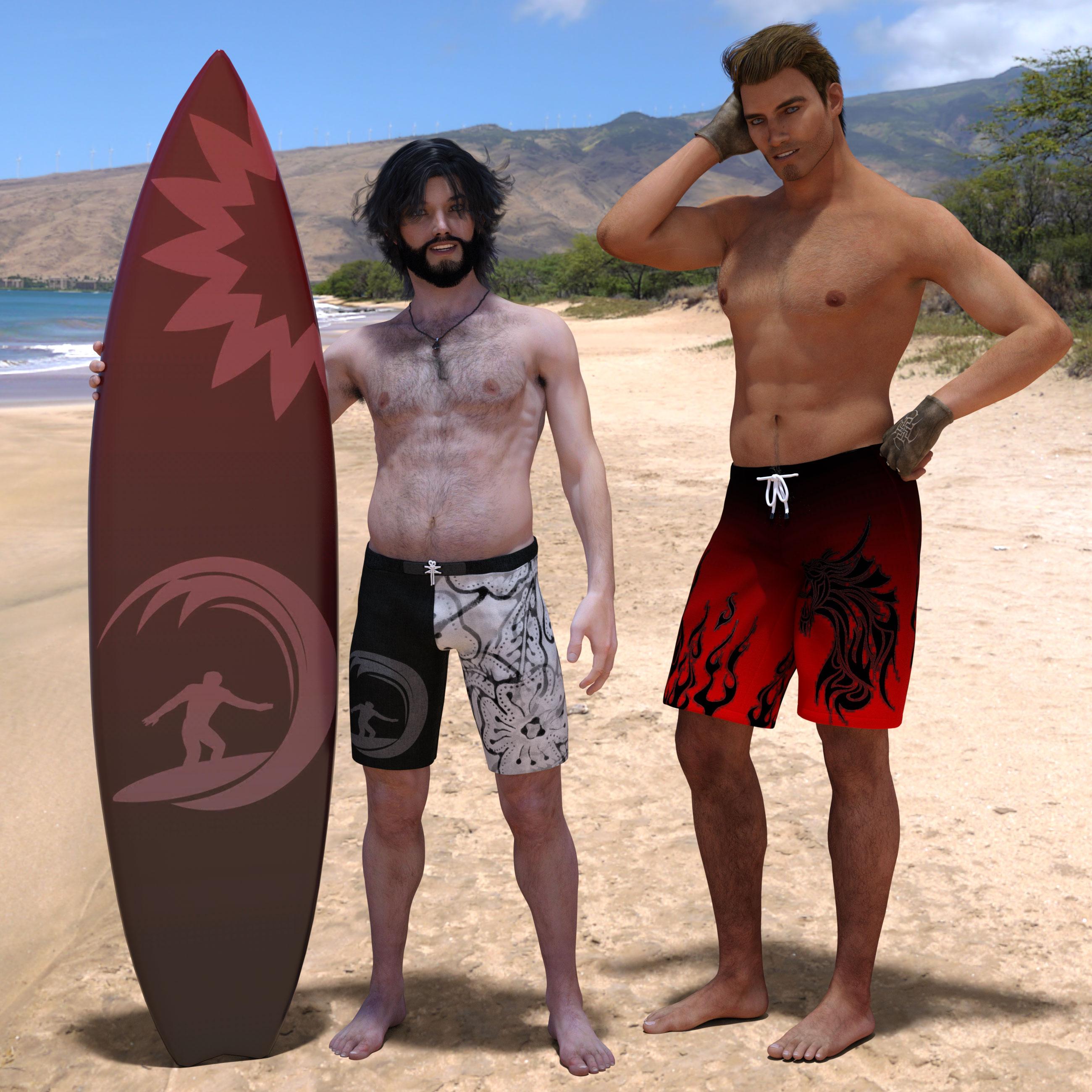

These two are Genesis 2 characters (the same "leads" in both pictures), which I converted to Iray by using the conversion with the skin manager as base. Because I changed some settings, I had to desaturate the diffuse map... and more. It is a learning curve, but a worthwhile one.

<<These two are Genesis 2 characters (the same "leads" in both pictures), which I converted to Iray by using the conversion with the skin manager as base. Because I changed some settings, I had to desaturate the diffuse map... and more. It is a learning curve, but a worthwhile one.>>
YAY pictures. So the Tall guy in shorts who looks photorealistic is the exact same guy who is sitting at th table looking more doll like, right? And this is because you converted his skin using the tool above?

--The guys - yes, tall guy is the same as the sitting guy. The texture I used was exactly the same on both, and the difference between the two is just a small change in the Iray settings, and I used a slightly differently desaturated version of the original skin map. Explaining thew entire process takes rather long, though. They easiest way would for you to load the Iray skin you have, select one of the surfaces, experiment. Here's some "basic reading" that might give you a few insights: https://www.daz3d.com/forums/discussion/56788/iray-start-here#latest

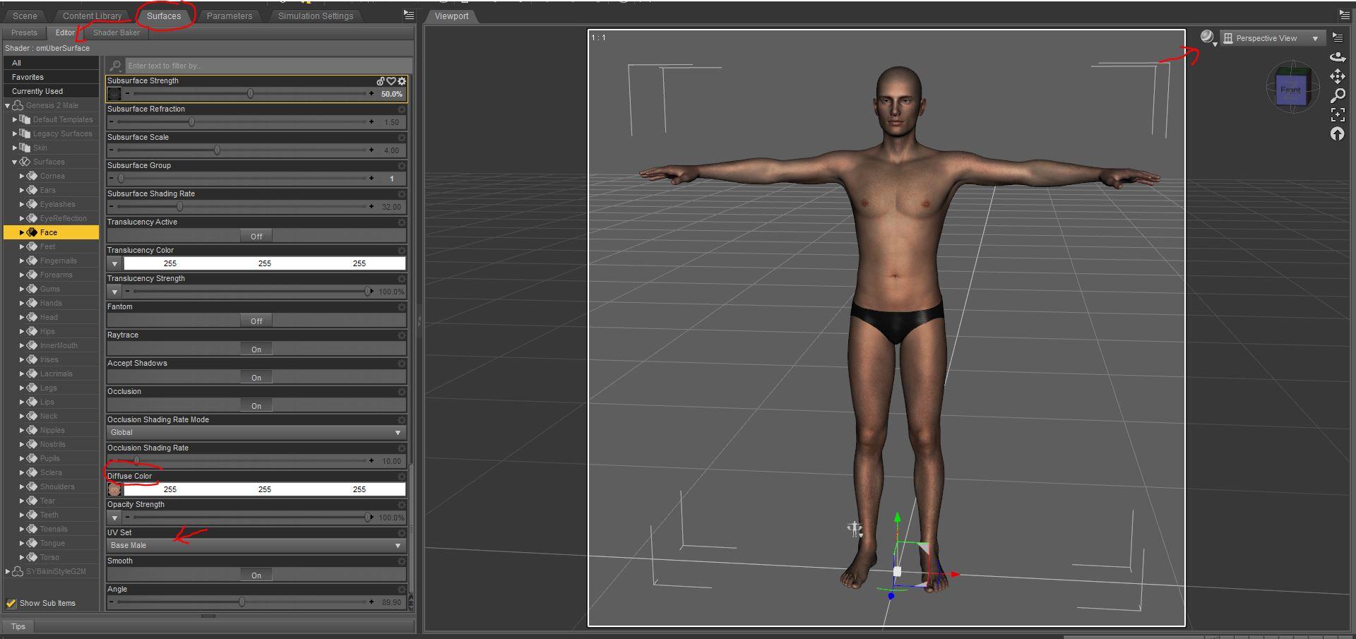

Here's a quick example for the skin: I have loaded base G2M, selected him in the scene tab, opened the surface tab, and selected there the face surface so you can see part of the settings. The shader is 3Delight by default. At the bottom, you see a setting called "Diffuse colour". This is where the map that you see on the surface is plugged in. This map is called "Diffuse map". Also important is the UV set, which is telling the program how to put together the flat maps when it wraps it around the 3D figure. Here, the UV map is Base Male; there are various sets that allow you to use other generation skins on your figure (like, M4 or Genesis). The only break is towards G3/G8, because they changed the UV layout considerably, and so the UV maps do no longer have a bse compatibility.

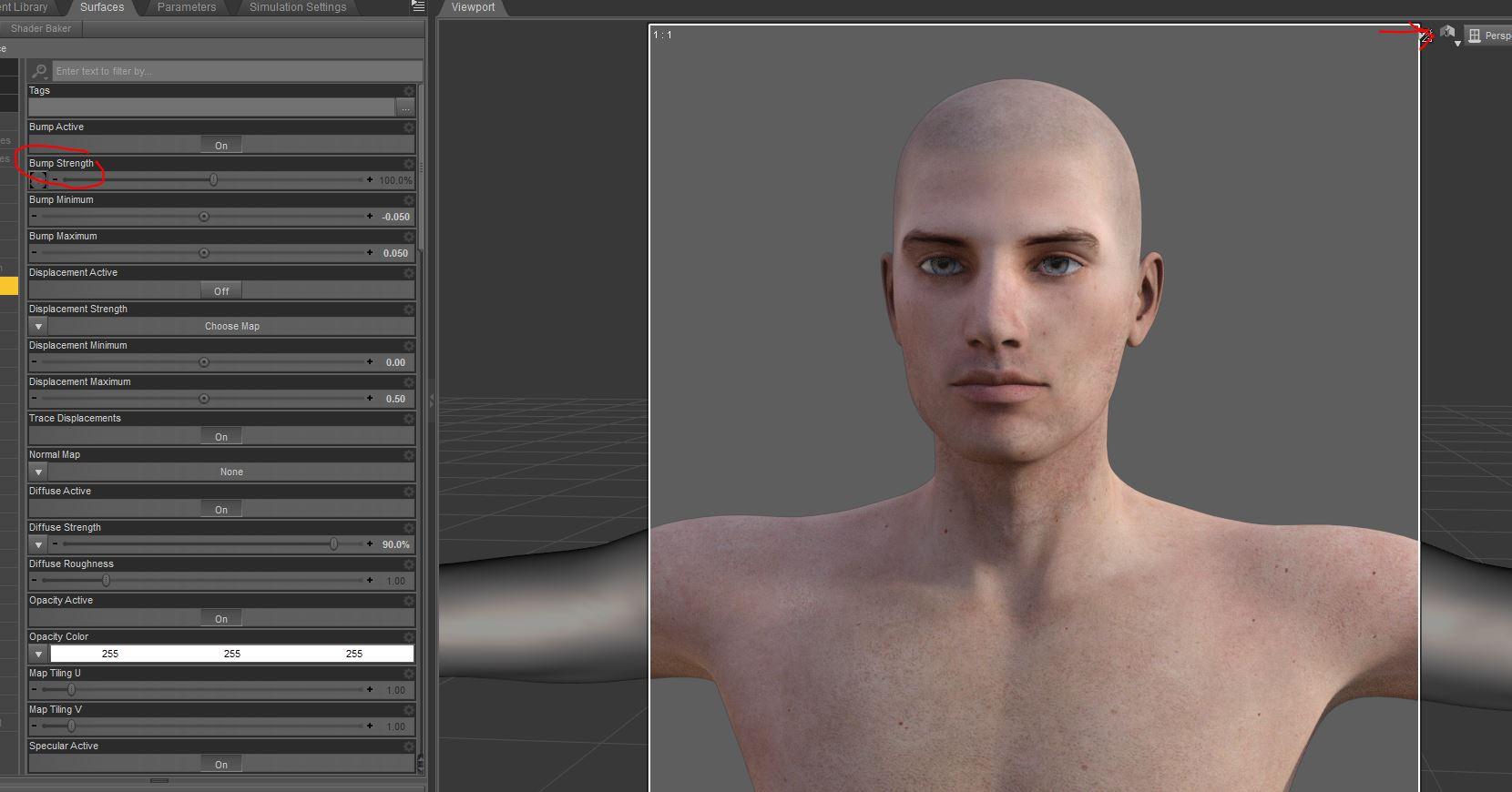

I've now started the Iray preview render on the 3Delight materials, and you see that they render pretty decent. It's not very photorealistic because of the settings, but you it's a start. I've circled a second map for you; this is the aforementioned bump map.

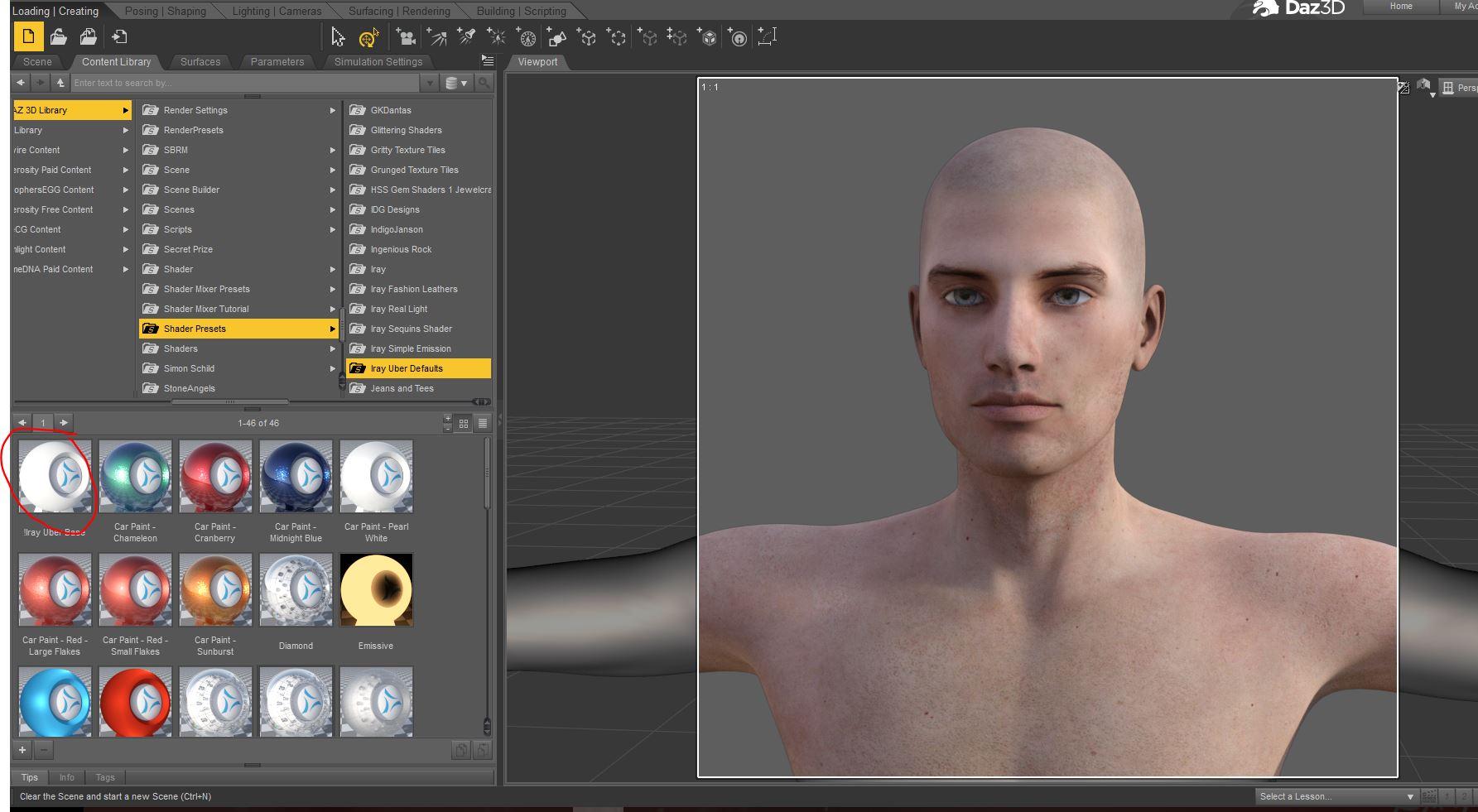

Here, you can find the Iray Uber base shader shader. Applying it helps shortening preparation times, as the render engine doesn't have to slog through the conversions.

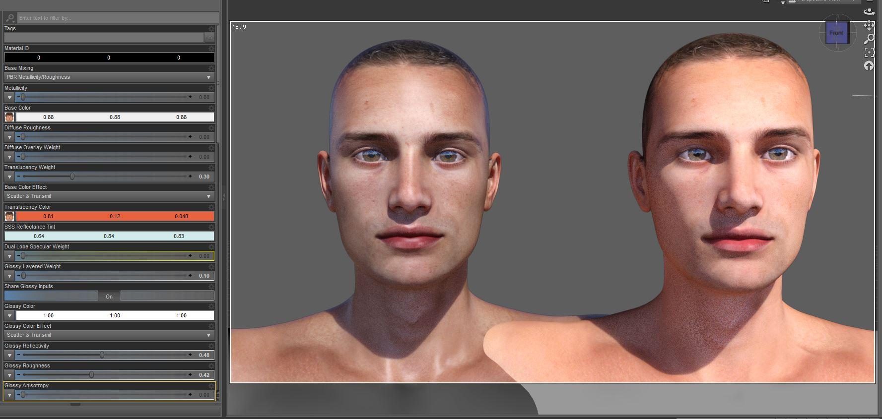

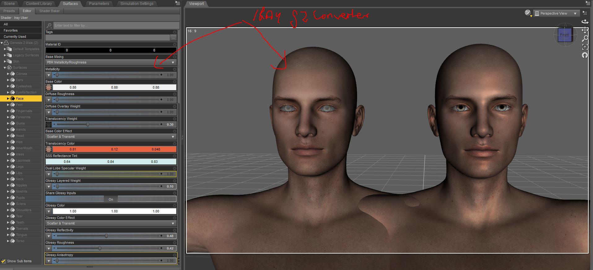

After applying it, the surface tabs now shows different settings. Our Diffise Colour is now called Base colour, and the other maps have been mostly plugged into their correct slots. For comparision, I have loaded a secong G2M, who has the 3Delight settings.

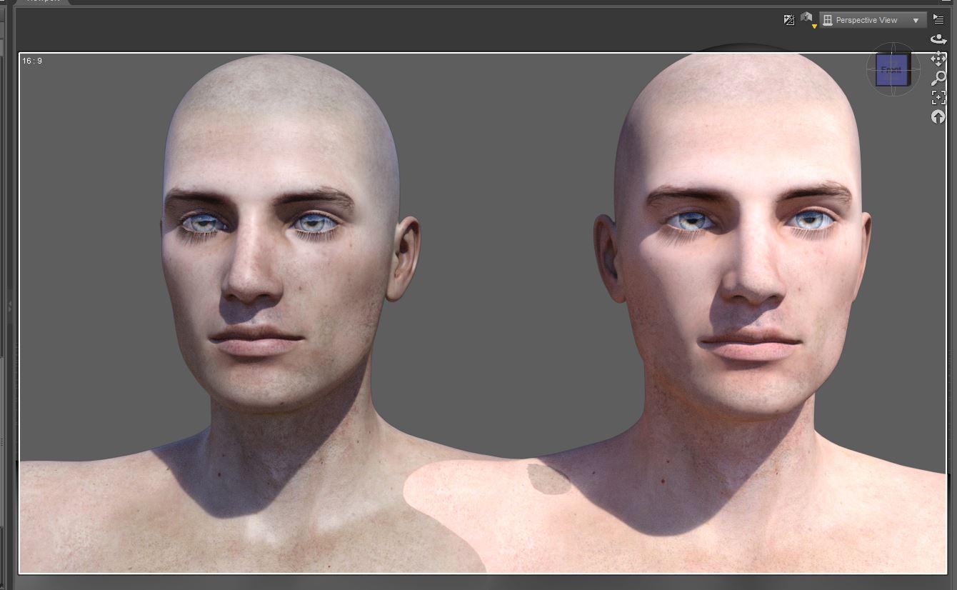

To show how the Skin converter changes the settings, I have applied the skin conversion to the one character, while the other has the base Iray shader conversion.
You already see the difference in the non-rendered preview window, but the difference becomes more obvious when you start the render:
The difference becomes even more pronounced with better quality skins, like the one of Michael 6:
