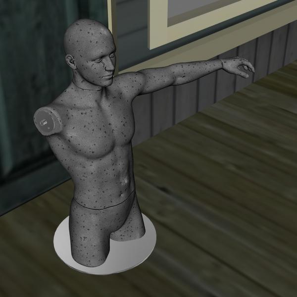

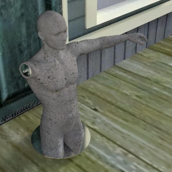

  • MarcCCTxMarcCCTx Posts: 943
    edited October 2017
    Yes, but you'll want to update materials for iRay.
    3Dellight
    iRay 300iterations
    600 x 600 - 155K
    600 x 600 - 267K
