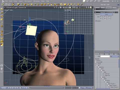

    This my composition inspired by Cripman's tutorial about 3 Point Lighting and also is an allusion to one Frank Frazetta's work.
    1200 x 1543 - 672K
    Very nice.
