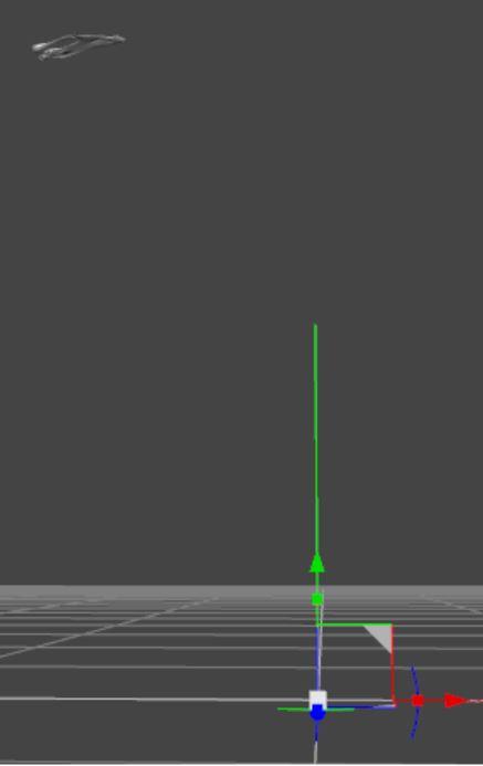

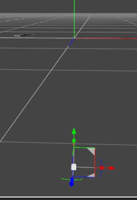

    Here's a clip of what is happening. I want to get the object (upper left) to align with it's base down on the floor.
    The answer is not using "drop to floor" because that ends up placing the positioning tool underground.
    I'm betting this is a simple solution that is buried in a drop down somewhere I just can't find it o_O

  • hphoenixhphoenix Posts: 1,335
    @Brugan - I think you have to use the Joint editor, to move the object origin to a point in the object, rather than the base of a figure it would normally be attached to.
  • BruganBrugan Posts: 365
    Thanks I'll give that a try tonight :)
    Awesome, that did it! Took me a few mins to figure out that I had to drag the arrows to the object instead of trying to drag the object to the arrows but it worked like a charm thanks!
