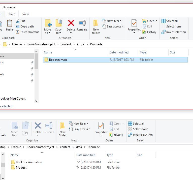

    Coming soon but need some file structure confirmation.
    I modeled a book with covers and pages that can be turned.  I rigged a version in Studio and saved as a DUF file.  However, I have never shared a DUF file and I am not sure which files need to be included.  I've never tried to create and share something in the data file structure instead of the runtime file structure.  If I just ZIP a folder that contains the content \ data and content \ Props folders, is that sufficient?  The book's DUF file is in a subfolder of the content \ Props folder.  Or, do I need to include my working files?  It loads and can be animated in Carrara.

    I've been reading about this... believe you have too.  Did you grab MDO's files here?  Earlier in that same thread take a peek at TangoAlpha's setup for both DS and Carrara content.
    I know you have textures... where are they located... be sure to grab that folder. Another way to find out what a .zip should contain would be to just look at a ShareCG file with a .duf or one purchased elsewhere.  Be sure that it is one that installs correctly of course.
    Wish I could say more but that's all I know... never zipped anything to auto install into a library.
  • wgdjohnwgdjohn Posts: 2,634
    Diomede,  Just thought of another way to find out.  Simply zip as you believe will work then send to anyone you trust to test so they can let you know what problems there are... if any.

    Can someone test this freebie?  It is in the Daz Studio file structure.  I hope that you can simply copy the "content" folder to your own content folder.  It should create a Diomede folder in your Studio props library.  The book will be there.  The file is large because of all of the textures needed for the covers, pages, etc.  The uvmaps for the covers are square.  Just load your own image for the cover and for the pages.  The uvmap template for the spine is included in the materials folder.
    NOTE - the book rigging has an inconvenient flaw.  The base bone is anchored at zero, zero, zero.  Not sure why and I can fix in an update, but thought people might like the book figure anyway.

  • PhilWPhilW Posts: 5,162
    Just downloaded and it all seems to work fine for me - great work!
  • DiomedeDiomede Posts: 15,398
    Thanks, Phil.  Any insight on how to fix the "root" bone being set at zero, zero, zero?  Can I fix that with a morph in an update?
    Activate the Joint Editor Tool and move the root bone up to where you want it, choose one of the other tools (eg. rotate) to come out. Resave. Job done.
