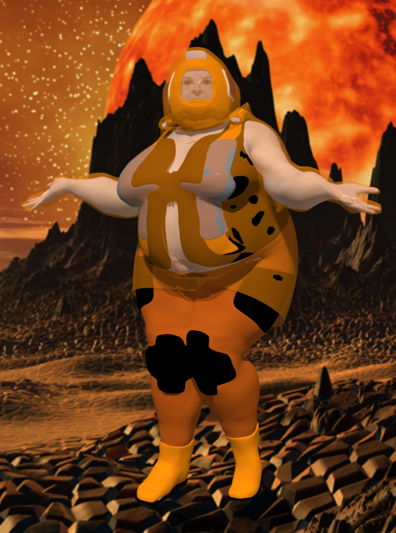

  • Bunyip02Bunyip02 Posts: 9,226
    edited July 2017
    Aiko 6 with George morph. Pokeaway 2 used to fix poke through on the arms, still some on the hands.
    800 x 1076 - 902K
    Post edited by Bunyip02 on
  • 3DAGE3DAGE Posts: 3,311
    Thanks for the feedback,. I don't have the George figure,. i've bought very few characters since genesis,.
    I'm not seeing any poke through on the base G2 female T pose,. maybe it's a carrara autofit issue,. maybe it's the mesh density,. (it's quite low right now)
    I'll mess around with some different vesions, and test more with alternative body shapes.
    thanks again :)

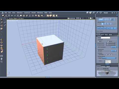

    I messed around with a simple cube to test with. I set up with texture domains first, UnWrapped it, Exported and painted diff colors on all sides.  Strange thing is there are white curved hightlight/looking lines on sides... apparantly I've done something wrong... they also appear in a black scene with only the camera and one light.  I would'nt think that it would have anything to do with mapping method but as always I can be wrong.
    Is there an easy way to scale all selections at the same time... or do I need to scale one at a time.  I did scale these all at once but I could't go larger without one or more getting out of size... seemed to want to wrap back upon itself.  I found it easier to start out with snapToGrid on then turn it off and line up closer with move tool for any that did not snap nicely, in correct position.

    In the UV mapper,. there's a set of "layout" options .
    In the situation where you wanted to have a more detailed texture on one face of this cube,.
    you'd set one face to a new domain,.  then you can simply scale that face to the full extent of the UV area.
    you'd have a shading domain which covers 5 faces,. and another shading domain which covers the remaining face.
    The single face domain will have a larger possible texture area than each of the other five faces. (with the same size of texture map) since it's using more of the available uv space.
    In the "Operations" tab of the UV mapper,. you can select this single face domain,. and use "fit to UV's" to maximize the uv grid.
    In the "Display" area of the UV mapper,. you can either "view all" shading domain layouts,..or a single shading domain layout.
    Sometimes you'll want to expand the edges of your texture colour (with a "same colour" border) to accommodate edge bleed,. but your example cube has strange diagonal corner bit's :) which don't appear to be that,.
    not sure what's causing that :(
