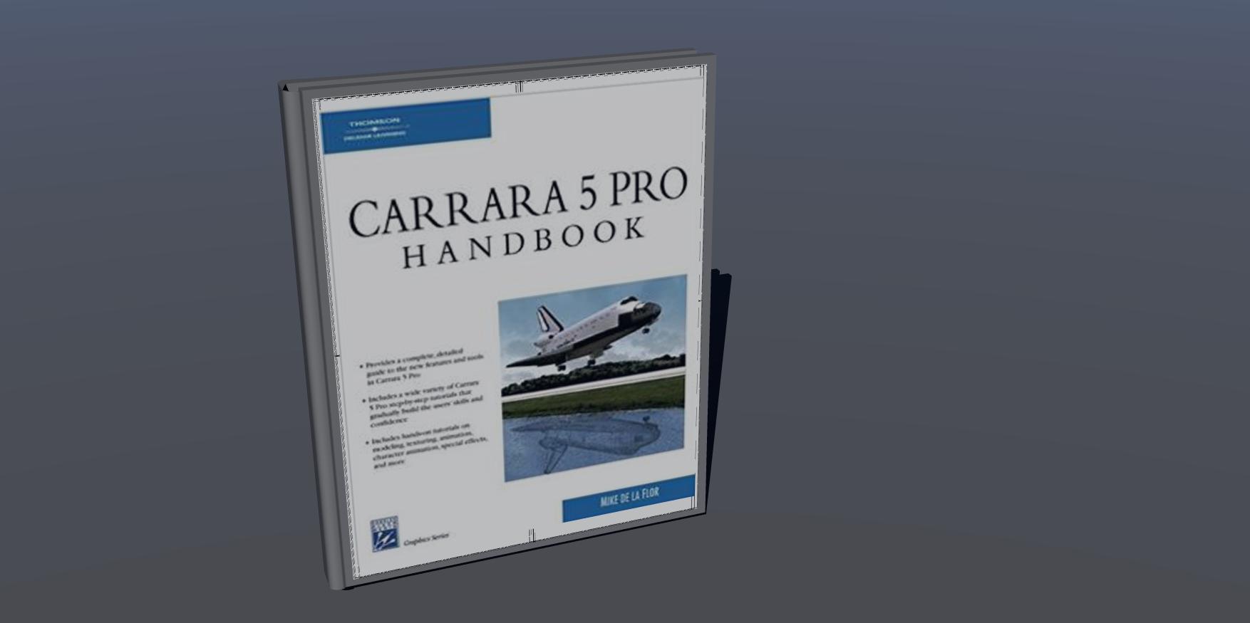

    Posting a simple model.  Here is a book/Magazine figure.  It is a rather hi poly mesh for a book because I want to have the covers to be capable of posing similar to a magazine and I want the pages bending in the middle or near the spine or both at the same time, but in opposite directions.  I rigged it in Poser just because I hadn't rigged anything there in a while and the result still works in Carrara.  The pages and covers overlap 100% on the uvmap, but can load different images on each.
    As always, suggestions welcome.

  • wgdjohnwgdjohn Posts: 2,634
    Nice job.

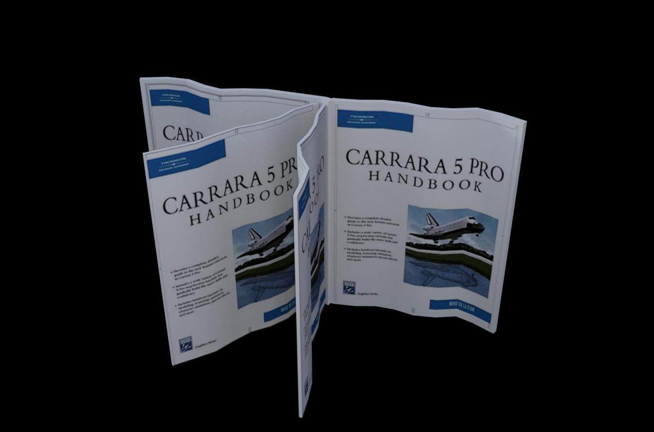

    I've been testing my book/magazine model in other software.  Recall, I modeled in Carrara then rigged it as a Poser CR2 saved to a runtime\character folder.  It loads natively in Carrara from the browser tray.  It also loads natively from the content library in Studio as a Poser format file.  Here are a couple of Studio renders.  The first shows how the magazine can have all of its covers and pages bend in opposite directions (wavy).  The second shows the book closed.
    And here is a Bryce render of the book/magazine closed.  The Bryce render is of high enough quality that you can see the uvmap template peeking around the edges of the pic of the Carrara 5 Pro Handbook image that I threw on there.  Good for Bryce.  yes

    My book/magazine model is rigged so that it can be open/closed or pages bent in an animation.  I saw that Maclean (whose products I love) recently released a product of a book collection.    Does anyone know if the list of books on the product page as DUFs are only separate static objects?  Or, can they be posed to open/close?  Morphs of a single object? Pose files?  A problem with using morphs can be getting a rotation for a page rather than a squishing. I checked the first couple pages of the commercial product forum but did not see a thread.

  • DiomedeDiomede Posts: 15,388
    Thanks for the comments, wgdjohn.  I have started a new version of the animatable book in my "no asked me" thread.  This next version will be rigged in Studio and saved to DUF.  Two things in this version should help make it more smooth.  The new version has a more dense mesh so there can be more bones per page (now up to 10), and I will remember to enable subD during the figure setup mode.  The pages turn through rigging, not through morphs.  But, morhs can be added to make the pages seem less rigid.  When I finish and get it cleaned up, I will post the mesh with a few notes here.
  • PhilWPhilW Posts: 5,160
    Bones is defeinitely the way to go for page turns, morphs would look very odd - a morph will simply define a start and end point for each point in the mesh, so if you had a morph that turns a page from flat on the right to flat on the left, when you used the morph the page would shrink to the middle and then expand on the other side, rather than performing a semi circle arc that you actually want! Bones will do it properly. I would use 2-3 bones per page so that the page can bend as it turns.
    Agree 100%, Phil.  The Poser CR2 version that is pictured above has 5 bones per page.  The Studio DUF version that I am working on right now has 10 bones per page.  I think it is sort of like modeling a garden hose or string in that ideally it should be able to bend at any point, and in different directions in different places.

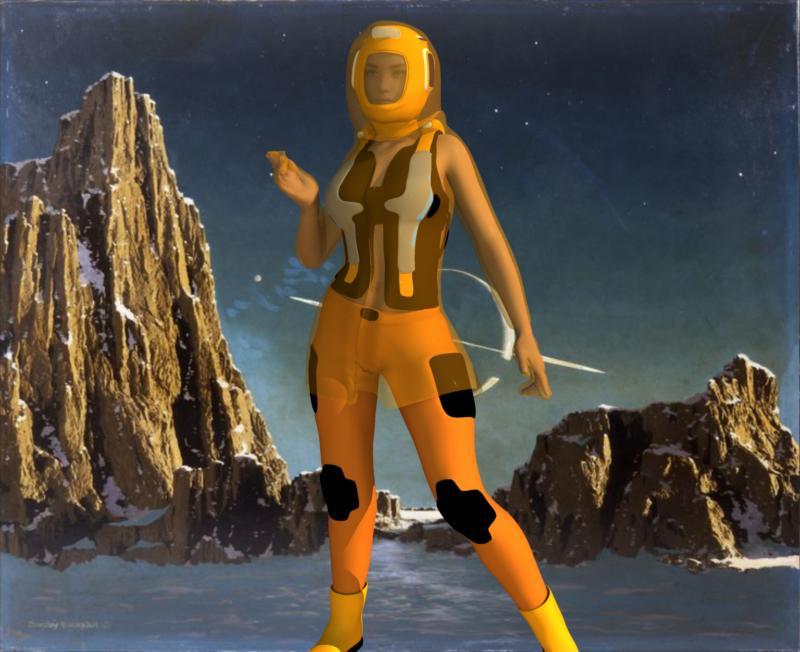

  • 3DAGE3DAGE Posts: 3,311
    test of concept : can we share our own rigged "content" in a car file.
    https://www.dropbox.com/s/q3ad9gv3hn9l2du/Sci-Fi_Suit for G2.zip?dl=0
    Could someone please try loading these onto Genesis 2 in Carrara
    They're basically modelled and rigged conforming clothes (made in Carrara,. rigged in DS (transfer utility) ,. then saved as Carrara objects
    I just want to see if there's any errors,. or missing things,. hopefully not.
    there's no texture maps,. just simple shaders,. although most of it should be UV mapped enough for texturing.
    thanks :)
    edited June 2017
    3DAGE - no problem - the files downloaded, installed, and worked in Carrara.  yes
    Here is a quick test render with a background that I found on the web and have no rights to.  No errors.  I assume no missing things, but of course I don't know everything that should be there.  Excellent content, as always.
    800 x 652 - 63K
    Post edited by Diomede on
    Thank you Diomede :)
    good to know we can create conforming content using the transfer utility in DS ,. then load into carrara and save as .car files
    now i just need to make better outfits :)
