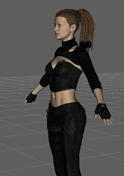

    I've done limited clothing trials but haven't been having trouble except wth high heels. Here's a screen cap of Aeron for G2F on V8. Also includes a G2F hair. I just used the full outfit selection then followed autiofit for each item (holsters, knives, guns, top and so forth). In all cases I used the "full Body" option. You can see that everthing fit perfectly, including gloves. The high heel boots of course didn't fit.

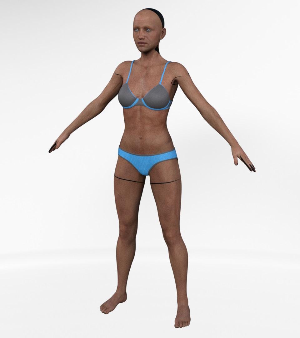

    Dragonsbane G3M material on Genesis 8 Female.
    https://www.daz3d.com/dragonsbane-barbarian-character-hd-for-genesis-3-male
    Could not find, how to switch UV maps - probably it is not there yet, only Basic Female is listed.

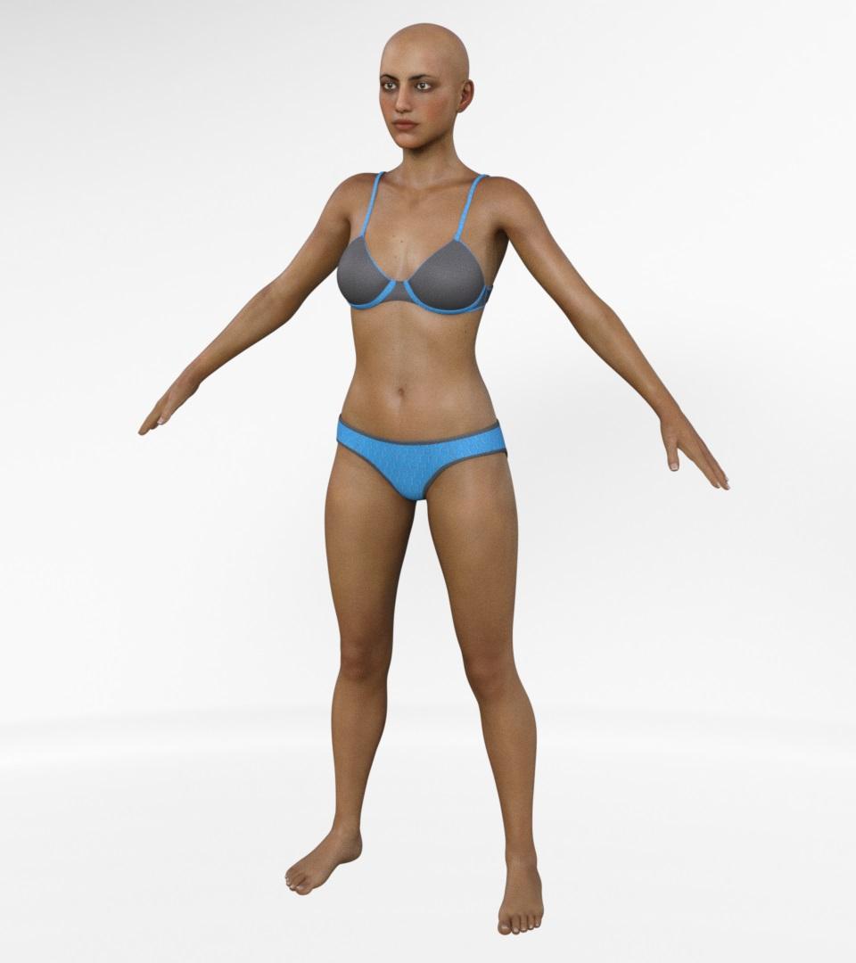

    Draupadi G3F material on Genesis 8 Female.
    https://www.daz3d.com/draupadi-for-genesis-3-female-s

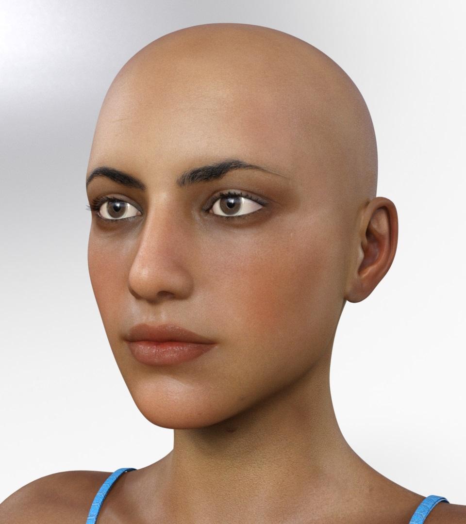

    Sienna hair for G3F - https://www.daz3d.com/sienna-hair-for-genesis-3-female-s-and-genesis-2-female-s
    on Genesis 8 Female with Draupadi G3F material, Genesis 8 eyes material.
