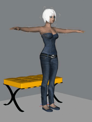

    been working on it a bit today

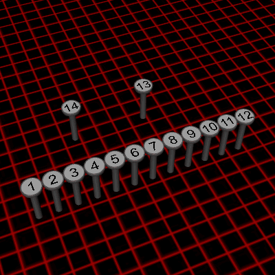

    i linked the buttons of the gamepad (logitech dual action rumble) to the YTranslate of the button objects
    the 2 analog joysticks ( 4 potentiometers) were linked to the XTranslate and ZTranslate coordinates of 2 button objects
    here's the content of the links table
    link joy.btn.1.val button_1 Y Translate -50 0
    link joy.btn.10.val button_10 Y Translate -50 0
    link joy.btn.11.val button_11 Y Translate -50 0
    link joy.btn.12.val button_12 Y Translate -50 0
    link joy.btn.2.val button_2 Y Translate -50 0
    link joy.btn.3.val button_3 Y Translate -50 0
    link joy.btn.4.val button_4 Y Translate -50 0
    link joy.btn.5.val button_5 Y Translate -50 0
    link joy.btn.6.val button_6 Y Translate -50 0
    link joy.btn.7.val button_7 Y Translate -50 0
    link joy.btn.8.val button_8 Y Translate -50 0
    link joy.btn.9.val button_9 Y Translate -50 0
    link joy.or.1 button_13 Z Translate 1 -178
    link joy.or.2 button_13 X Translate 1 306
    link joy.or.3 button_14 Z Translate 1 -178
    link joy.or.4 button_14 X Translate 1 128
    400 x 400 - 136K

    my gamepad was so clean and shiny
    here's all the math needed to write a renderer
    580 x 800 - 102K
