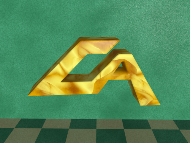

    The CarrarArtist Logo - Yet a new concept design:     This is the smoothing design.  Before I added a few extra polylines to tighten it up it was first checked with smoothing... lo and behold the the bottom inside of the A is now curved giving it a bit of an artistic look, IMO.   And yet I still have a bit of touch up here and there... the non-curved version is only a few steps away... both it and this one have a bit of touch up to do... couldn't resist showing this new look which caught me by surprise.
    Other changes made were giving the C a lot more tilt that I thought it lacked enough of.  Hugh thanks to TangoAlpha for the input and confirming this.  Another change was to widen the bottom of the A to add a small touch of flair at it's base.  Then onto the shader settings for Enhance C: Fractal/X Flame by DCG to which I made quite a few changes... I wanted a light and dark goldish mix as well as some blending.
    I also thank Misty for planting the idea of the suggesting the logo by suggesting "CarrarArtist".  I''m still hoping to get time to make one in Typtool3 as a font that can be loaded into Carrara or any program as well as chars for "CarrarArtist" so Folks can use them for their Artwork anywhere including Carrara Challenges.
    Fun Fact:  Crazy John saved more than 8 versions of the this design of the template for the logo... gotta always be able to back up and make changes.
    Tip:  A simple mistake I made in the original, the template, was overlooking 2 vertices that needed to be welded.  I found out where it was made when adding smoothing to the object... this created an N-Gon.  Always be sure to view objects from all sides... rotating to check them all.
    Critique and suggestions are always welcome.
    640 x 480 - 403K
    1366 x 768 - 281K
    1366 x 768 - 281K

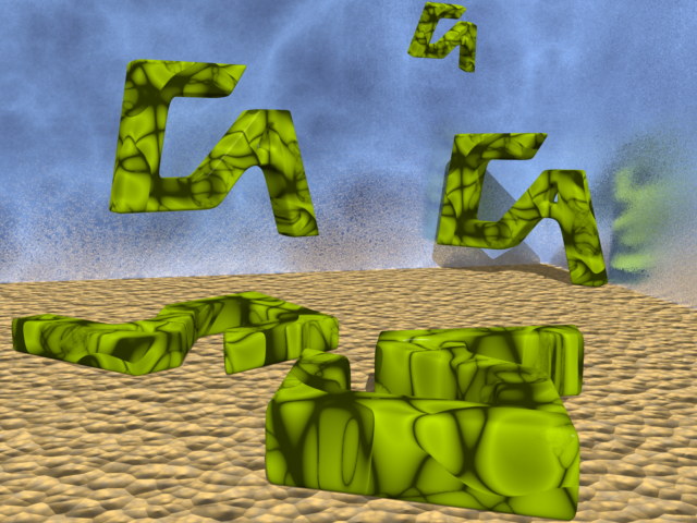

    The CarrarArtist Logo - Final concept design:  Now I have 2 verstions... one for using smoothing and yet another with NONE...  latter I call the hard version.  Note that the same shader is used for both versions and looks quite different on each.
    Modifications:
    • Both versions show an even larger r/h base of the letter A.
    • Now have 3 shader domains, frt faces, back faces and side faces... I'll be adding 1 more for the inside of the A top opening of each version.
    • Hard version has 4 extra polylines to stiffen up the geometry... not used for the smooth version.
    • ToDo Yet... design a shader with those which come with Carrara for a similar look... so that anyone can use either of them.  Oh gosh... still need to UnWrap this... the funs not over yet. :)
    [edit - update  5-23-17]
    1. Added 4th shader domain for inside of A top opening.
    2. Shader created with Carrara standard shader settings. Still want to tweek a bit for better look.
                                            Images below are smaller than actual renders... click to open in new tab.
    640 x 480 - 422K
    640 x 480 - 320K
