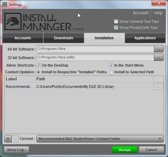

    First, everything I've read states you need to use DIM to install the beta. Looking at the DIM settings for "Installation," I do not see an alternate install path for the beta, only one path for 64-bit software and another for 32-bit.
    DIM Installation Settings screenshot

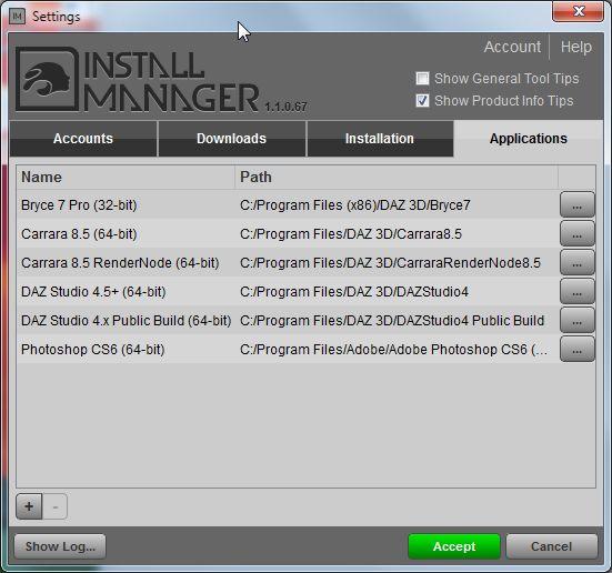

    Looking at the DIM settings for "Applications," I do see the paths for all my installed applications, including the two separate paths for the released version and the beta. It may be possible to change the path for the beta in this setting window, putting it on your external drive. You could test it out, if you're willing to put in the time and possible frustration. And it may still not work.
    DIM Applications Settings screenshot
    551 x 516 - 42K
    551 x 516 - 48K
